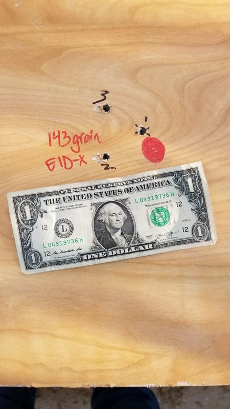

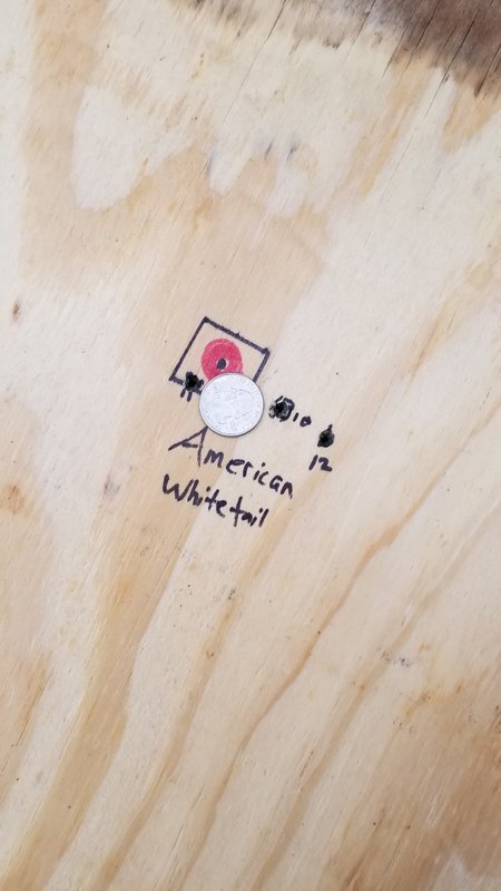

    Hey all,
    I finally had some free time and headed out to the ranch. I have a RugerAmerican Predator that I bought back in Feb but finally shot it for the first time. After sighting in, I decided to do two three shot groups. I used factory Hornady American hunter to sight in. My first three round group was about 2 minutes. I then used ELD-X and shot a 3 round group. It was much tighter but still over a minute. I do not have a range finder and I know I had the board out past 100. I want to say I was shooting at about 120 yards. Rifle is chambered in 6.5 creedmoor and scope is weaver tactical 3-15x50 with rings tightened to 16 inch pounds. Is there such a thing as breaking a barrel in and mine still needs more rounds down the Barrel? I think I shot about 16 rounds today and that's all it has. Any info appreciated.
    I placed a quarter on the board just for size reference.
    I knew I was going to have some days off from work so I prepared myself in advance. I messaged Ruger in regards to how much torque is required on the screws that hold the stock to the action. Ruger told me to tighten from 60 to 80 inch pounds and to do both screws little by little versus doing one screw and then doing the other one. That's exactly what I did. Barrel is completely free floated. I suppose I could try match ammo to see how it'll perform with that. I tried those two particular rounds because I will be using it to hunt and thought I would start there.

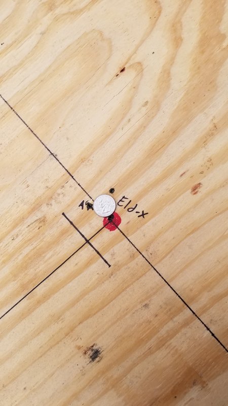

    I've taken the information posted by all of you and decided to try it once more. This time, I paid close attention to my cheek weld and tried keeping it as constant as possible. I also decided to go prone and shoot laying on my stomach off a bipod. On the rear, I was almost at my target. I simply placed a glove under it and it seemed to be perfect. I fired three rounds and took my time on all 3. I did this using ELD-X and my group is actually the same. I did this with a cold bore today expecting to maybe see some minor improvement. I didn't have a quarter to use as size reference but I did have a dollar. I'll attach the picture. I might do a copper cleaning as suggested as well as try with different factory ammo. As far as the stock, I actually have plans already to buy a laminate stock from stockys or a Magpul Hunter.

    That's what I'm thinking. Try out a few other brands. Plus, with group sizes as the ones I got, I could still make an ethical shot on deer or hogs which will get the lungs if not the heart. But yes, Winchester is definitely a brand I've been curious on trying, and I'll probably look at what else is out there.
