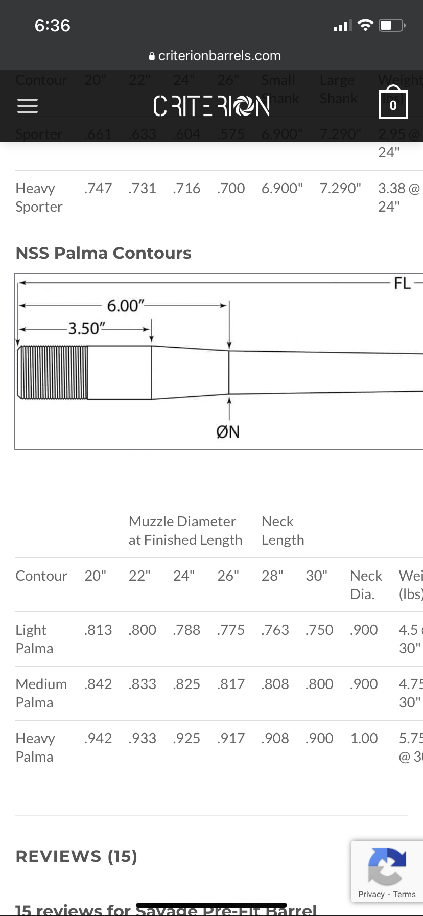

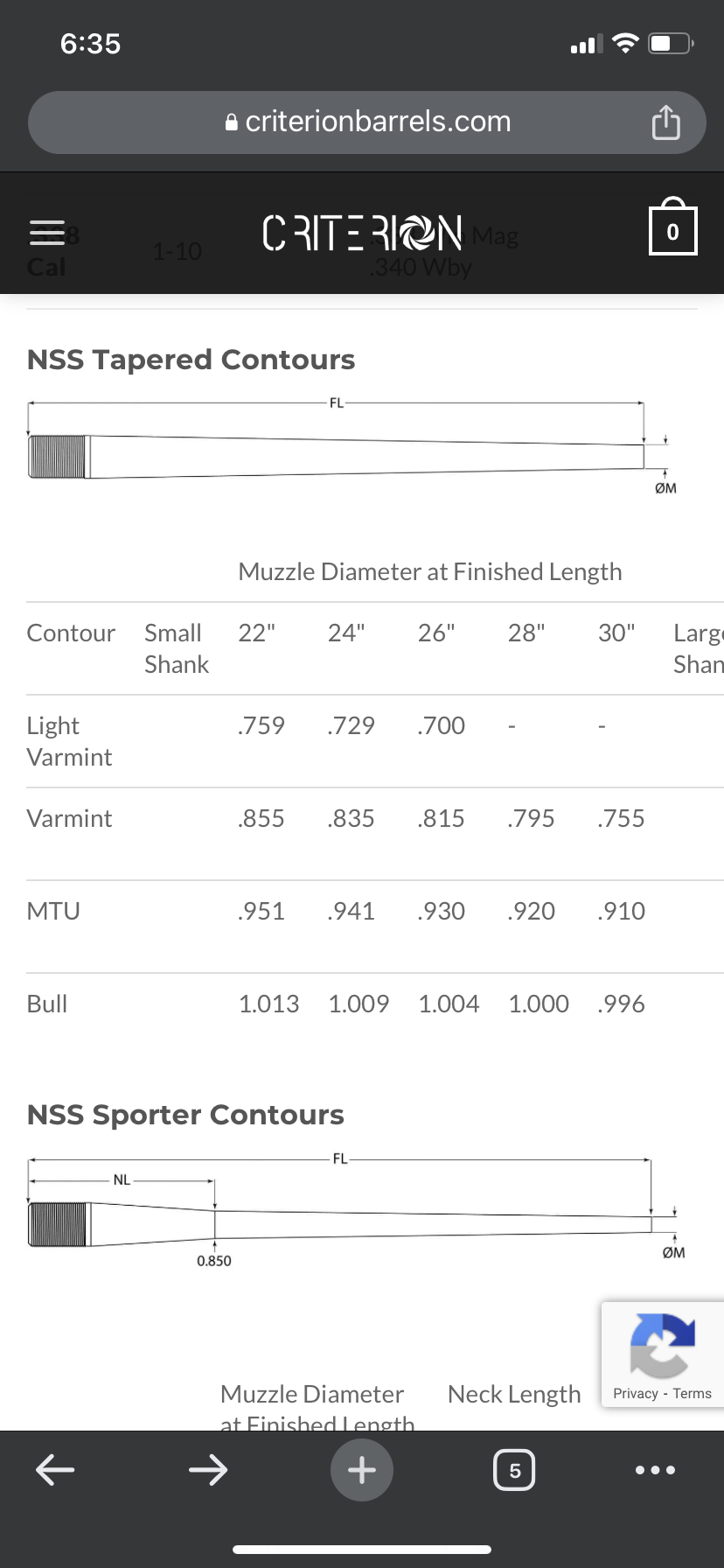

I dont know which maker you're looking at but Bull mostly is just a colloquial term for a heavy barrel. The rem varmint and the palma contours are separate from other heavy contours in that they neck down sharply forward of the chamber, vs being a straight taper which end up being quite a bit heavier. You’ll give up nothing in accuracy. Most makers have the contour charts with dimensions and weights which will give you an idea of relative weight.

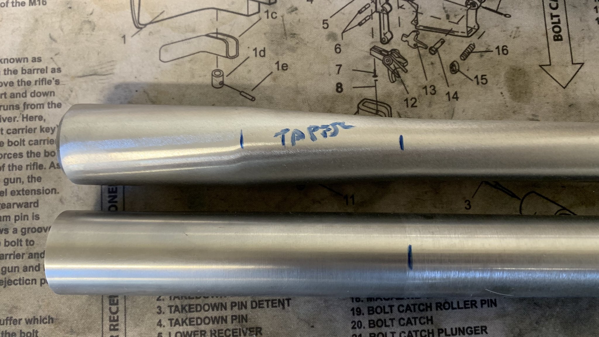

Brux Rem varmint on top, Bartlein Heavy Varmint on bottom. The heavy varmint barrel shown here is 2 lbs heavier than the rem varmint, and would definitely be considered a “truck axle”
Reactions: burns93
These are 2 screenshots from the criterion barrels website that I been looking at ordering from. From the information on their site bull is in the same category as the varmint contours

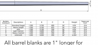

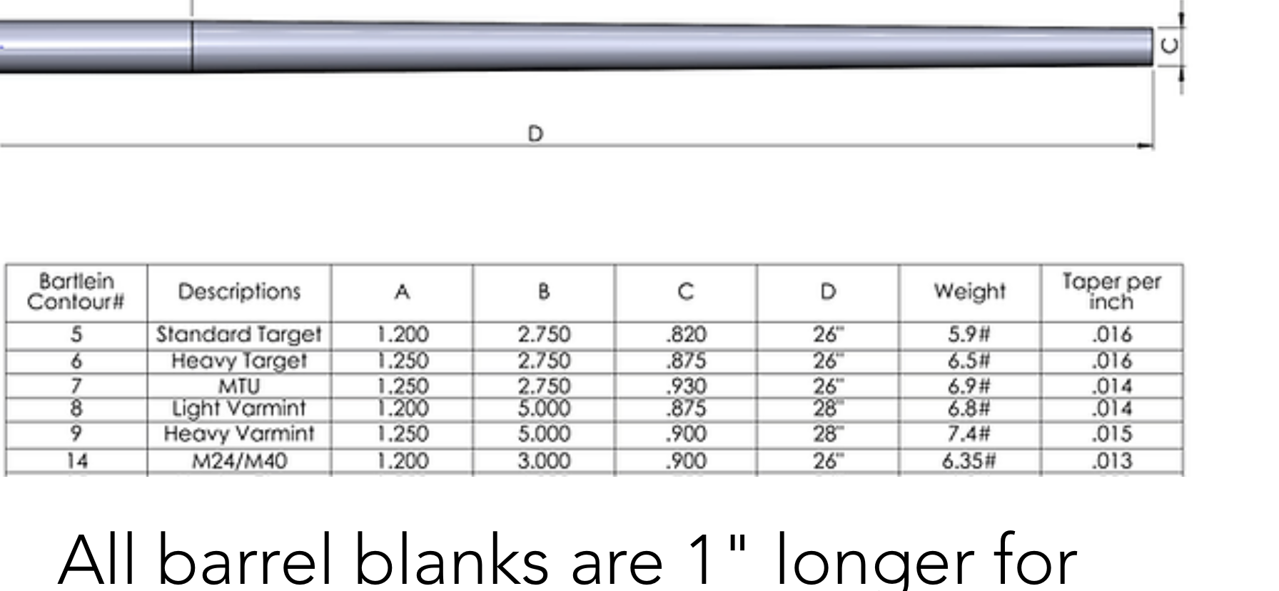

Not a lot of packing around going in on non-comp, precision long range. So go heavy. I always look to stay bigger than .900” at the muzzle for whatever my finished length is. Heavy varmint is the smallest I ever go. MTU is my usual choice. Ideally, I want a full diameter shank for 5” followed by a straight taper to something close to an inch at my finished length.
ETA: Everyone uses different words for their contours. Criterion’s “varmint” and “MTU” are different than Bartlein’s, for example. See attached chart. When ordering Bartlein, it’s an 8 or 9 for me, depending on finish length.
