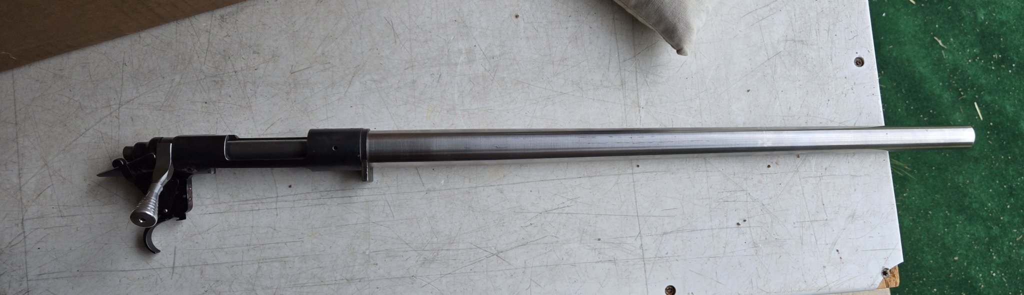

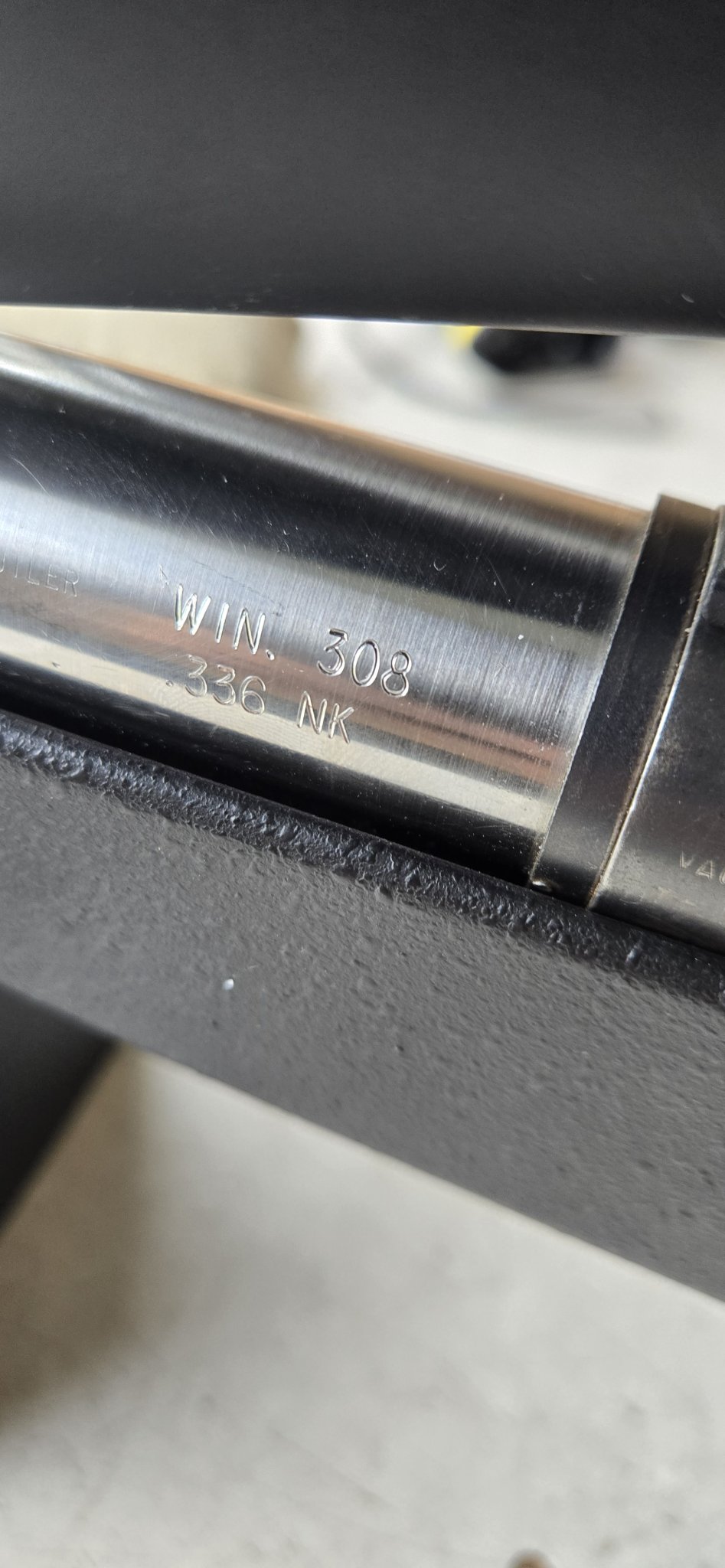

FrozenMinnesotan Sergeant of the Hide Full Member Minuteman Apr 28, 2018 336 149 Ne MN Jul 17, 2024 #1 Jul 17, 2024 #1 I picked up this r722 with a 308 barrel. Has r.w. butler on it. Came with a ai knock off stock. Anyone tell me the contour or equivalent? Measures 1.2 out to 3-4" and .820" at 20" shoots great. Tight neck though. Attachments 20240717_144010.jpg 193.9 KB · Views: 54 20240716_140449.jpg 260.6 KB · Views: 48 20240716_140806.jpg 223.2 KB · Views: 55
oldrifleman Sergeant Supporter Full Member Minuteman Legend Apr 4, 2012 1,224 1,073 Seattle Jul 17, 2024 #2 Jul 17, 2024 #2 Could be an m24, but it should be wider at 20”, maybe one of the varmit profiles (medium?). Reactions: ShtrRdy
FrozenMinnesotan Sergeant of the Hide Full Member Minuteman Apr 28, 2018 336 149 Ne MN Jul 17, 2024 #3 Jul 17, 2024 #3 Possibly, I had a 20" medium Palma and i don't think it was this thick. My rem 700 varmint is .820 but at 26"
b6graham MMPRL Full Member Minuteman Jul 29, 2014 8,306 8,056 Colorado Jul 17, 2024 #4 Jul 17, 2024 #4 Bartlein #4 or similar .750" + 6" x .0122 = .8232 Contour Dimensions | Bartlein Barrels www.bartleinbarrels.com Reactions: oldrifleman
FrozenMinnesotan Sergeant of the Hide Full Member Minuteman Apr 28, 2018 336 149 Ne MN Jul 17, 2024 #5 Jul 17, 2024 #5 b6graham said: Bartlein #4 or similar .750" + 6" x .0122 = .8232 Contour Dimensions | Bartlein Barrels www.bartleinbarrels.com Click to expand... Thanks.
