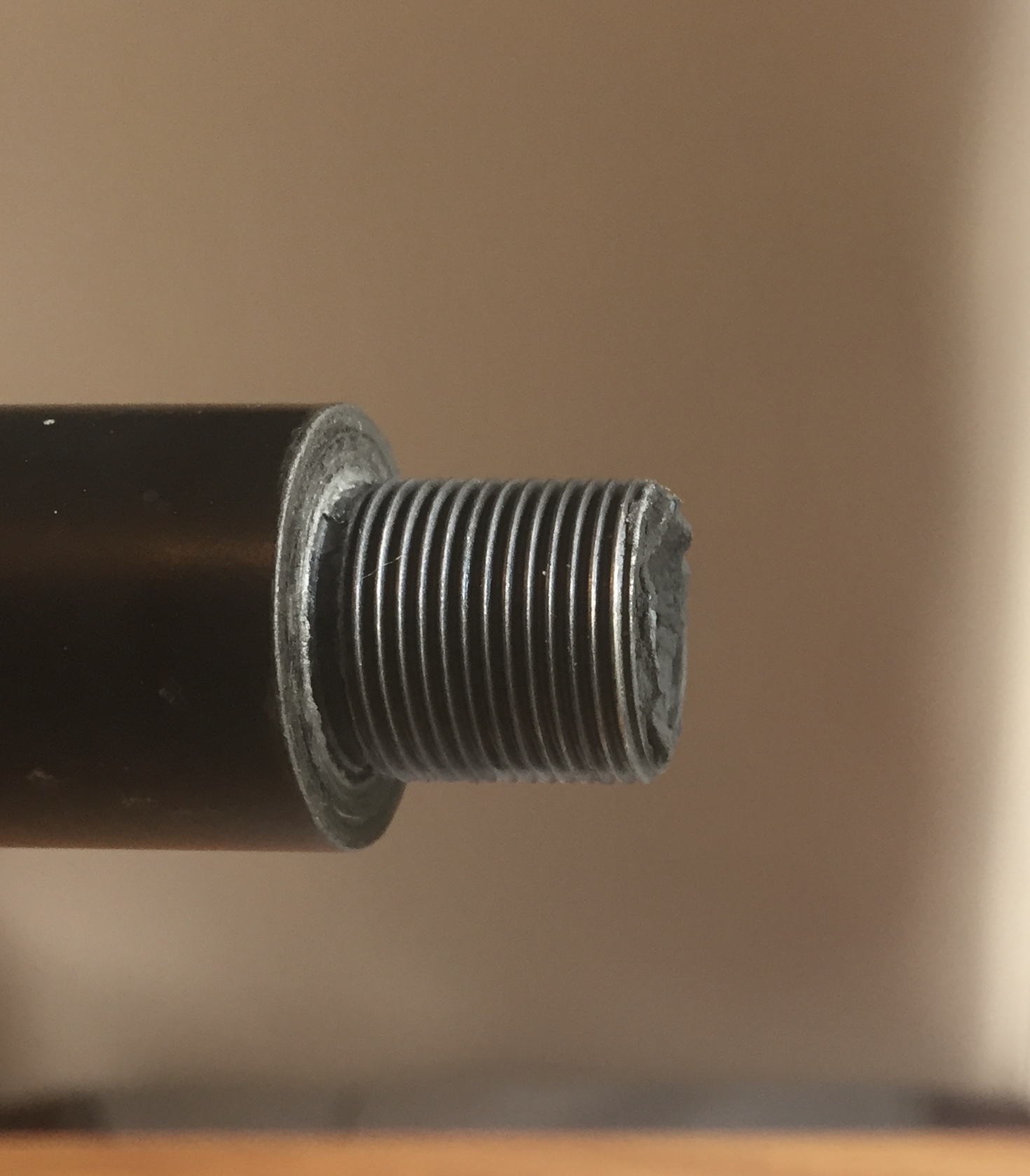

Here’s a picture of carbon buildup on my crown under my can from a while back. Didn’t affect accuracy that I could notice.

I agree, but it was what I had when I took that picture for a response to something on here a few months ago. I’ve had to use a chisel to chunk it off on other occasions.
That stuff can be like iron!

While it's probably true that it doesn't have much effect, I don't think anyone wants to be running a rough, jagged crown that aids in excess carbon buildup. Like the pics above, it's bad enough with a good crown when running any muzzle device/can. If you spend all the time it takes to make everything else on the barrel square and concentric, then the crown would be no different. Whether it makes a big difference or not, I would rather have it square and concentric than not.

The crown of the crusted barrel I posted above was an 11 degree cut barrel crown. Carbon doesn’t care.
