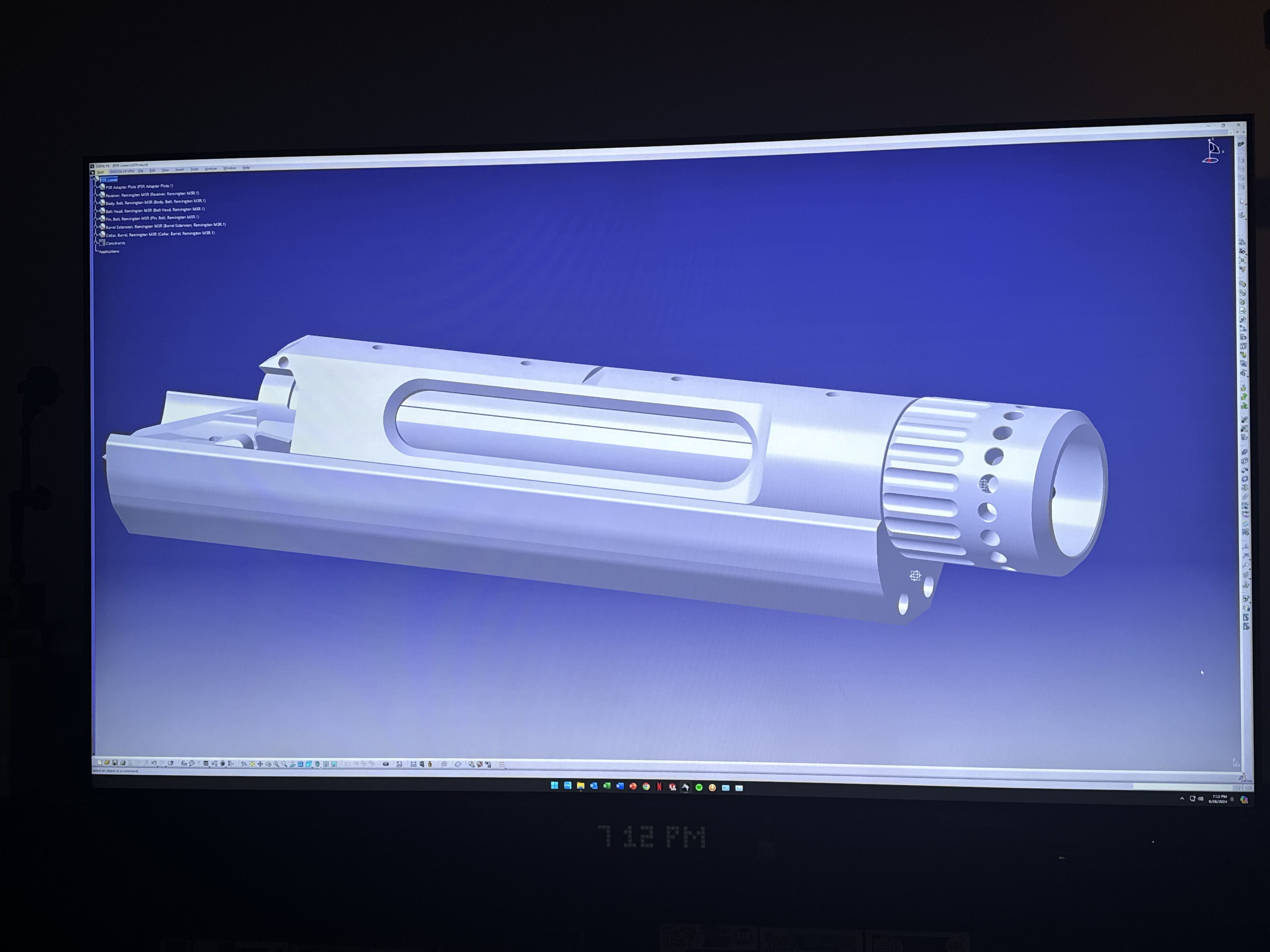

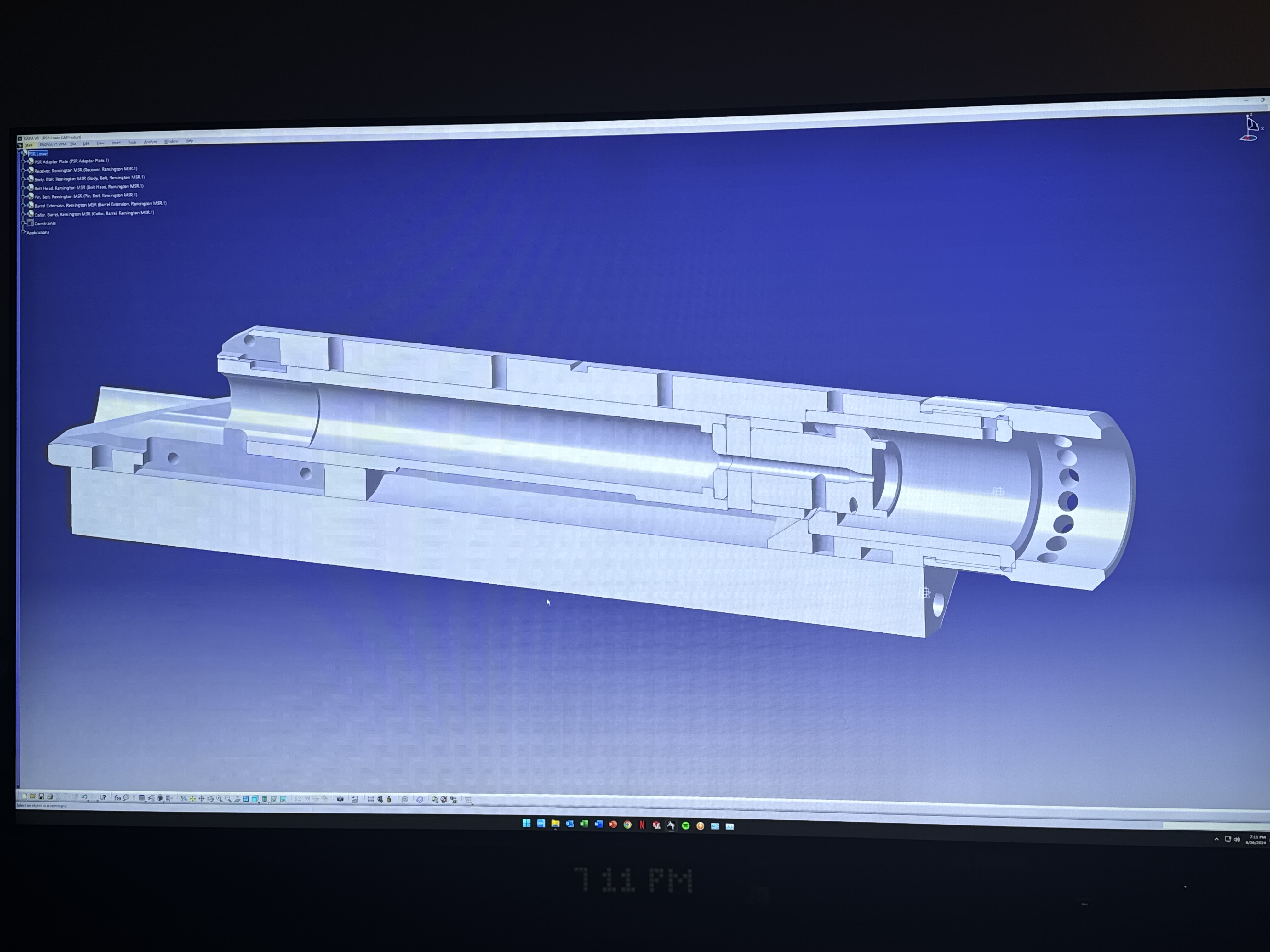

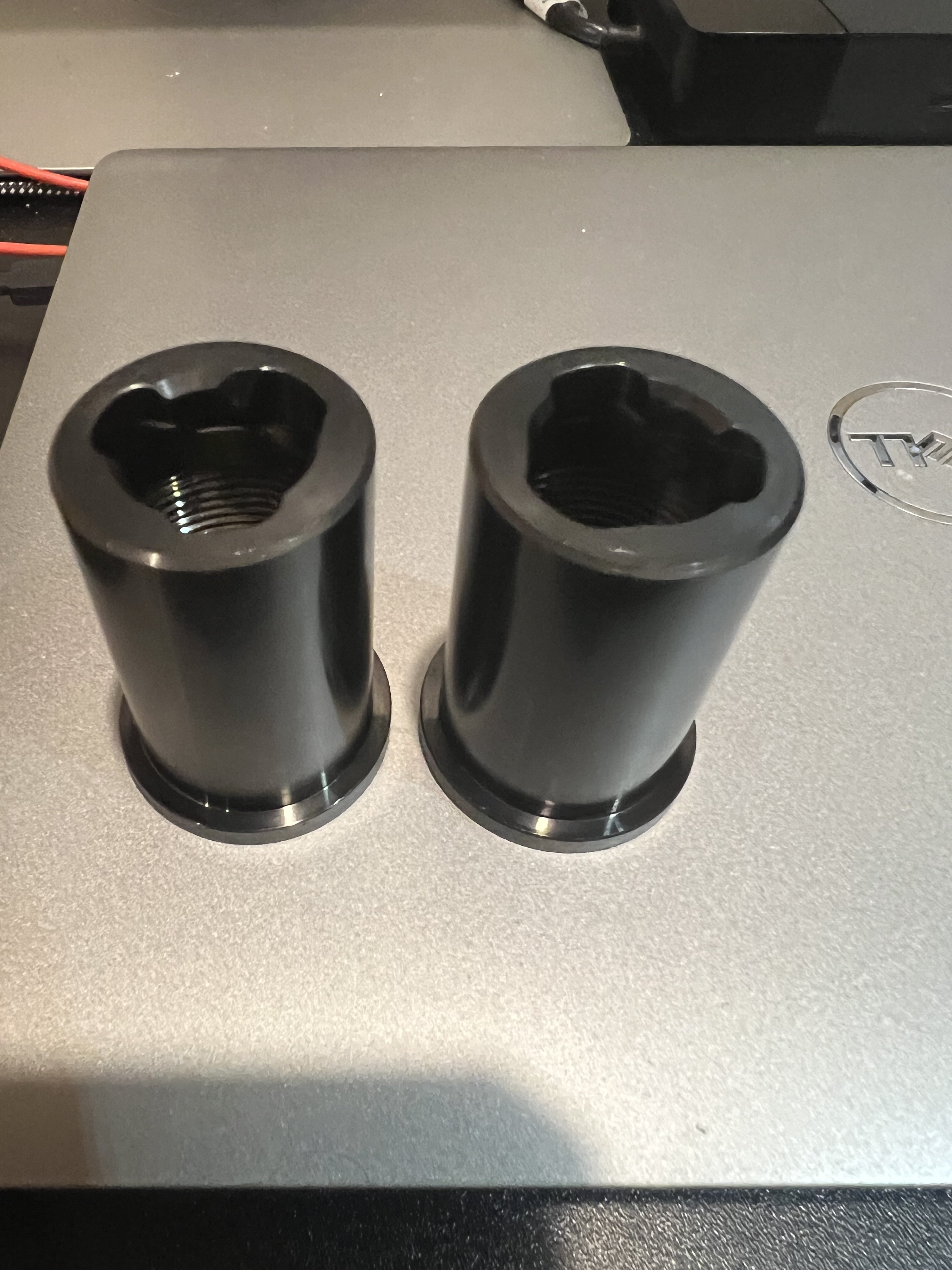

FWIW. I have a complete PSR. I am firstly attempting to have a shop replicate the 308win bolt head. As I would like a spare. Seems that this is one of the most highly demanded parts. I emailed LRI in SD about it. I am awaiting a response. I would encourage those who are interested to join the Facebook group titled "All Things RemDef". As myself, and other interested parties have expressed interest on there.
As for parts other parts, I am in possession of several schematics for this system. I did not make these drawings. They were given to me as part of a trade. I am not a machinist. I cannot guarantee fitment or functionally based on these schematics. However, I had some of these parts 3D printed in high quality nylon and it fit together nicely. I do know there is a fellow Hide member who used this Bolt Body schematic to machine his own. I would be happy to share these files free of charge. Just message me an email address. The files are titled as follows:
1) 17017 Ejector
2) Barrel extension, Remington MSR
3) Body, Bolt, Remington MSR
4) Bolt Head, Remington MSR
5) Collar, Barrel, Remington MSR
6) Pin, Bolt, Remington MSR
7) Receiver, Remington MSR
