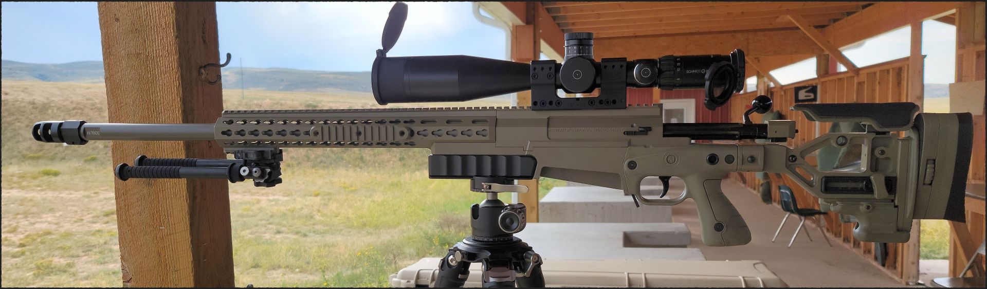

I went with a 33XC from Southern Precision. 33" 1 in 9.3, Bartlien 400 MODBB.
Reactions: CEO10KaDAY

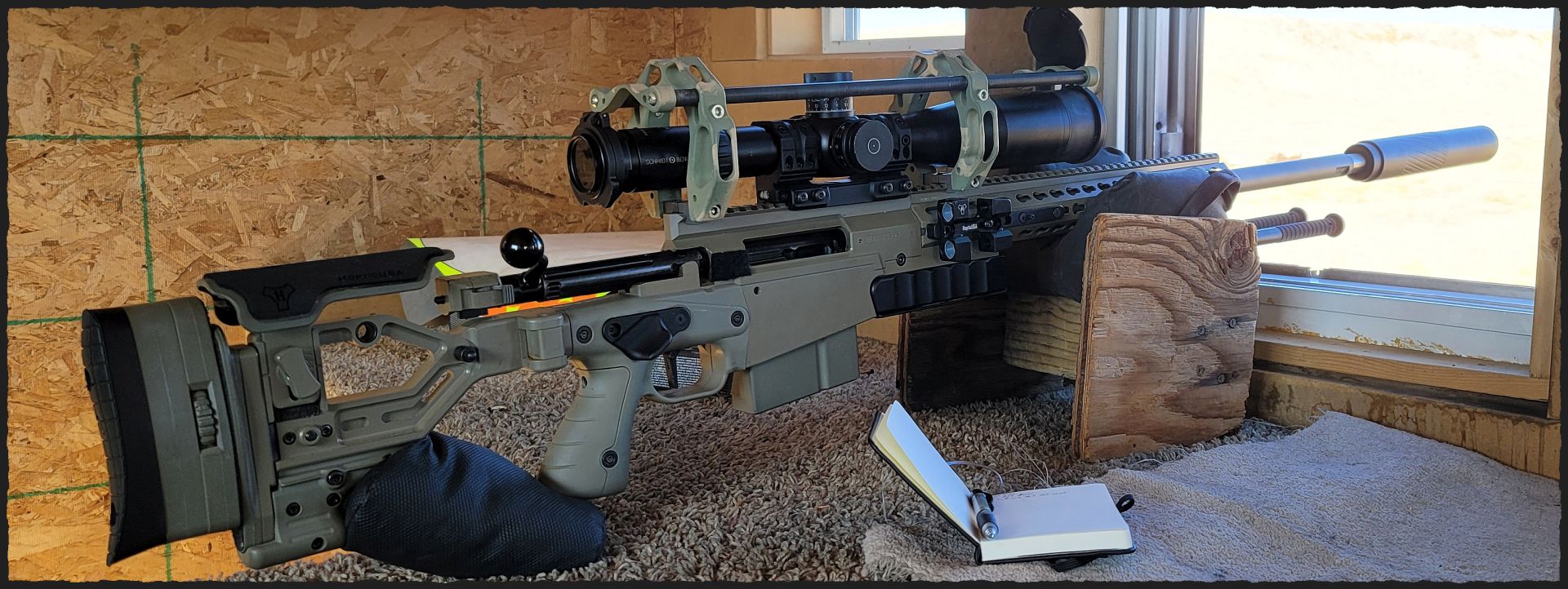

So the brake became an APW, and the current scope is the SuB 5-20x50 US. AIAXMC and a looong Krieger barrel.

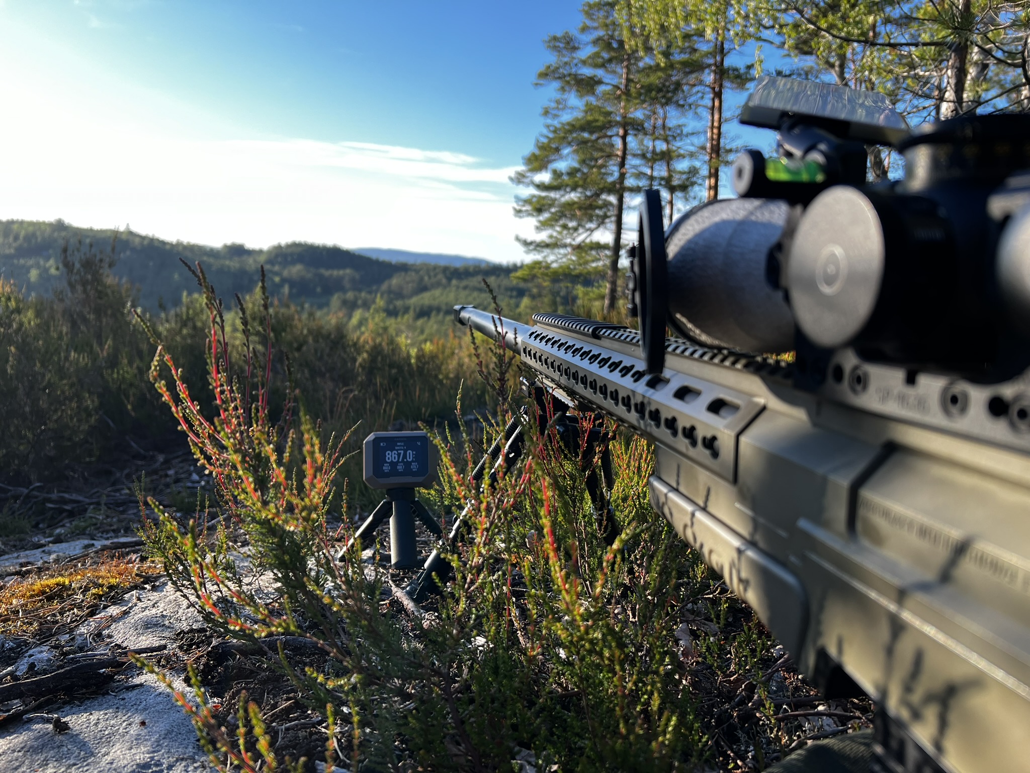

Having now shot a little, and taken the Peregrines to a couple of matches, (but fell apart at the 2000m + ranges to ES/SD), and then got hold of some 400gr Lazers, and some 390 A-Tips. Using N570 and RS80.
The rifle shoots sweet, very manageable, but loud. I'll get a suppressor on my next paycheck or thereabouts... Topped it with a S&B 6-36x56, and that is a very nice scope i have to say.
The Peregrines, 393gr, confirmed their high BC, (chrono at muzzle and at 1250m simultaneously ) and they group nicely short range - out to say, 7-8-900m, maybe even 1200, driven by 119gr N570. Getting 890m/s -ish in summer weather.
BUT, ES/SD is excessive, 10-12, even 15m/s, i cannot get it down. It is lower with RS80, but then it wont group. I could probably go 4-5gr higher on the RS as i have just 845m/s w/ 120gr.
The A-Tips, i get very good ES, 2m/s on the last 12 shots, 845m/s from 112gr N570. Good groups at 100m, even though there is some vertical tendencies, but the ES/SD is higher at the target than at the muzzle, whick is strange imo, unless there is a stability issue, which there shouldnt be, in an 8" twist barrel (reason i only drive them 845m/s) I also get more vertical than i like, around 25-30cm at 1000m. Slightly lower BC than advertised, at 0.485, but still very good.
Lazers, running 868m/s on average, ES/SD 5/1.6m/s, gives maybe 15cm of vertical at 1000m, and they group into cloverleafs at 100, all in all very good. I'll run with the Lazers for the upcoming matches. BC seems to be a little higher than advertised, 0.479. But all my BCs are still in the working, having shot less than 200 rounds in total.
I was amazed, and "yes this is great" at the low ES of the A-Tips, but the vertical... Any advise on this greatly appreciated, should i up the speed? Change the COL?, Both? Try the RS80?
Still, the Lazers do the job, i am not sure how bad the 1.6m/s (5fps) SD will hurt at the longer ranges, and hoped the A-Tips, with their higher BC as well would group better.
