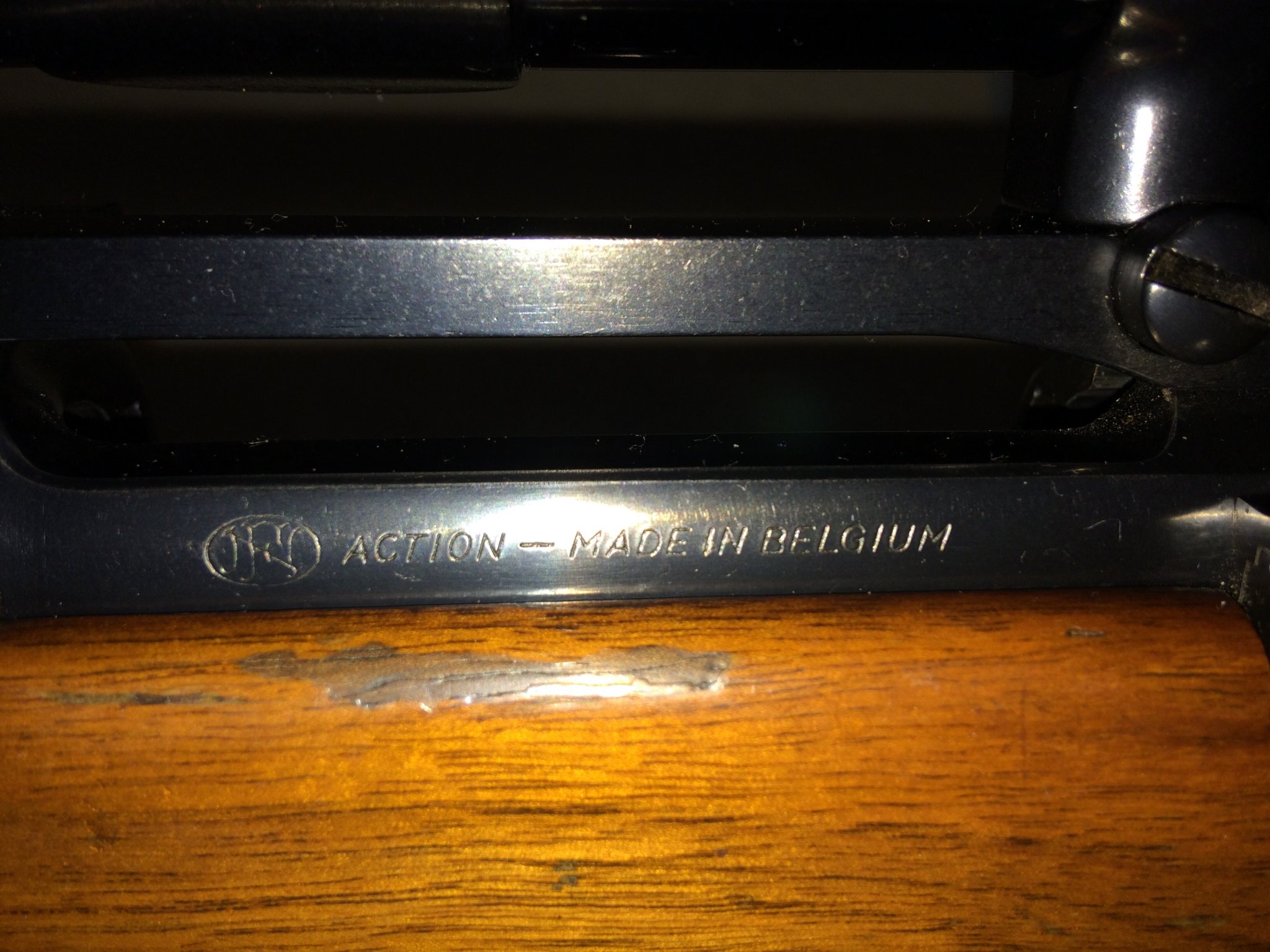

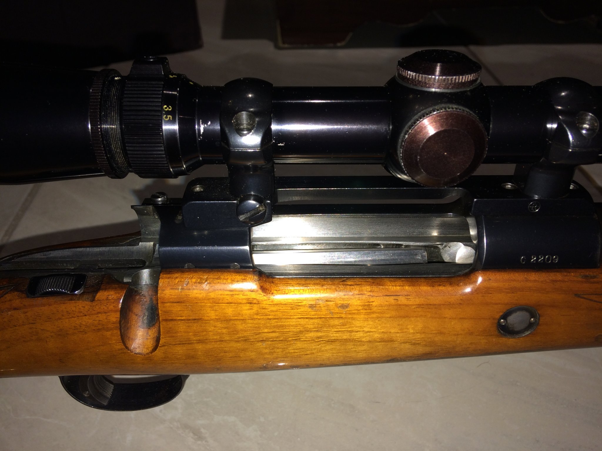

Barrel for my FN 3006 suprem model made in Belgiu
Runner2020
Sep 14, 2020
12
2

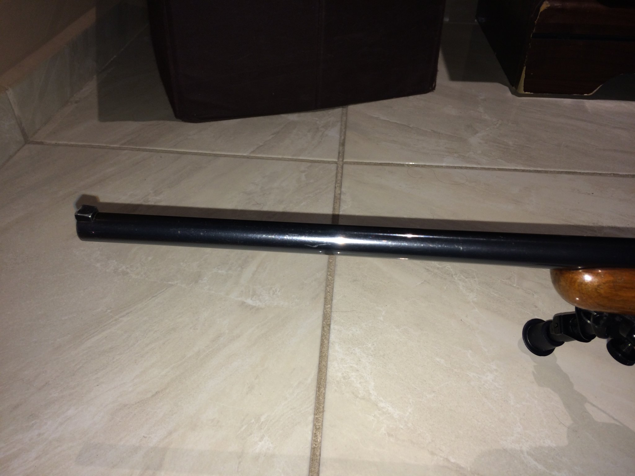

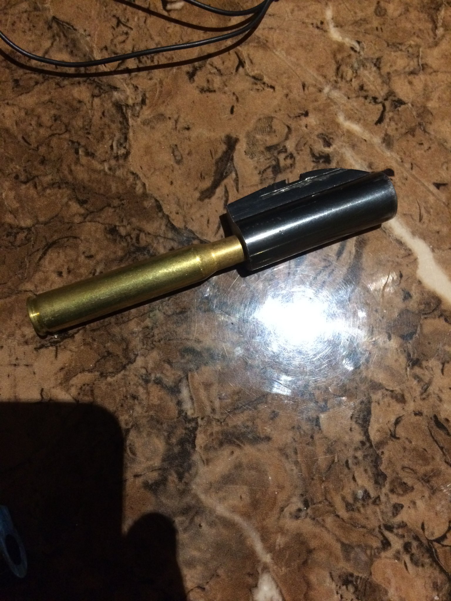

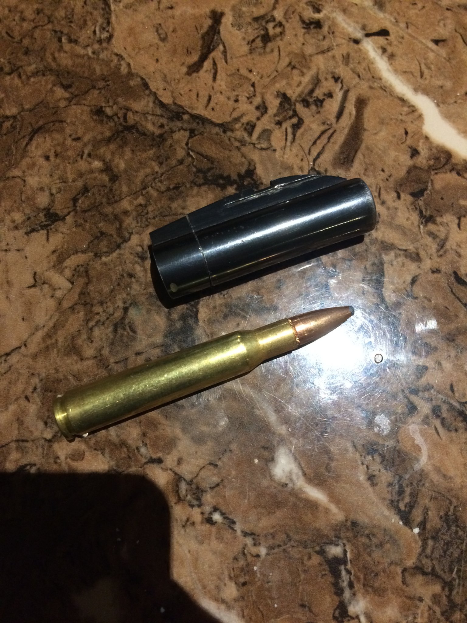

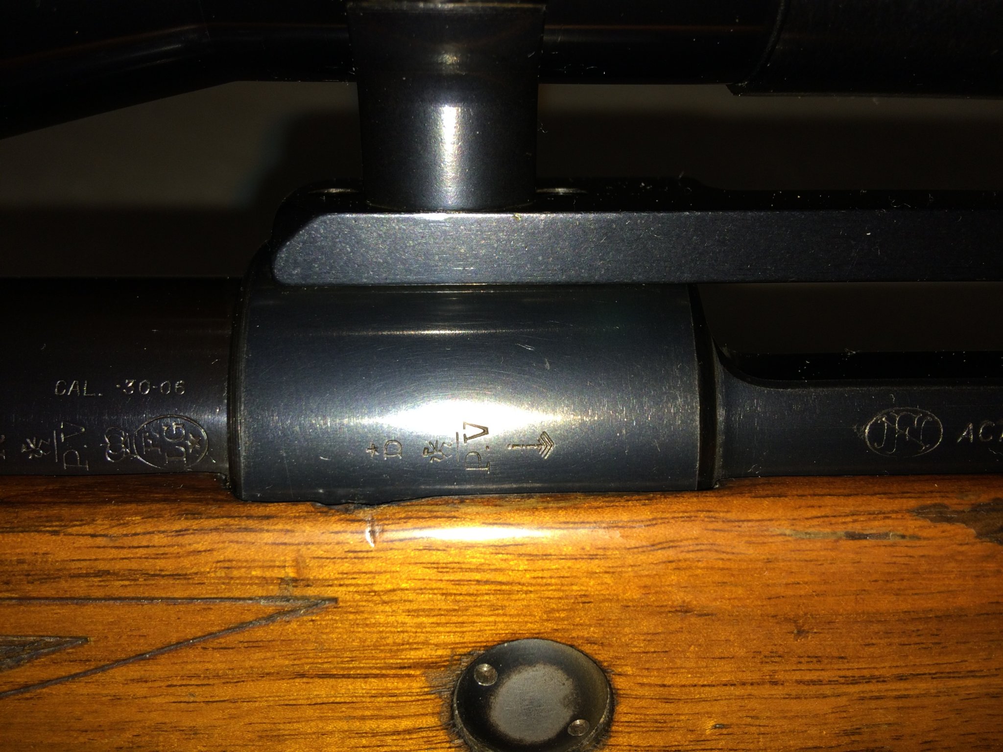

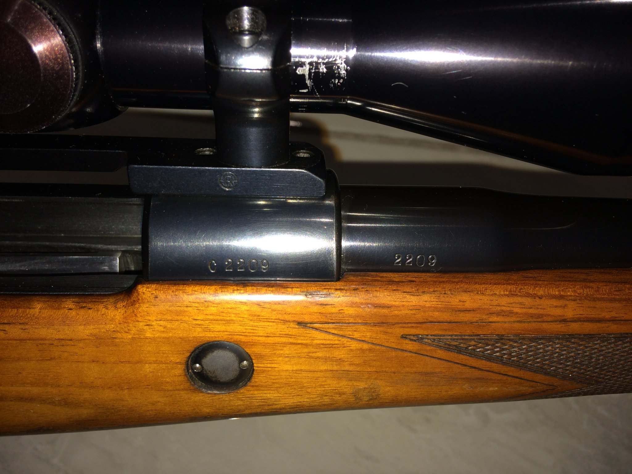

Hello guys, tks for let me join on your page
Im looking a barrel that fits on my FN action to made a long range whit this kind of charge: 62.0gr H4350 for the 30/06 150gr
Some body tall me this to help me to find it : what your action is threaded for ??, this means exactly what?
He told me this : threads are the spiral things that look like a screw where the barrel screws into the reciever. they never touch a bullet they just screw into the reciever
But right now i dont put off, then I font know, need to remove it to know how many threads are for?
Tks
Tks
Tks
They just asked you a question, did you not see It?
Why did you copy paste your original post, we already saw it at the top.
You will need to see if there is a gunsmith or gun repair or parts shop in your country and ask them. They will be most likely to be able to help you with a barrel.
bartlein as suggested above is a really good company. Wait times are really long here in the US right now.

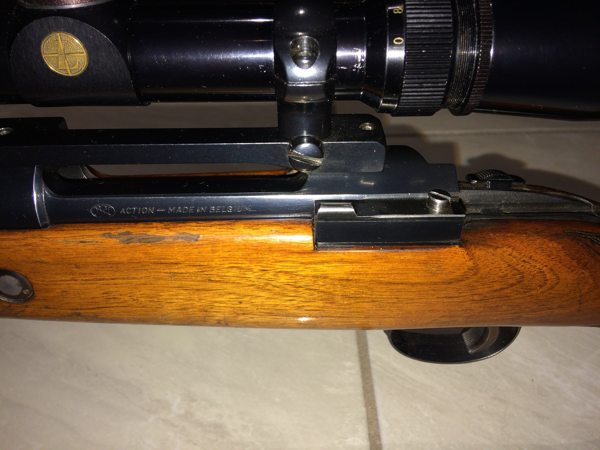

An FN Supreme will have regular Mauser M98 threads.
In Europe it should be fairly easy to source a Lothar Walther or Heym pre-fit. Not sure about Mexico.
No , Mexico 🇲🇽 don’t made any barrel so, I tried to make one whit this guys :
But they told me not, that the government of USA 🇺🇸 don’t accept any gun form Mexico 🇲🇽 to USA 🇺🇸, come on guys I said , I fixed my gun whit a cnc machine and now is 👌 ok, perfect can say 1/2 moa = 1/2 in at 200 meters / 12 shots , but I want more larger barrel , i have to cuted from the point 2 inches, we had an accident on it at the moment of alingmet on target 🎯 Field, we forgot a bore sight lasser 😆😆😡😡😡and damage that part

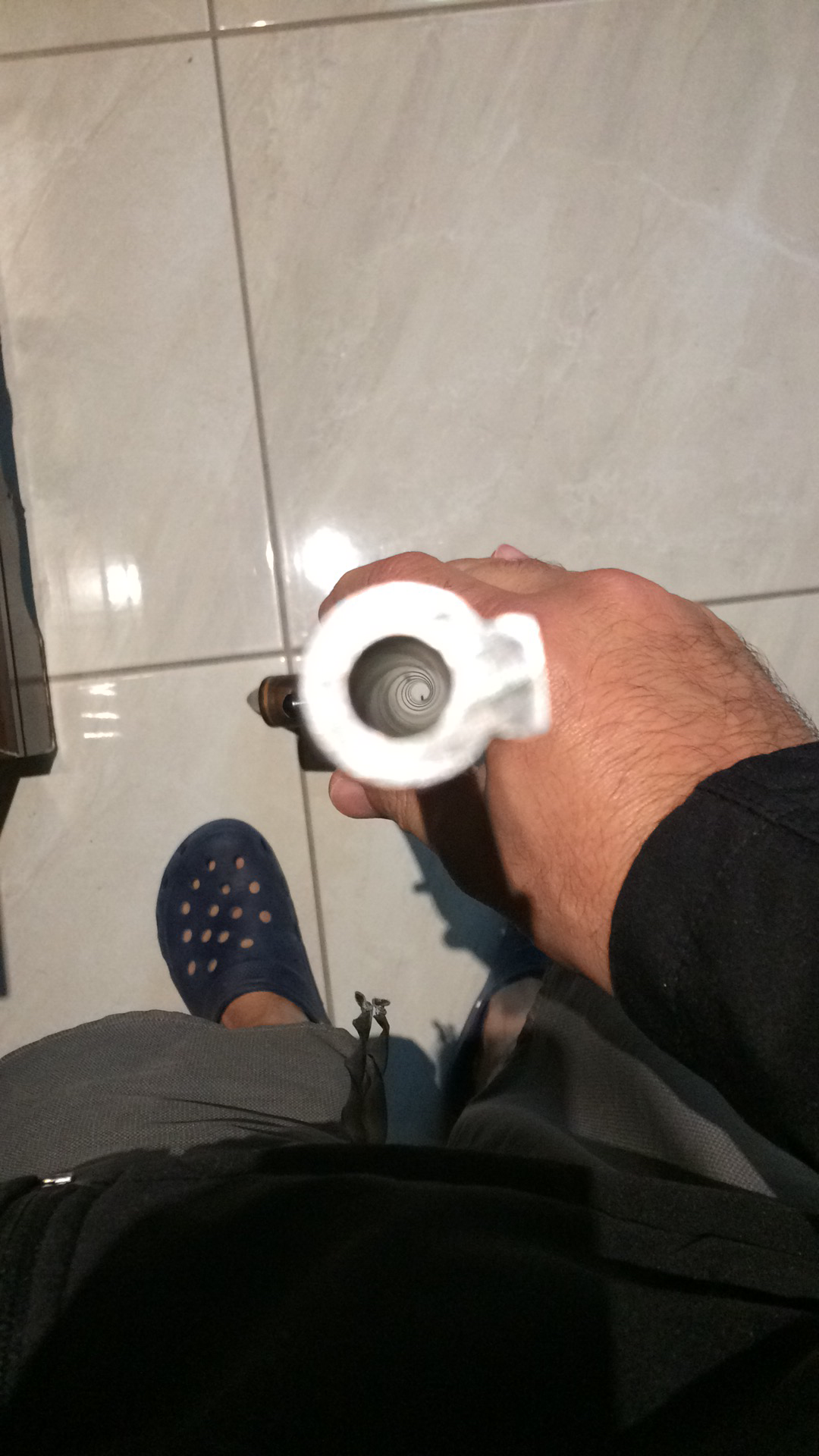

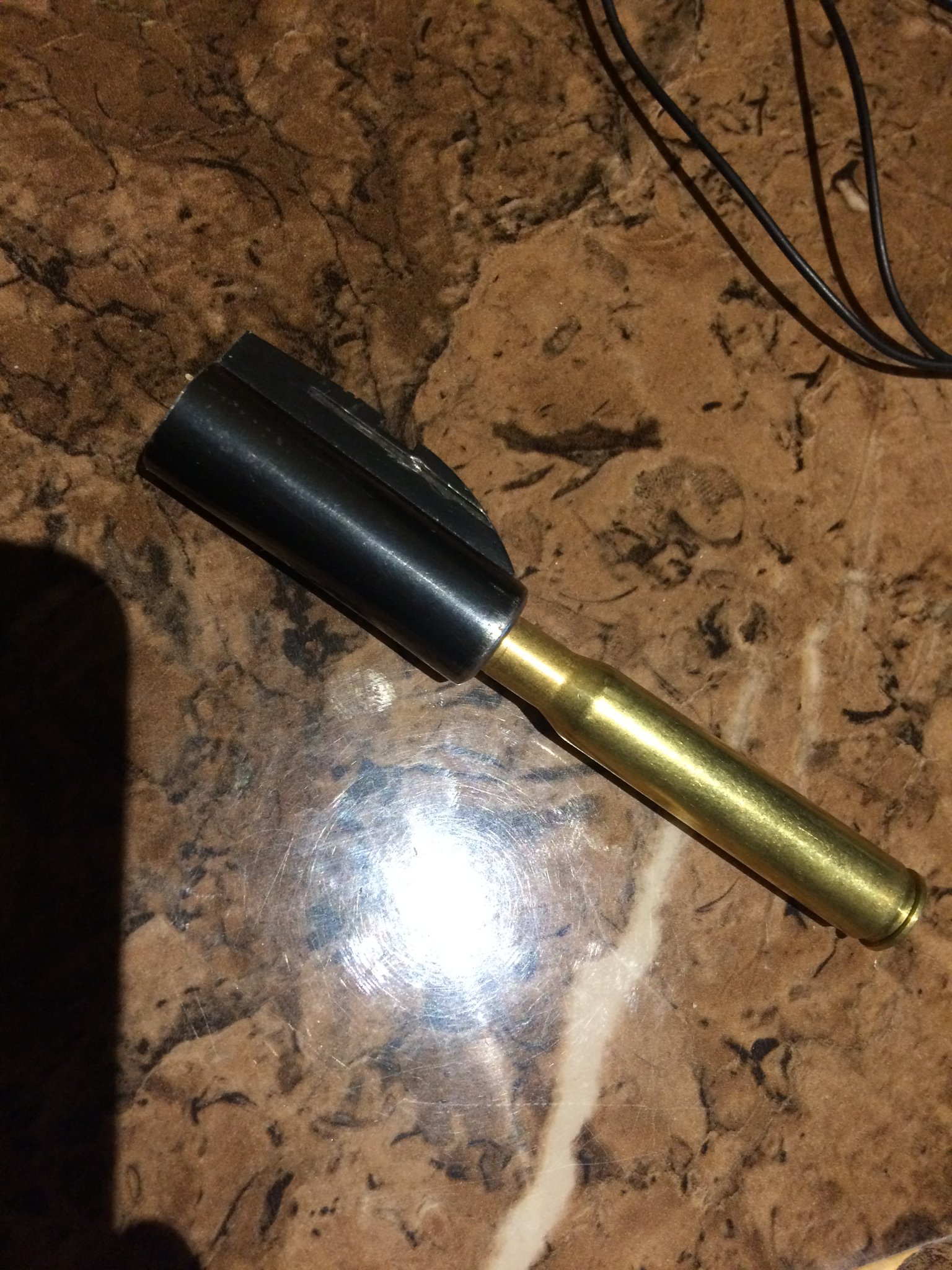

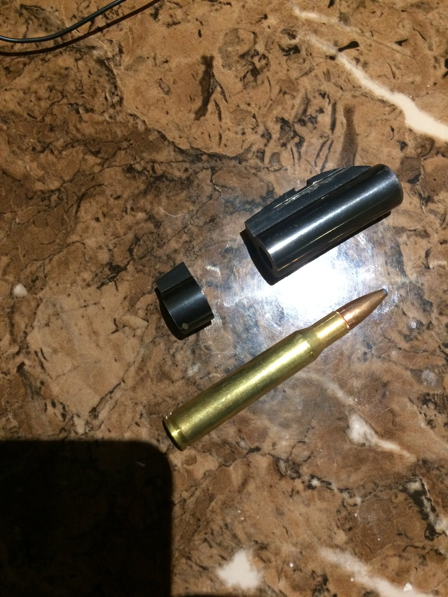

Here the part damage and after result

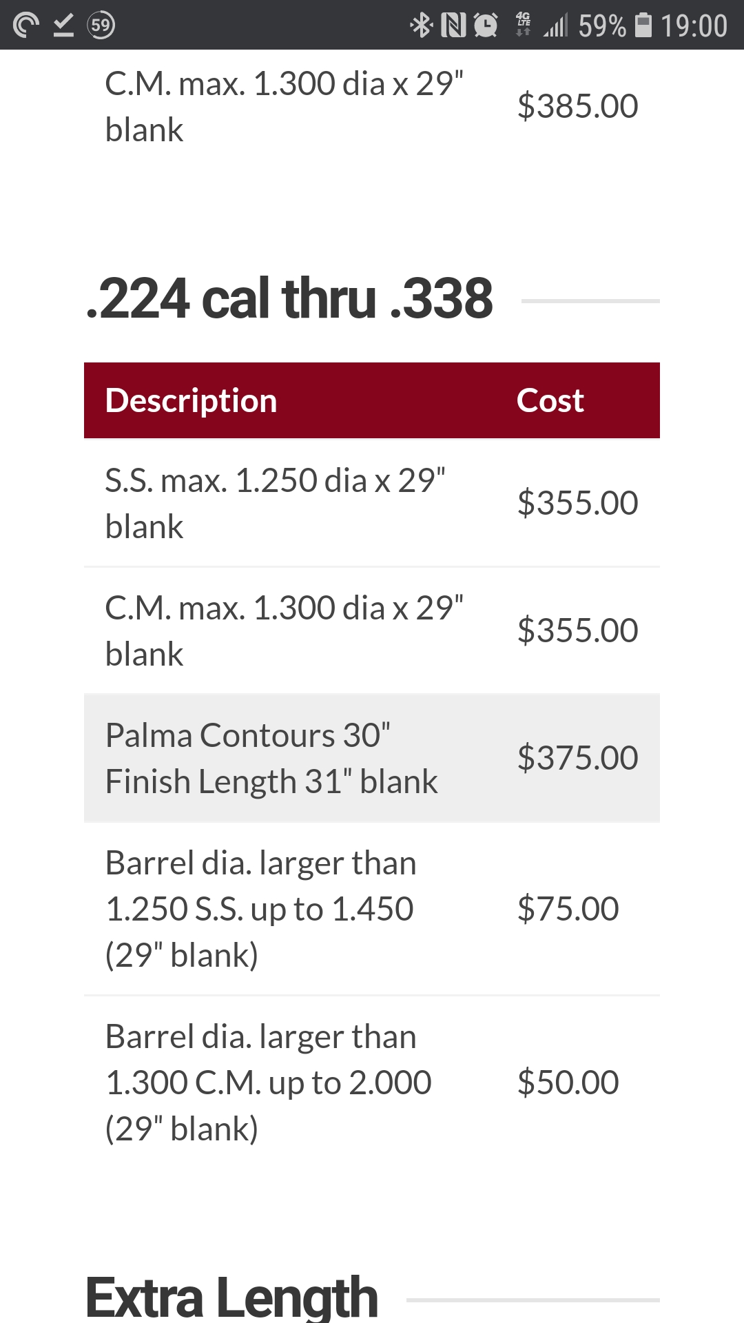

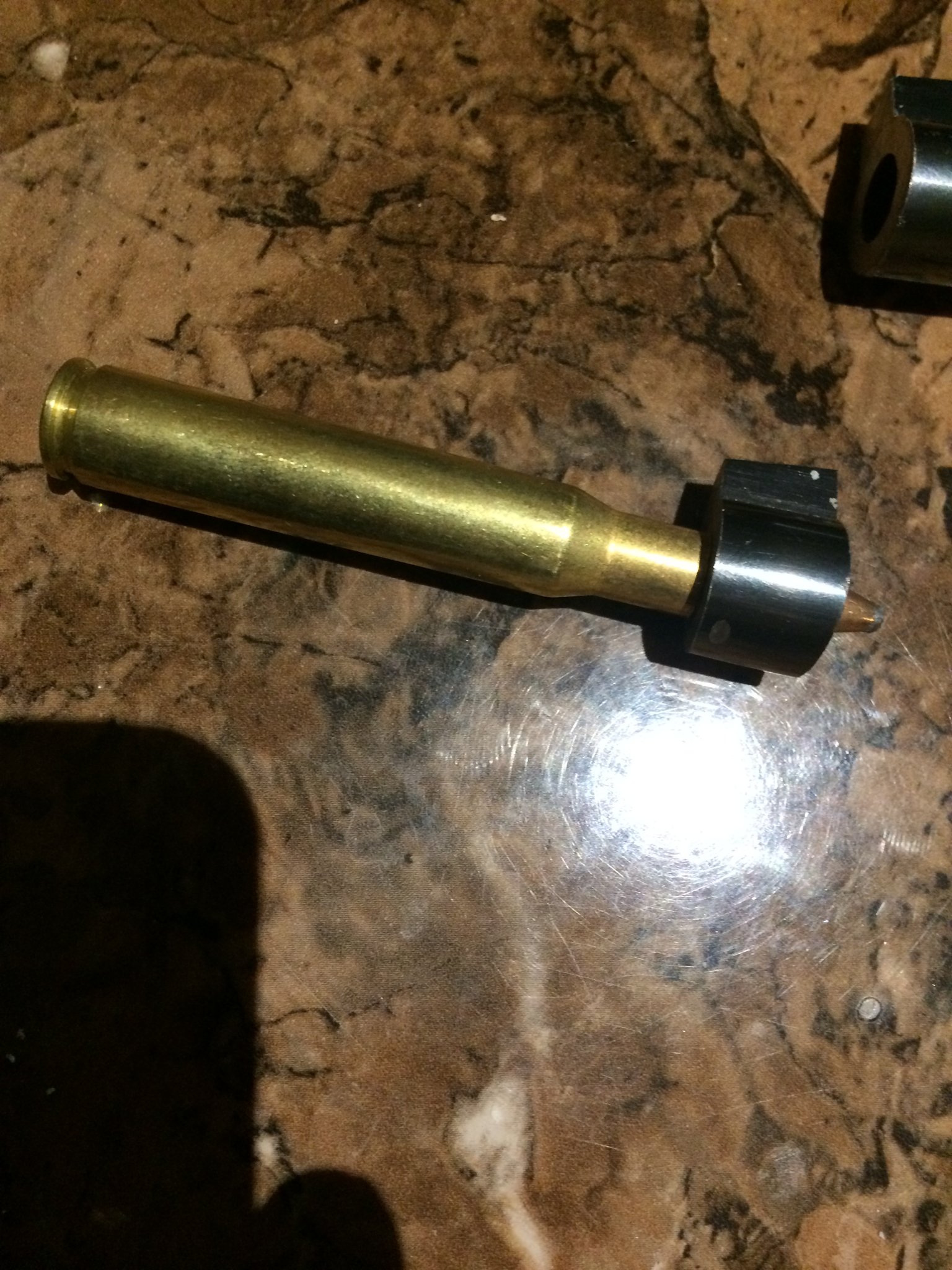

I wrote them to this guys ( Bartlein Barrel usa 🇺🇸
Bartlein : We could supply a rifled blank, delivered to your U.S. address, that you could bring to a Gunsmith in your country to be finished contoured, threaded and chambered there
Me :
Ok less talk data tech barrel :
What will be the best recommendation bar for my purposes :
Please answer me in this order please ,
1- what kind of steel 41-50? Or other best ?
2- 1:10, 1:16 twists? , for long range and more velocity/ fps and accuracy/ group?
3-what is the width for that barrel ( 1-3/4 inch more less and total length ?
4- The rhyme for made the chamber length do you sell me too?
5 what will be the total cost of the bar , rhyme and shipping?
6-Can a Pay you whit money order payments ?
7- In the near future if we have lucky whit this proyect you can sell me another bars in other gauges?, bull bars etc?
What have now In the original barrel is this : finishing outside chrome vanadium steel , inside have 4 stripes or stretch marks
that sound great for me but : what about inside the blank, all ready have leads , stripes or stretch inside and how many do you recommend me for my purpose and the thickness for the leads or stripes ?
Im waiting an answer 😎😎😊😊

There are a number of manufacturers of rifle reamers like Manson, PTG, Clymer
The one that i'm most familiar with is the Manson company:
you might try to call them and discuss your questions with them. wish i could be of more help but i don't know very much about this type of thing.
Me :

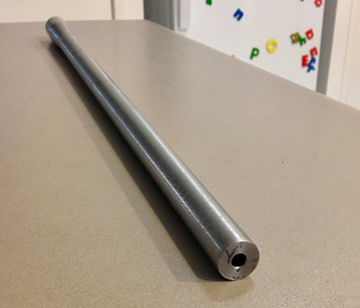

Translating your terminology as best I can.
1. blueable (4140) or stainless (416r) both last the same. Bartlein has a new material that is a modified stainless that lasts longer. For your purposes do you want the color to match the action when it is done? If yes blued would be best but it might be harder to match the color exactly.
2. 30-06 twists ask others. I don't know that. Should be fine to stick with what people are running for 308 or whatever Bartlein recommends. Also matters on what bullet weights you are running or planning on running.
3. Here are basic costs and sizes. Blank diameter that you need depends on the barrel you have now.
4. Reamers (your rhyme typed above) they don't sell but if you find a gunsmith in your area they should be able to help you.
5. See #3 for rough price. For better info call them.
6. Idk. Ask them.
7. With your rifle you could probably re-barrel for anything that uses the same bolt face of 0.473 inches. Ex 6.5 Creed, 308 win or others for example. With them sending you a blank (uncontoured) you can make whatever barrel profile you want.
Your description of 4 stripes/stretch marks is a 4 groove barrel. Twist rate and numbers of grooves and type I would ask Bartlein about and go with what they recommend. Bartlein is a barrel maker. They are the ones that put the grooves in.
The blank could look something like this.
For final contour that is up to you to discuss with your gunsmith.
Good luck.
Tks Jason
Yes, The Boss Mark / Bartlein recomend me standard barrel 1:10 twist 5r, I will removed it past next January to send the thickness near to the chamber
To determine what kind of chrome moly will be the best for my purpose to long range like the bar that you put here more less 1 3/4 in
I hope made my proyect whit a very good guys Cnc here in my country and see the final results whit my new charge on it ( 62.0gr H4350 for the 30/06 150gr) made whit My friend Lance Hendershot from extreme amunition Re-loading
