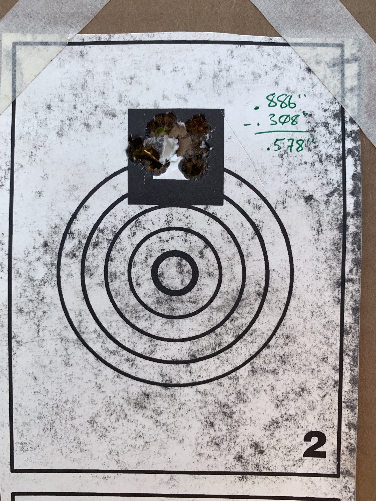

For example, a 1.350” straight cylinder is gonna take a lot more to see a a POI shift due to heat than a factory rifle sporter taper. A sporter taper has far less mass, and will start to shift much quicker. A typical “tactical” or field taper is in between a truck axle and a soda straw, and should not show POI shift on a 20 shot string.
Here is a 10 shot string with a heavy Palma Bartlein in 308:
7090449
I mention chambering and all that, because this is also dependent on chambering. It will take a .222 much, much longer/more intense firing schedule to overheat a barrel and cause shift than say a Lazzeroni Warbird or a .505 Gibbs, etc.
