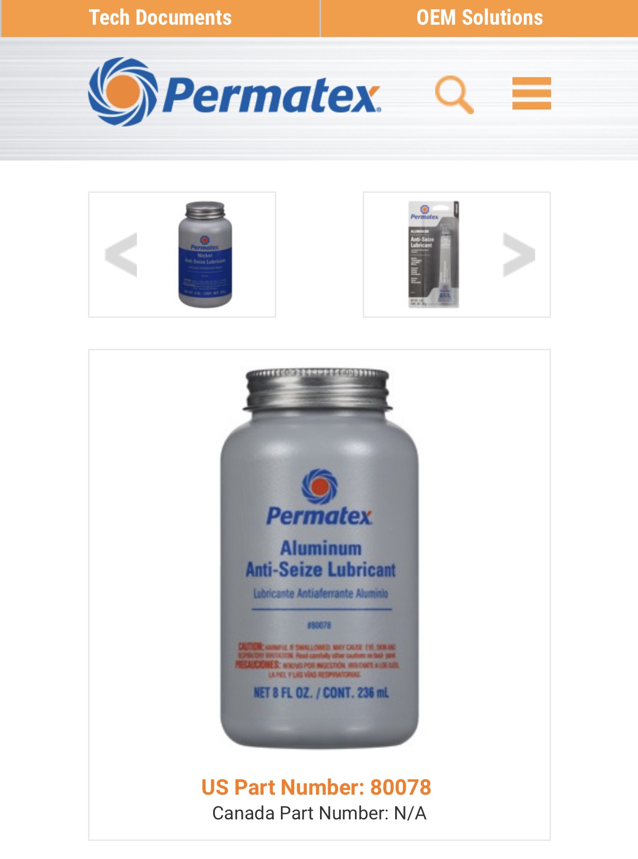

I like nickel anti seize. A lifetime supply can be had for less than $10.
Permatex® Nickel Anti-Seize Lubricant
Category: Specialty Lubricants - Anti-Seize
Protects metal parts from seizing and galling at temperatures up to 2400°F (1316°C). It is recommended where copper contamination must be avoided, under conditions of extreme pressure and temperature, and with stainless steel, titanium and nickel alloys.

I Use it on everything including barrels, never had an issue with it one can lasts forever and thats not an overstatement... less is more here just as locktite
