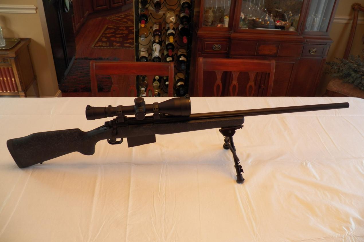

Actually I have taken the issue into my own hands as it were and replaced that rifle with another 300WM. I scooped up a new from Remington "Creakote Tactical" which is a 700 action mated to a 26" fluted heavier barrel, 10"-1' 5R rifling [whatever that is] with a Leupold 3.5-14 X50 Tactical scope. The most interesting thing about this rifle, at least to me, is the stock. It is a Bell & Carlson copy of the original M40A1 fiberglass stock from 1971, a fit and feel with which I am, perhaps unfortunately, quite familiar. It does fit like an old glove as opposed to the B&C Medalist I put on the other rifle. I never got used to the comb bulge of that stock and, although this M40 style stock doesn't look as "cool" as the Medalist, it fits and that's it for me.
