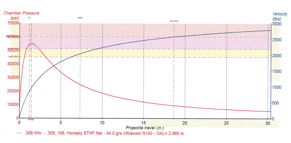

Most velocity is gained in the first few inches of barrel
In this 308 at 16" its going 2,500 fps, at 26" its going 2,800. But at only 6" its already going 2,000 fps.
Accuracy can be completely independent of length and velocity. Accuracy is more related to how well your equipment is machined true and how straight your ammo is and how well its loaded to match the barrels preference. The actual amount of time it spends in the barrel doesnt really matter beyond wanting to achieve a certain relative velocity.

I have been trying to get my head wrapped around this question for a while now. I have read many articles and there seems to be some agreements and some contradictions. In reading the "Accuracy and Precision for Long Range Shooting" by Bryan Litz, he states in Chapter 6 that muzzle velocity increases with barrel length. I believed that too and to add to it, I understood that the 6.5 creedmore was developed around a 24" barrel. I am shooting a Wilson Combat AR-10 chambered in 6.5 creedmore with a 22" barrel. I was struggling to get the groups i hoped for so i decided to freshen it up by installing a new barrel from Wilson Combat that is 24" long. To make a long story short, my muzzle velocity using the same exact load DROPPED by about 50fps and my groups were not impressive.
In reading multiple articles on this topic, this is a common thing depending on caliber. However, i never expected to lose MV going from a 22" to 24" barrel with the exact same load. My muzzle velocity with the 22" barrel was appx 1760 average and it dropped to an average of about 2705. My load consisted of Lapua brass, Lapua Scenar L 136gr, and Vihtavouri N550 powder.
I recently reduced my load to get a velocity closer to 2640 just to see if this lower velocity was a better fit for my rifle and the results are still not what I was hoping for. I am now going to increase my loads to get upwards of 2750 to see if that works any better. The problem i run into here is that with those kinds of loads, the AR-10 action is hard on my brass and they come out piping HOT, something i am really not comfortable with.
Other things i have heard is that if you go with a longer barrel, make sure it is a bigger (diameter) barrel because you can experience a whipping action from the smaller barrel. not sure if there is any truth to this, just something i read.
