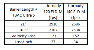

What does matter is the velocities you may achieve, hence my posts above about why F-class shooters and 1000 yard BR guys use longer barrels - to attain the best ballistics to best mitigate the elements out of your control.
People shouldn't read into the 21.75" barrel length comment too much. My point being, if you're a casual shooter you can be really effective and have fun at long distances with short barrels. If you are shooting in a discipline where every point counts and you need the biggest competitive advantage, go with a barrel length that will provide the best down range ballistics to mitigate elements out of your control.
I wouldn't read into it too much. For short range applications, which the above is essentially all about, perhaps a shorter barrel may be more accurate then a longer one due to barrel harmonics. In reality, most shooters wouldn't be able to shoot the difference, assuming there is one.

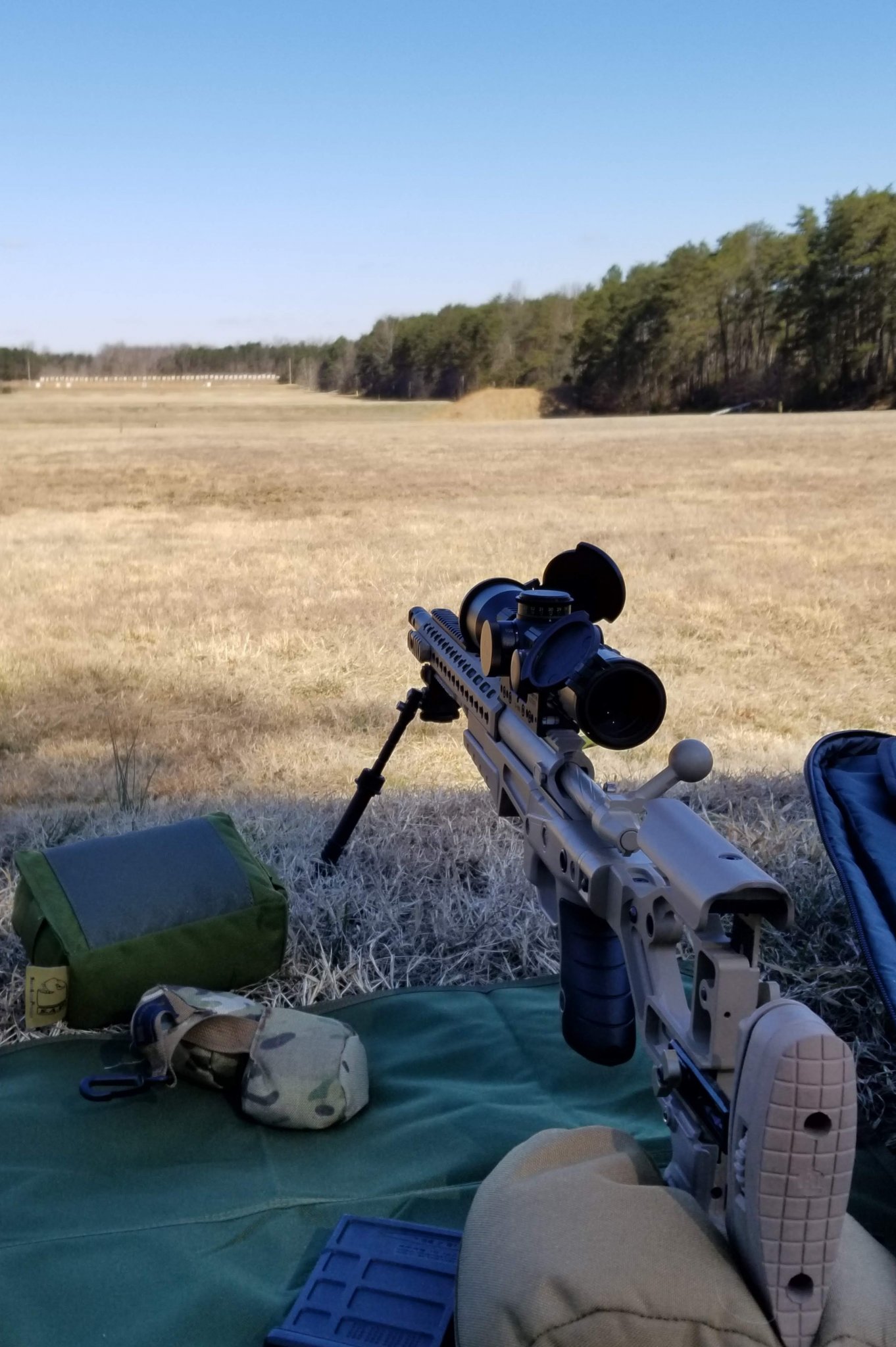

19in .308 Krieger shooting 1k yards at Quantico.
Did I hit everytime? Hell no
Did the guys shooting 6.5cm with 20+ barrels smoke check me with wind/elevation adjustments? Hell yes.
Do I learn something new each time I shoot the shorter barrel at longer distance? Fuck yes.
Reactions: mgrs and kthomas
