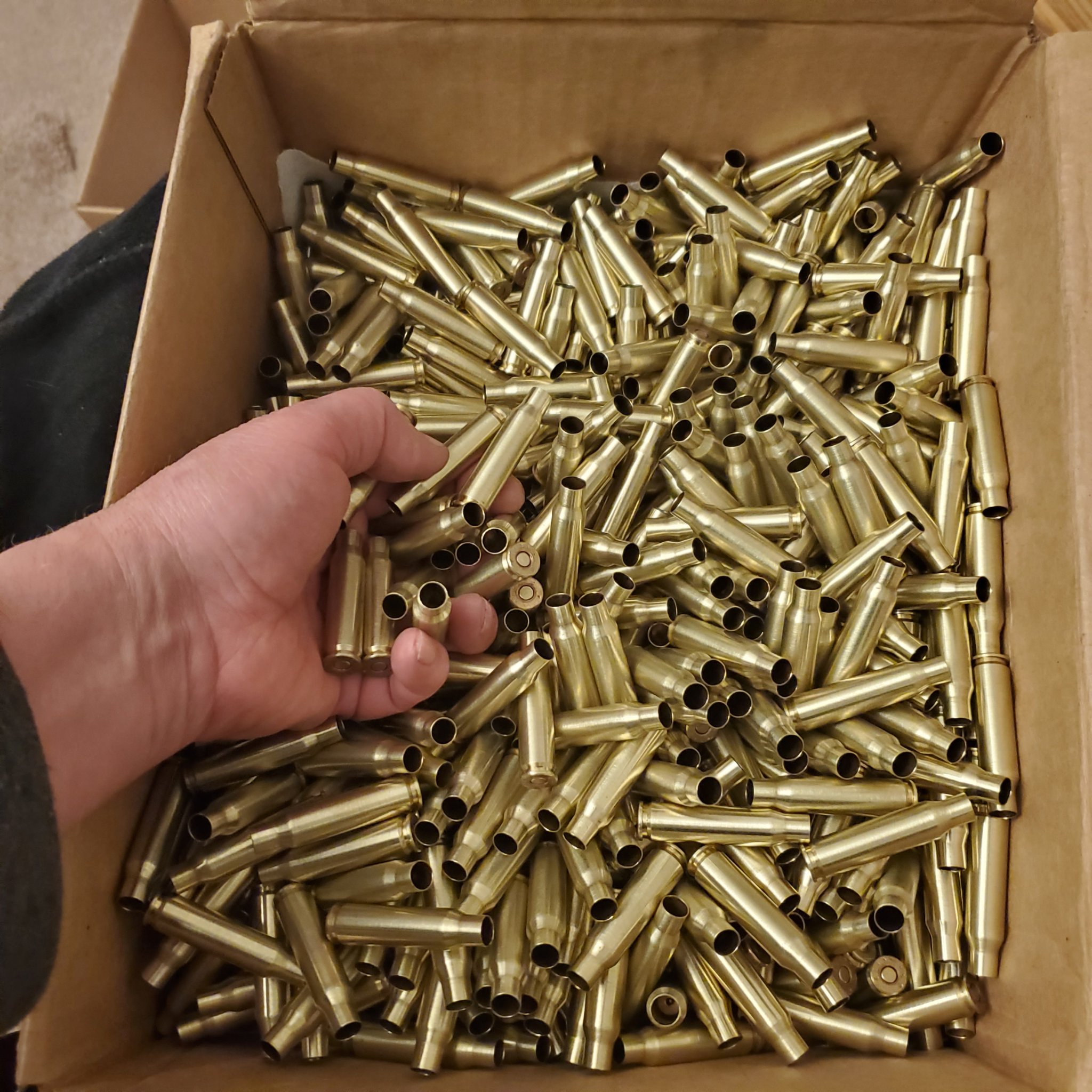

I ran the 308 exclusively many yrs ago for shooting 800 to 1400yds.
Each 308 barrel was used for 8000rds, before changing barrels.
All were hot loads of Varget, varying slightly with new barrel preference.
These barrels were not pampered, but tools heavily used, for purpose.
After 8000 rds the 26" barrel was removed...cut off the chamber area, shortened the barrel to 19" and made an AR 15, chambered it for 30 RAR out of the heavily used 308 bolt barrel.
And it shoots great, as most of the firecracking has be cut out...ready for another 8000rds, on this old barrel.
Pictured a box of 1000 rds of 308 ready to load, have already been loaded and fired.

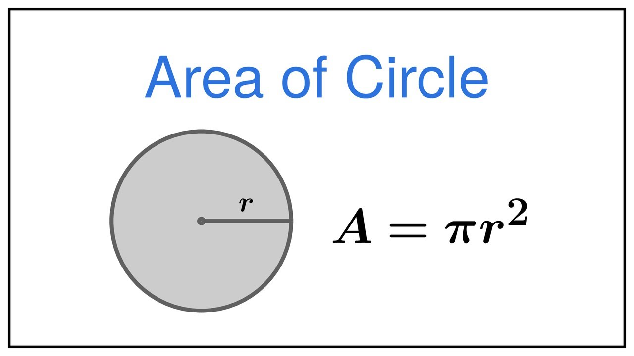

That seems incorrect. Im not sure what that upward pointing symbol means though…
The area of a circle is pi times the radius squared
Hi Makinchips208
I was away for a while and only noticed your reply now.
The "^" symbol means, "to the power off".
You are correct, I made an error. I was taught to use the following formula in school:
A = (1/4 )πØ^2
instead of the normal:
A = πr^2
Not sure why.
I mixed up the two formulas which resulted in me using the wrong formula.
Thank you for correcting me.

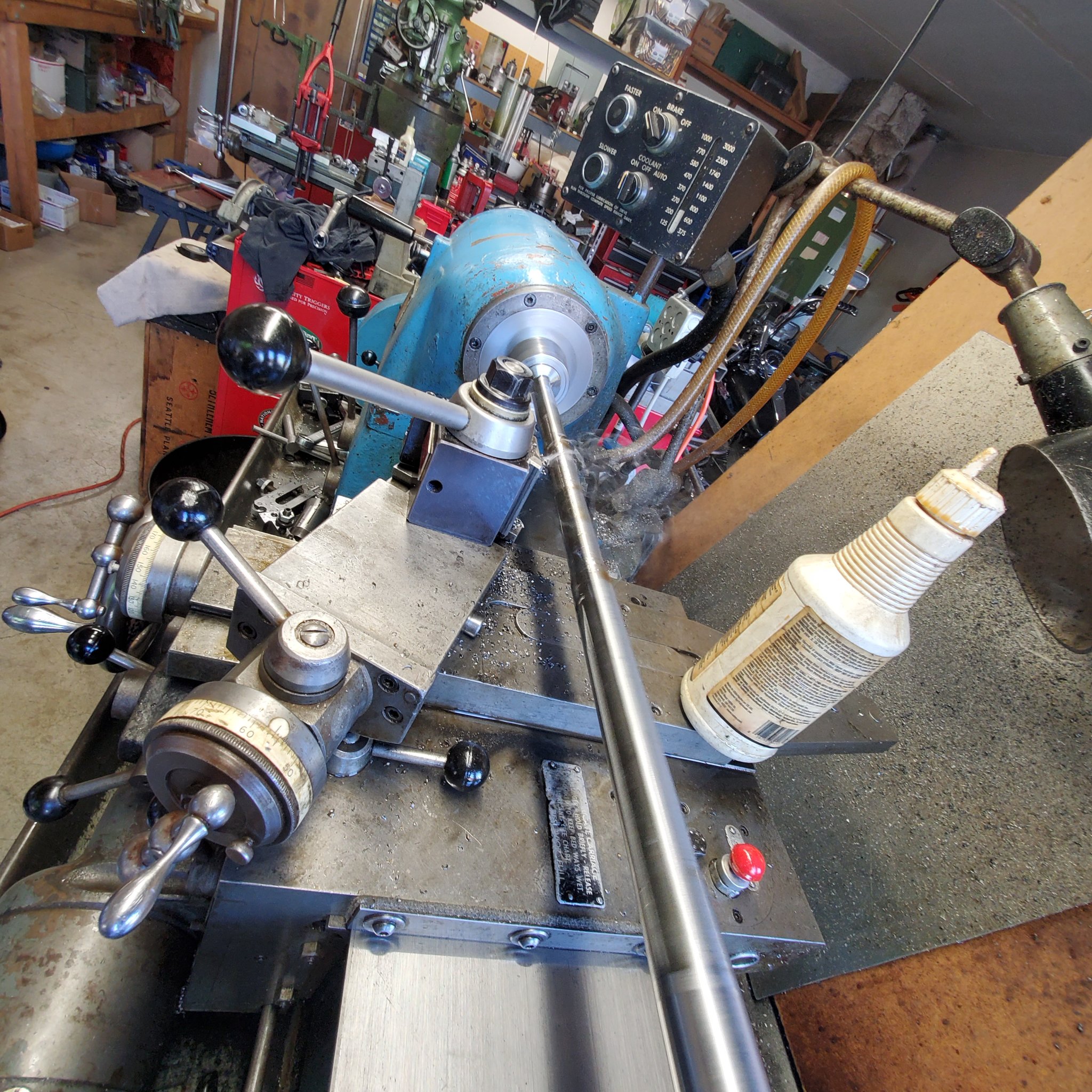

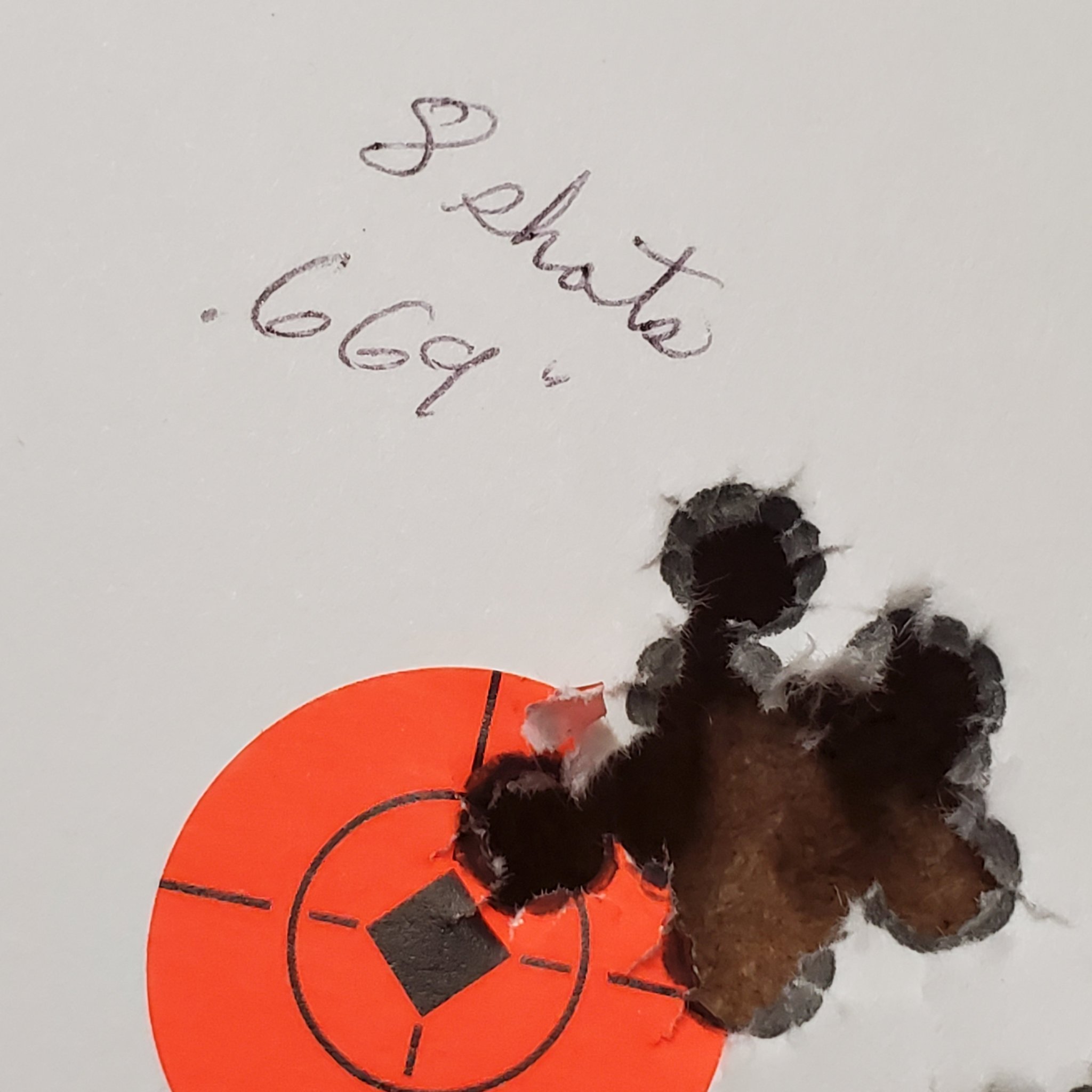

I shot 308 barrels to 8,000 rds many yrs ago, before changing.
And kept good notes on round count.
From notes:
8 -28 -05 7000 rds on 26" 308 barrel.
Shot 4, 3shot groups at 100 yds. Averaged, .239" for the 4 groups.
At 1000 yds windy storm coming in, says on notes.
1000 yds 3 into 3.75" 4, into 8.5" 5, into 9.25" for that endevor.
6-25- 05 6500 rds hit a one gallon juice bottle 3 times at 1400yds.
8 -27- 05 6900 rds on barrel 3 shot group at 1000 yds 2.422"

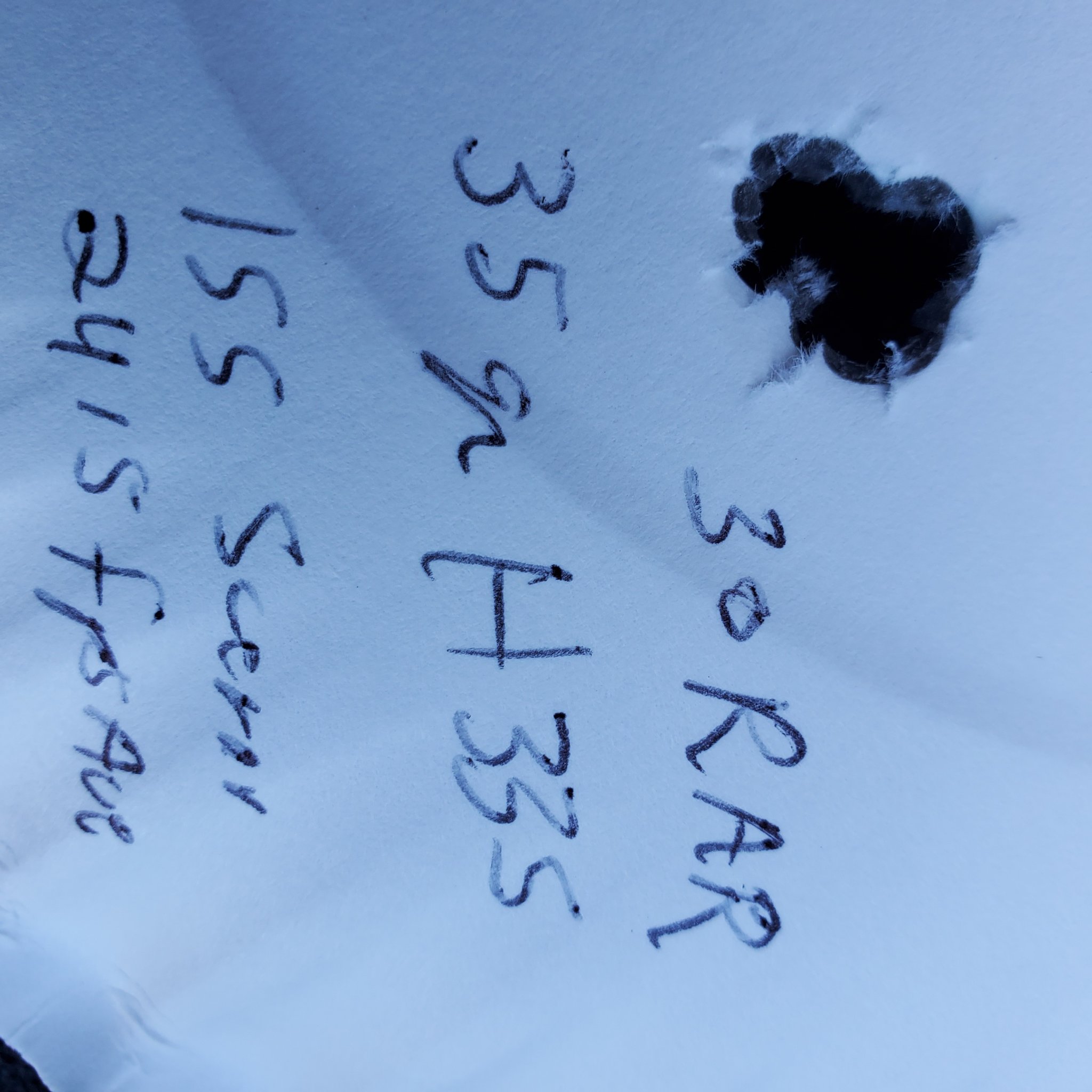

After 8000 rds I chambered a new blank for 308. It was heavily fire cracked at the chamber
After a few yrs, I took the 700 Rem barrel and turned it down and cut out the 308 chamber, and chambered the 8000 rd barrel for the obsolete 30 RAR, in AR 15 for a cost of a few hundred dollars from cheap parts. Now on its 2nd 8000 rds.
How does it shoot as a 30 RAR after most of the bad area was cut out of the 8000rd 308 barrel?
Very well with the same 155 Lapua it liked when it was a 308 barrel.
I have only 2 6.5 CMs and 8 308s.

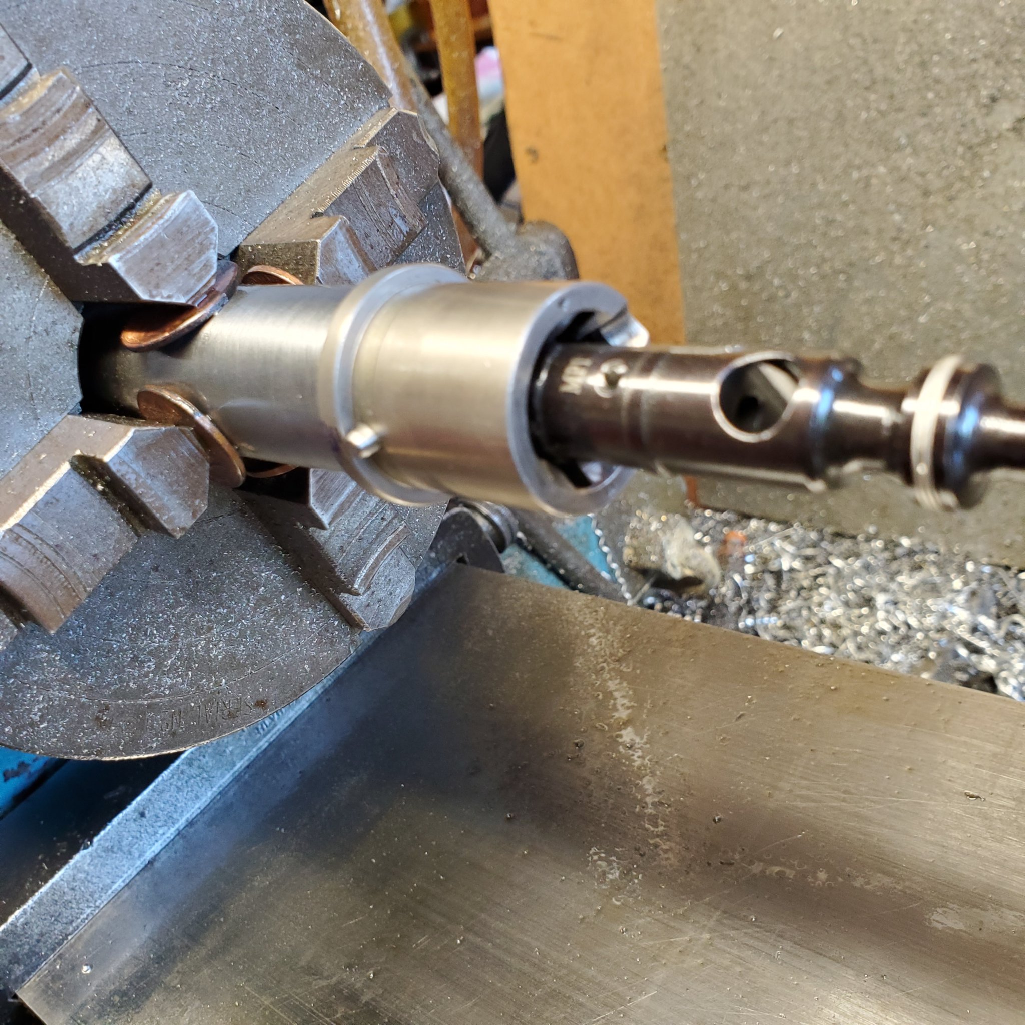

The hybrid case is the only reason I still have the 6.5 CMs. Having many decades of experience building and altering 308s I have a pretty good idea what it can do, hybrid cases, to LC cases 16 to 30 inch barrels, 12 to 8 twists, LA, SA, and autos. It's still a contender with excellent performance like 200 gr 715BC SMK at 2856 fps, with Lapua brass or over 2900 with hybrid cases.
