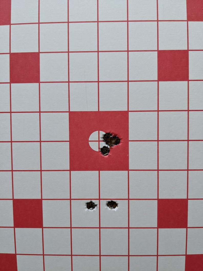

    It actually shoots quite well. I sold off my FGMM because I was getting tighter groups with it. Behind the Chrono on my 20" I was getting single digit SD's ~ 8. Out of the fresh new proof Straight Jacket barrel - 2 to see where the scope was dialed, then 5 in the center. 1/2" group at 104 yards.
