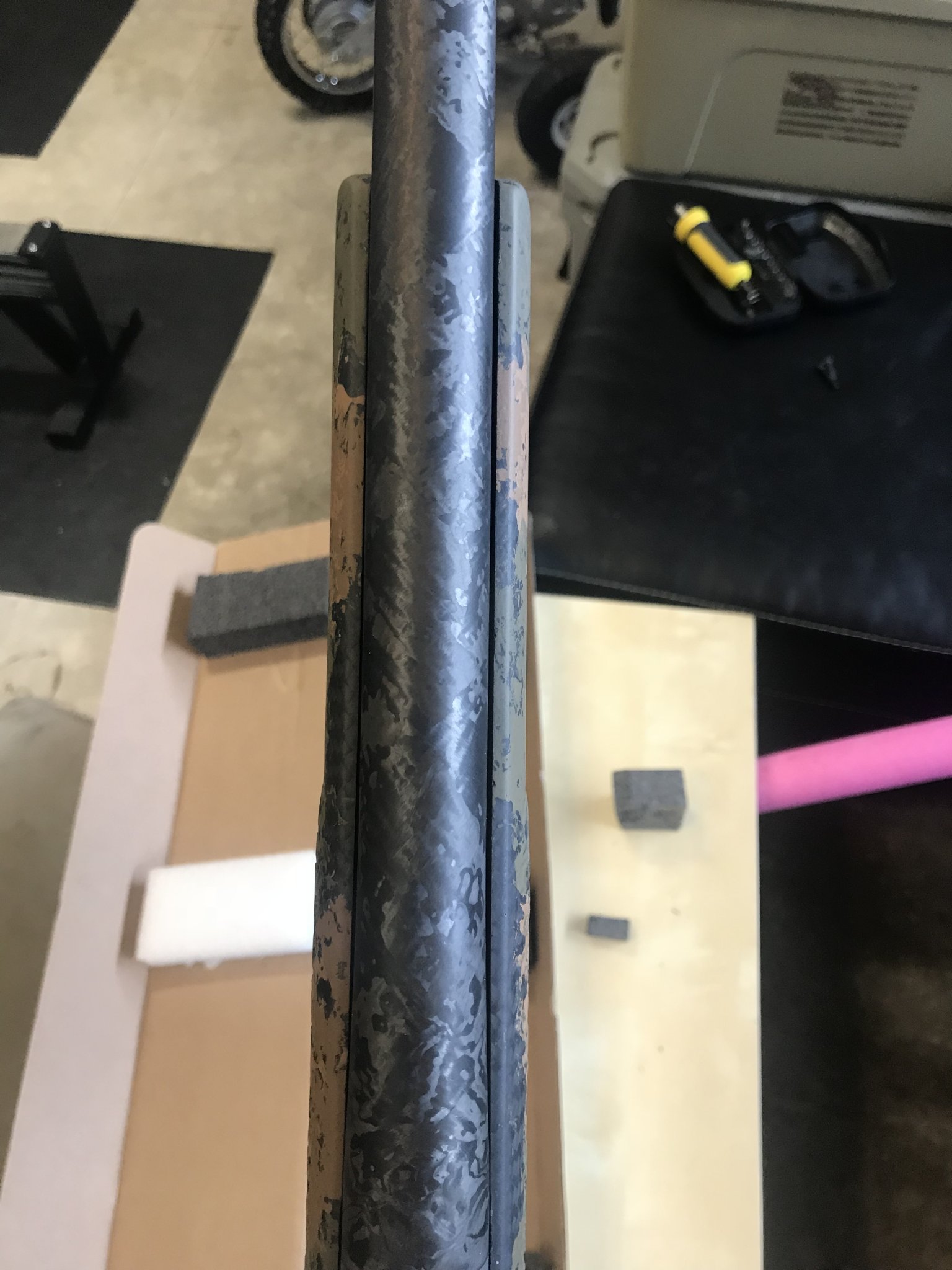

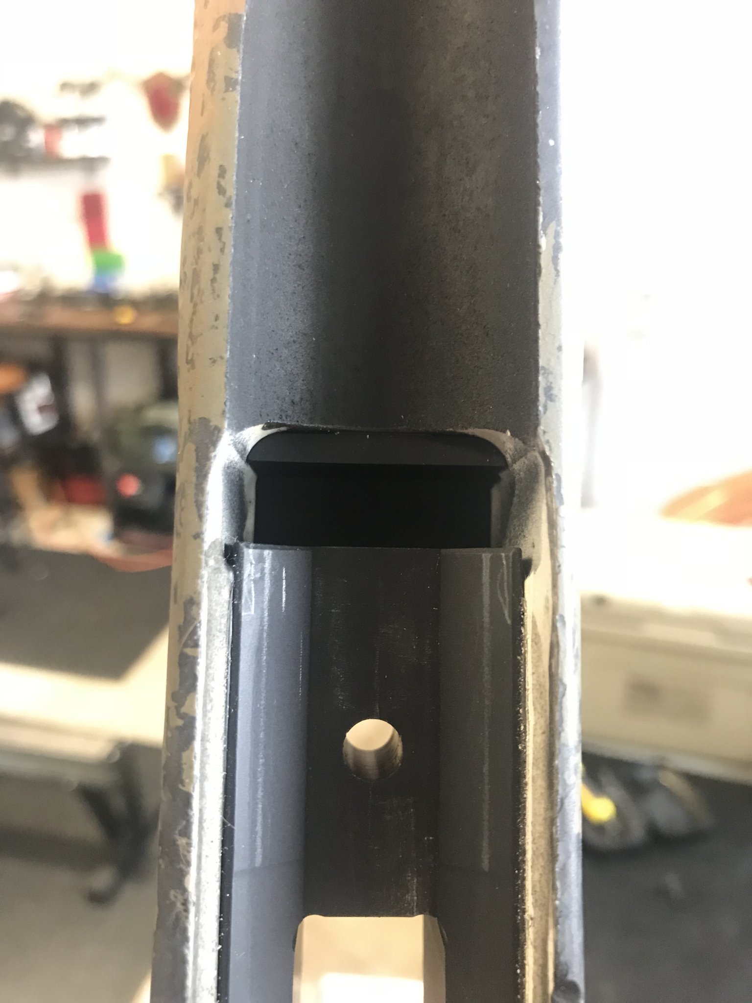

I took it all apart today for shipping and looked at how the mini chassis is bedded into the stock and it’s pretty clear to me that the mini chassis is not bedded straight in line with the stock
These pictures show how the barrel aligns when BA is installed. The other shows the slight cant to the left of the mini chassis

I had the same issue with both the Manners stocks I purchased (EH-2 and EH-3) and just had Travis at TS Customs install pillars and bed them. A little frustrating given the price point of the stock. However, both are extremely nice stocks all said and done.
It’s definitely crooked. If you look at the front of the chassis before the lug it meets the stock on the right and has a slight gap on the left. If you look behind the recoil lug there are 2 notches in the stock. The right of the chassis hangs out about 1/32nd further. Not a lot but enough to push that barrel to the left side. The barrel does not sit straight in the channel it starts with slight gap on the left by the action then gets smaller as it goes down the barrel
The mini chassis isn't built by Manners. It is installed in the stock by Manners. These are not custom fitted stocks. If you want a fitted stock, you need to get a blank and send it to builder. That is why true customs cost so much, all the stock fitting and attention to detail. Taking 3k in parts and bolting them together doest not make a 5k custom rifle. Manners wants your B/A so when they open up the channel, they can make sure it fits. They are not going to rebuilt the stock, or remove the mini chassis. They will open the barrel channel and re paint it.

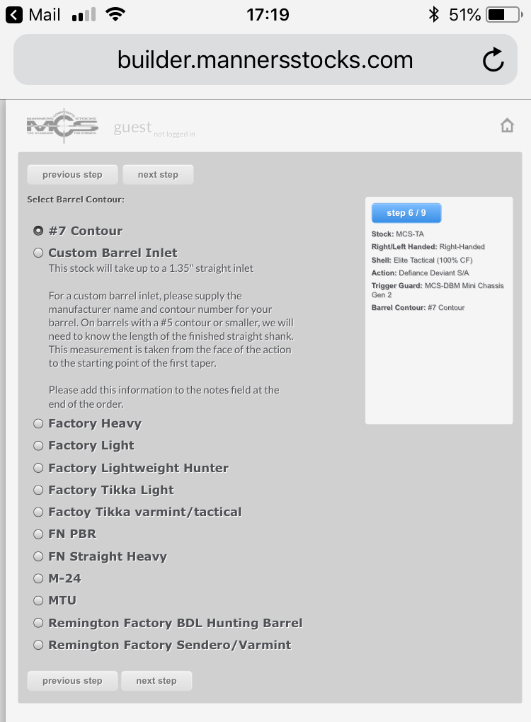

The one I have on order is my third as well. I have had problems with the first 2. Not sure why I thought it was a good idea to order another but I’m having a defiant with proof Bull Barrel built. The TA stock in the stock builder said it could fit a 1.35” Barrel so I went for it. Looked at the description of it today on the website and it says it will only take up to 1.125” Barrel which is too small for the 1.25 bull. Then they sent me the confirmation which means they didn’t catch it.
Not sure which one is correct
What did you tell them to prepare the barrel channel to? I’m not seeing in your photos anywhere that states 1.125” max.
I told them “proof research Bull Barrel 1.25 no taper” in the confirmation they wrote proof research sendero heavy 1.25. The second picture that I highlighted states it can go up to a #8 Barrel which is 1.125

Got an email back from manners this morning saying that the TA will allow a 1.25 Barrel, which contradicts their description, so we will see, I’ll let it get built and if there is any problem whatsoever dropping another defiance/proof BA in it it’s going back to manners for a refund, no more playing their games. And yeah I can’t believe I don’t have my gun yet either. At first it was just annoying to send them 4500$ worth of my shit now it’s just plain ridiculous that I don’t have it back for a hunting season that I built the rifle for when I was assured it would get turned around in a week...
