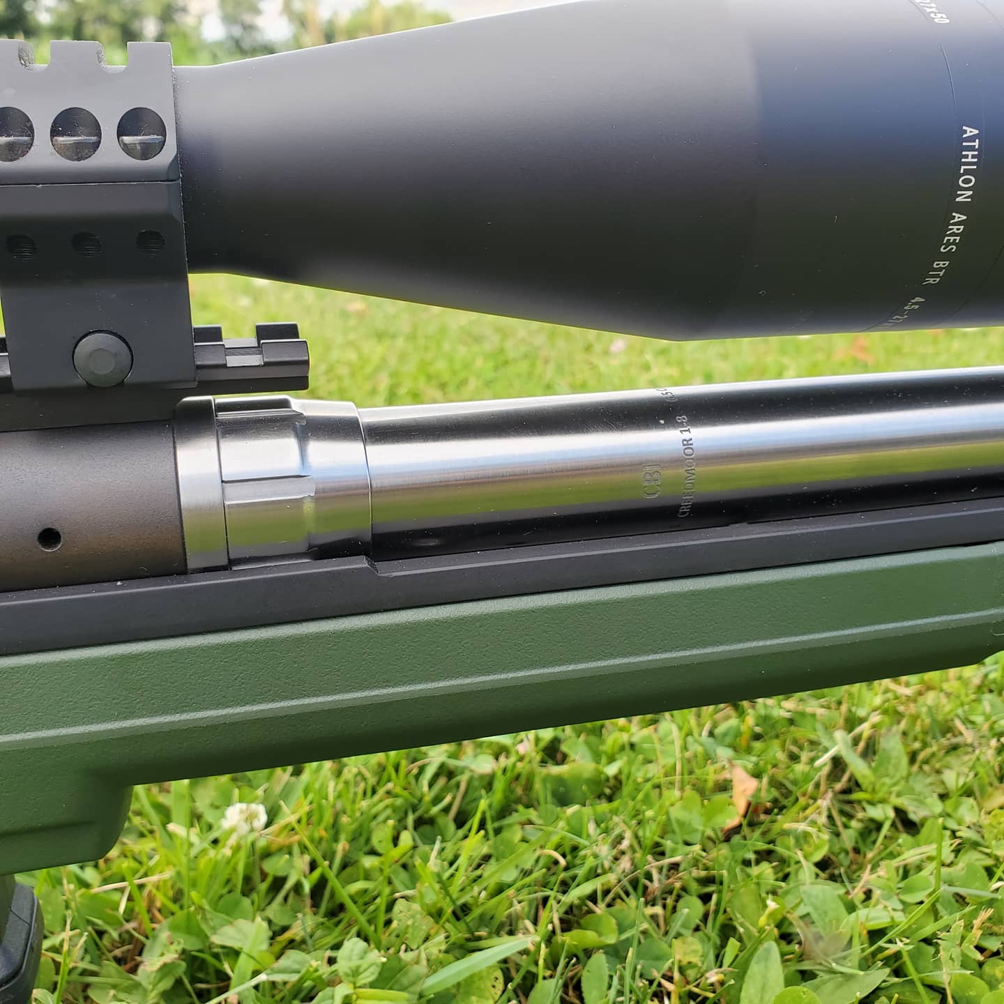

I think it is an outstanding option for 700 guys. I do not object to the asthetics at all and the install is really straight forward. It gave me the option of piecing the rifle together over time using a stock ADL Varmint as a base and then adding the barrel as the last big piece that I could do myself. I can also recommend Jim at Northland very highly!

I've done two Remage builds on factory Rem 700 actions with Criterion prefit barrels from Northland Shooter Supply. Both are in KRG Bravo chassis and shoot sub MOA. It's a straightforward system that is easily user serviceable with a few tool and a GO gauge.
