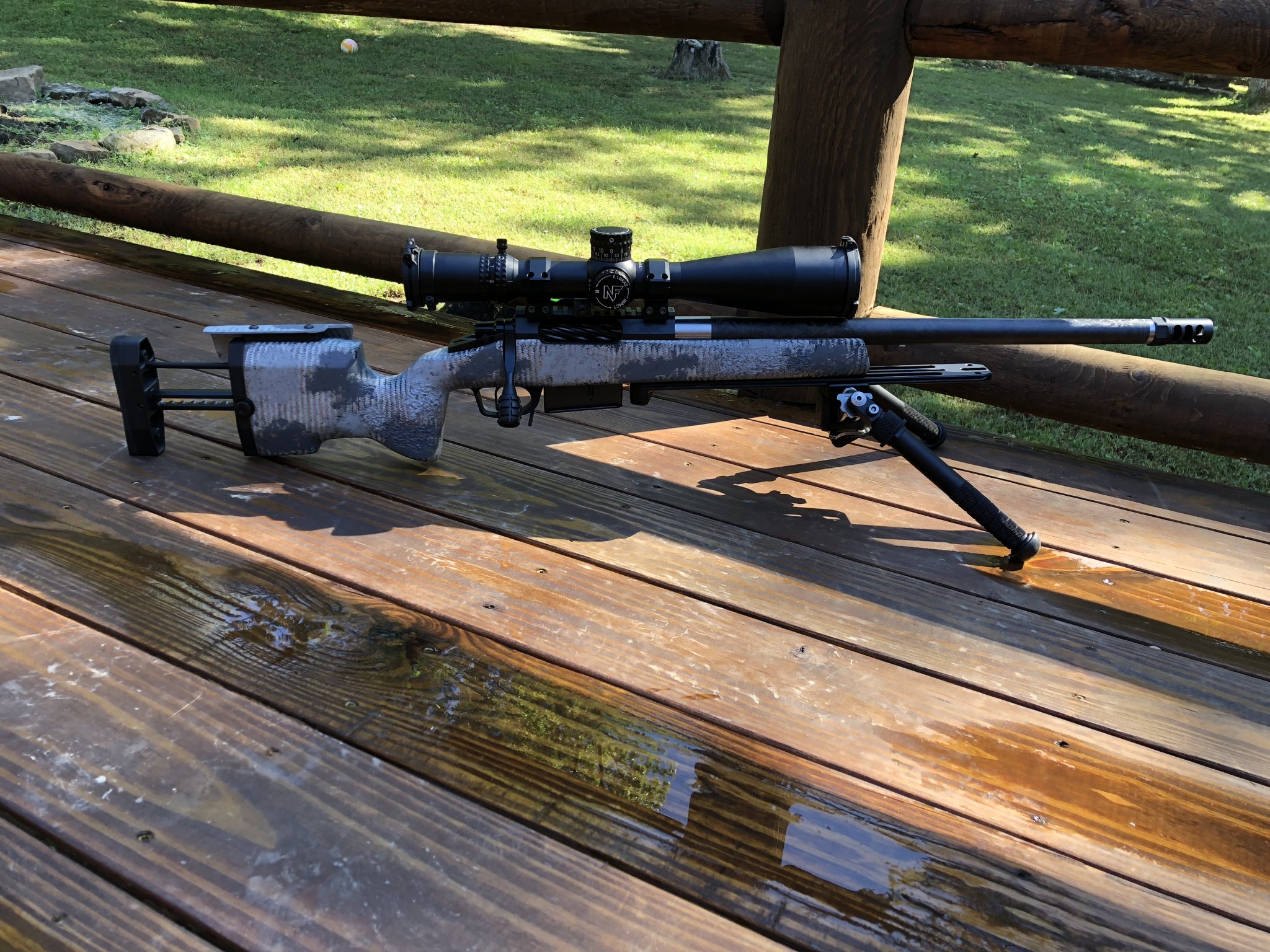

Hi, I am having a coworker build me a custom .260 Rem bolt gun. I am having some trouble narrowing down the barrel choices. The build will be a 700 clone with an HS Precision M24 stock. I thought I had it narrowed down to a Bartlien medium Palma 24” until I decided to purchase a Thunderbeast ultra9. Now I’m leaning towards a Proof Research 22” or 20” Sendero. Would love any feedback or opinions on this setup. Thanks!
Mostly overall length. Once the suppressor is added it’s going to be a long sob. I am very new to the civilian side of long range precision. I tend to think on the tactical side of application due to my former career as a soldier and my current career as a Fed. As a soldier I have used the M24a2, M24a3 M24e1, M110 and MK11 mod 0. So my experience is mostly narrowed down to 7.62mm and 5.56mm.
When shooting at the range, I was never encumbered by a 24" barrel with a can.
As noted, tactical operations with same led me to cutting the barrel back.
That being said, if you are not going to use this rifle in a "professional" manner, there is no reason not to stick with a 24" barrel.
It will help getting those 140 class bullets up to speed.

ive now picked up an ai ax and have a 260 barrel on it at 20”. waiting on its can. have a 24” on order. have only done one day of initial load testing on the 20” (mainly to sight in) so icant speak yet to final speeds. and the supressor isnt in yet. but i do expect to loose some velocity on it vs a longer barrel suppressed. but at the end of the day that loss will be fairly negligable at distances within my shooting ability.
