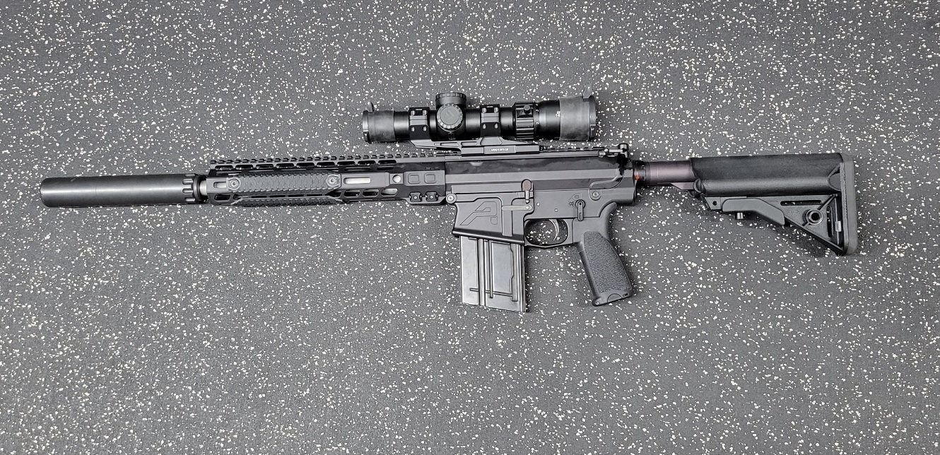

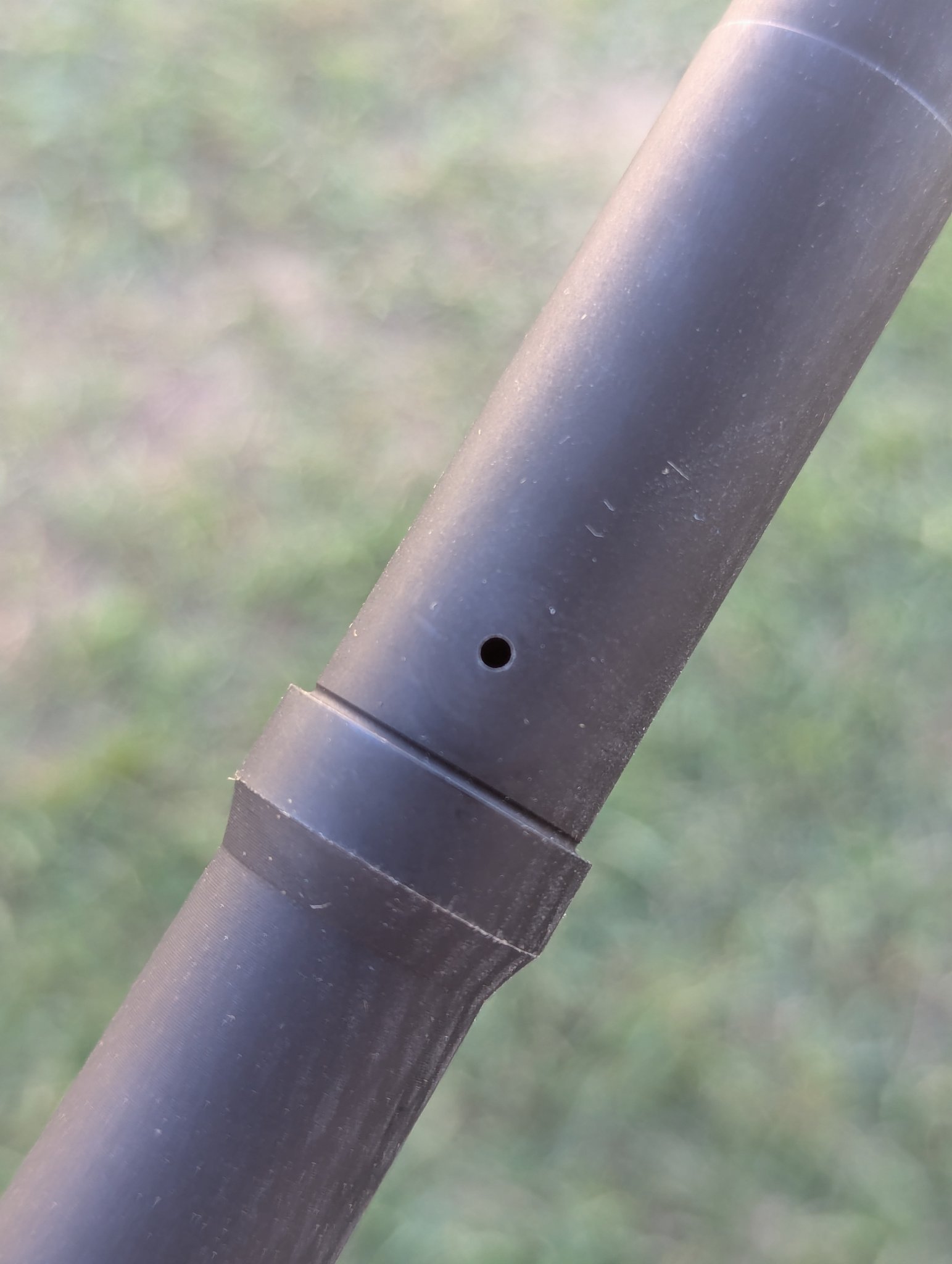

I just picked up a 13" mid length Criterion from Midwest Industries, 10 twist, black nitride finish with an M118LR spec chamber. Not sure if they're specifically made by Criterion for Midwest since I didn't see anything on the Criterion site about them. It's a nice looking barrel for the money, I'm waiting on a new receiver set before I'll be able to give any feedback on how it shoots. Also going to pin gauge the gas port later this week to get a better idea on how it should be gassed.

It's unlikely you will see a port that small unless it is custom spec'd. The 12.5" barrel in the picture above started as a 16" MLGS and has a .0715 port. That is a pretty standard size port, and considered correct, despite being too large. If you're planning on a custom barrel you should be able to spec your own port. If I was going to run a 14.5" barrel I'd stick with a RLGS.

For reference my Criterion 13" mid length gauged at .076 on the gas port... Might be a good thing I got a Rubber City adjustable gas key BCG since it will be run suppressed 99%of the time. Don't believe a Superlative GB will fit under my Centurion CMR so I'll try the gas key route first.

You'd have to ask them. Probably either AR15 mid length or AR10 carbine length. Frankly I'd go custom 14.5" RLGS. 308 needs less dwell than 223; too much dwell too soon and it'll eat your brass. 12.5" MLGS is pretty good for dwell, suppressed/unsuppressed, LMOS/FMOS, top of the max pressure. All of it works.
