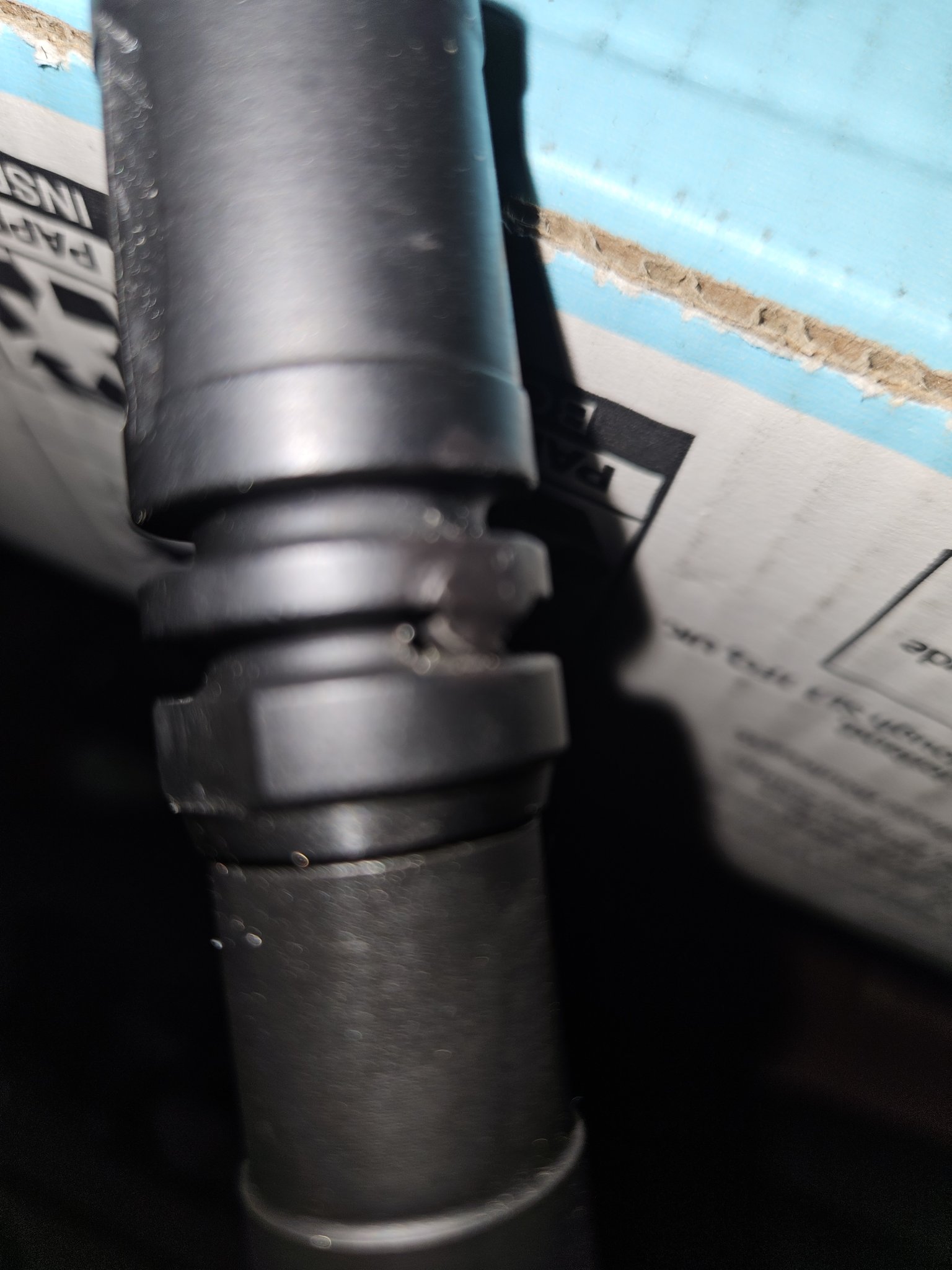

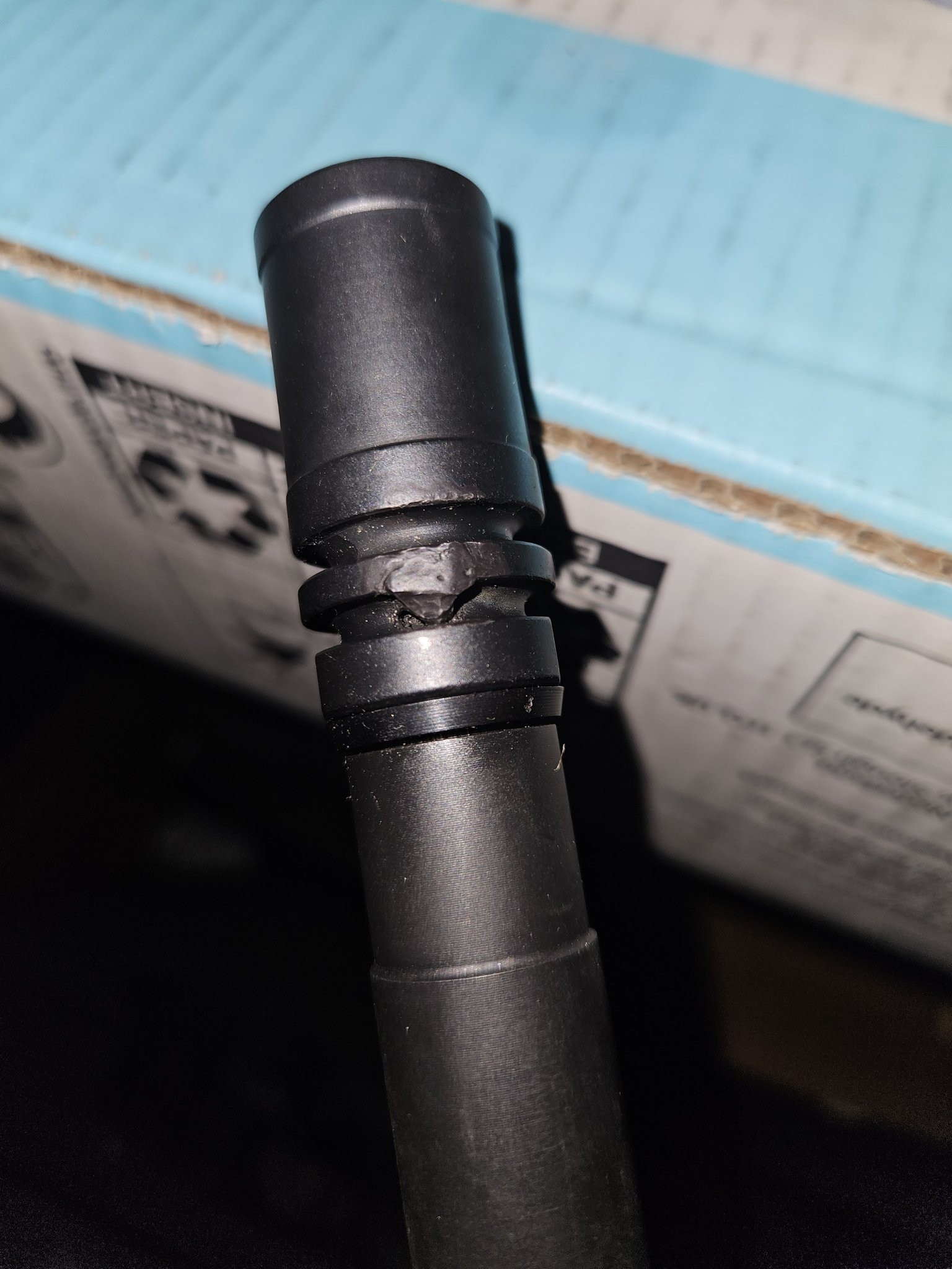

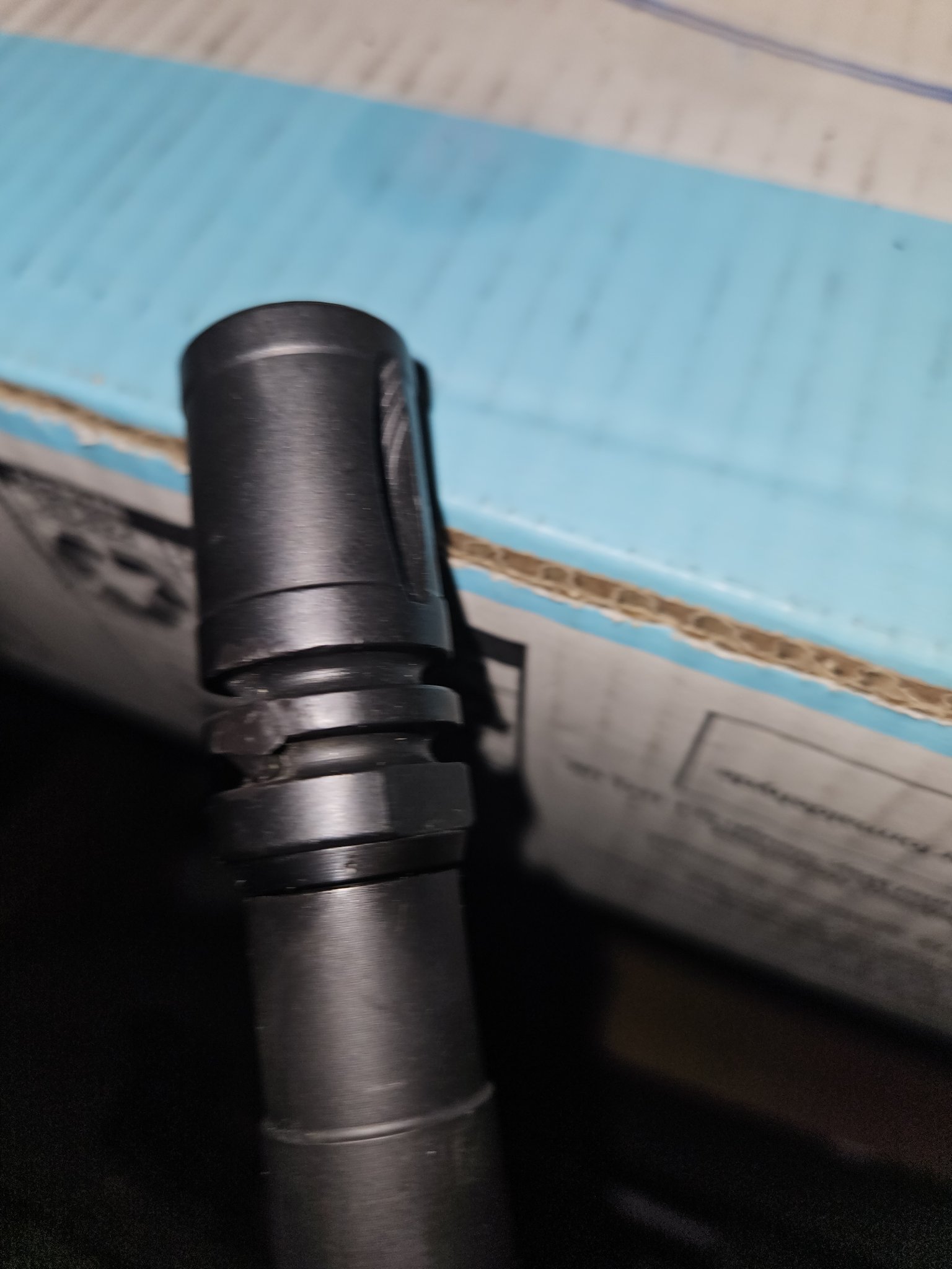

    D Wilson or ADCO if you're planning on shipping it out to get done. Whatever you do, if you go with a local guy, make sure he knows what he's doing and uses TIG. If not, this is what might happen:
