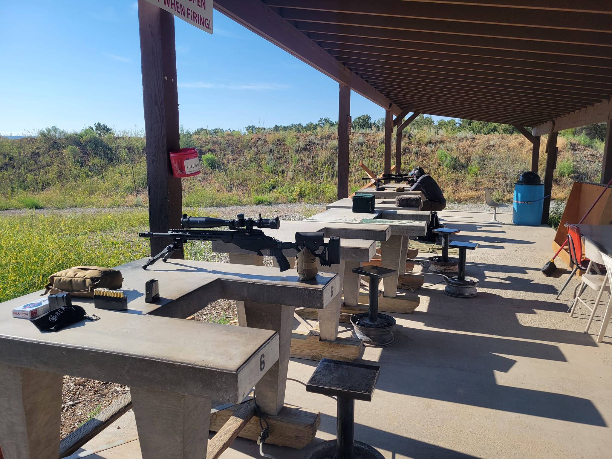

I appreciate the insights and suggestions...that's a big help and part of what I was also wondering. Is it even worth it.
I like the current setup for a bench rifle, but after getting a 1000yd shot pretty easy with it, I now want to build up something for the mile.
I'm considering just building up a lightweight MDT HNT26 6.5 PRC for that application, that could also be used for hunting. I'm not that into hunting anymore (I live in Golden, CO), but I would like the option down the road if I'm investing that kind of money into it.
A shooting pal mentioned, why not try to just convert the Tikka over as a dedicated bench rifle (longer barrel more capable caliber), since since I'm pretty much there with the chassis and optic setup. I know that may not be ideal, which exactly why I wanted to post it to this crowd.
I like the Tikka .308 and don't have hard plans to sell it, but that is also an option. I have about $4k in it with the optic.
I truly appreciate the replies and insights shared by you guys. Semper Fi!
