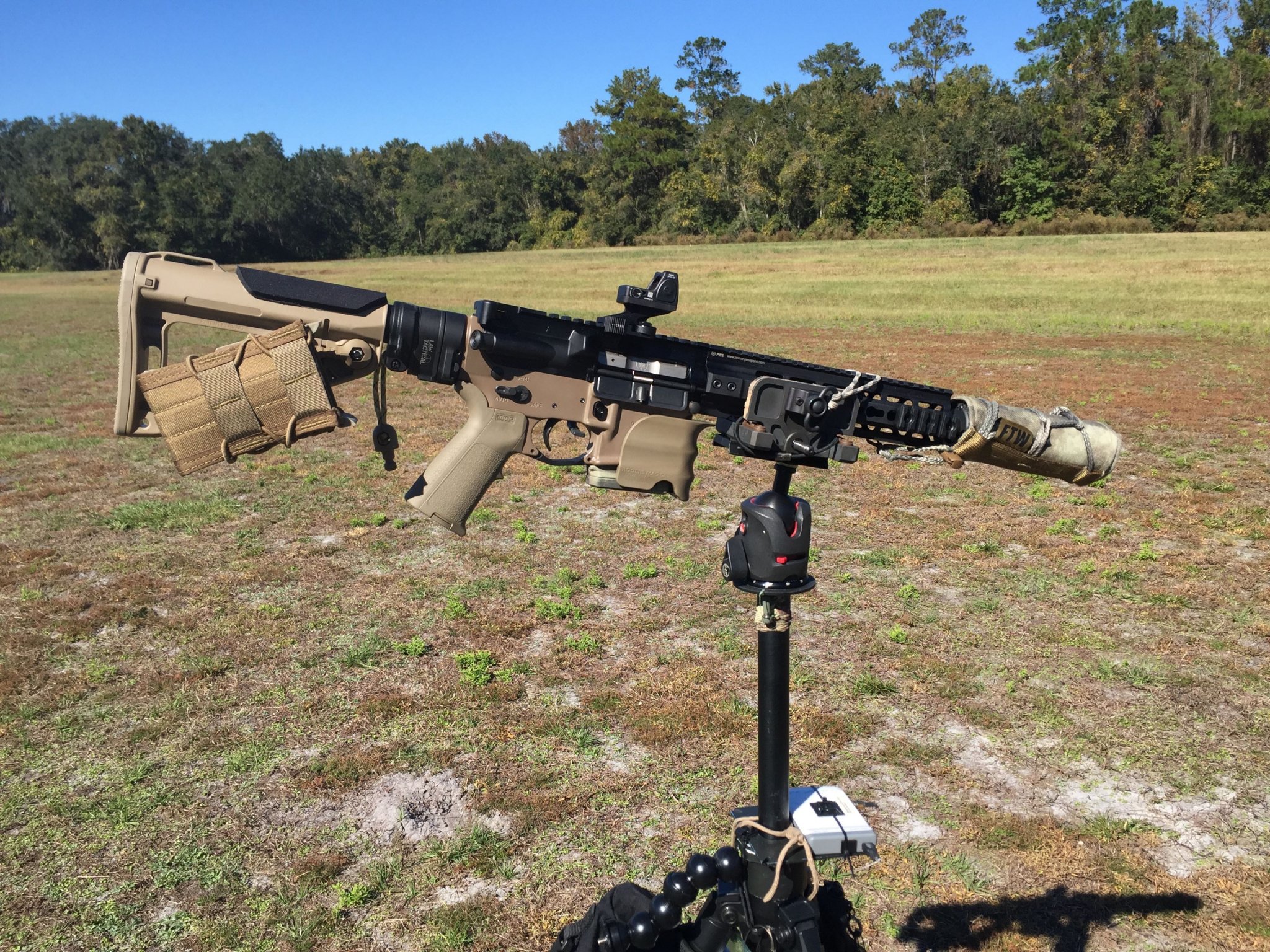

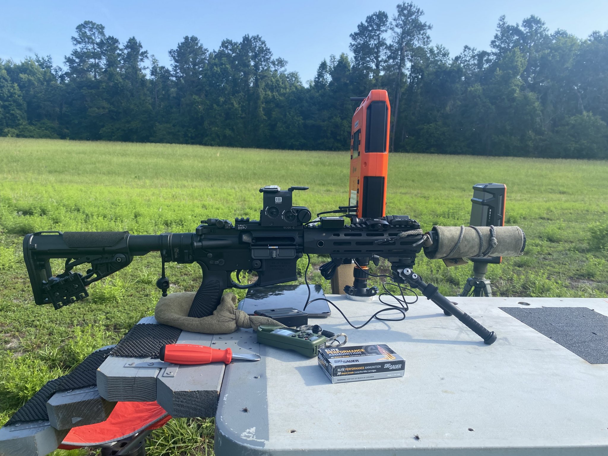

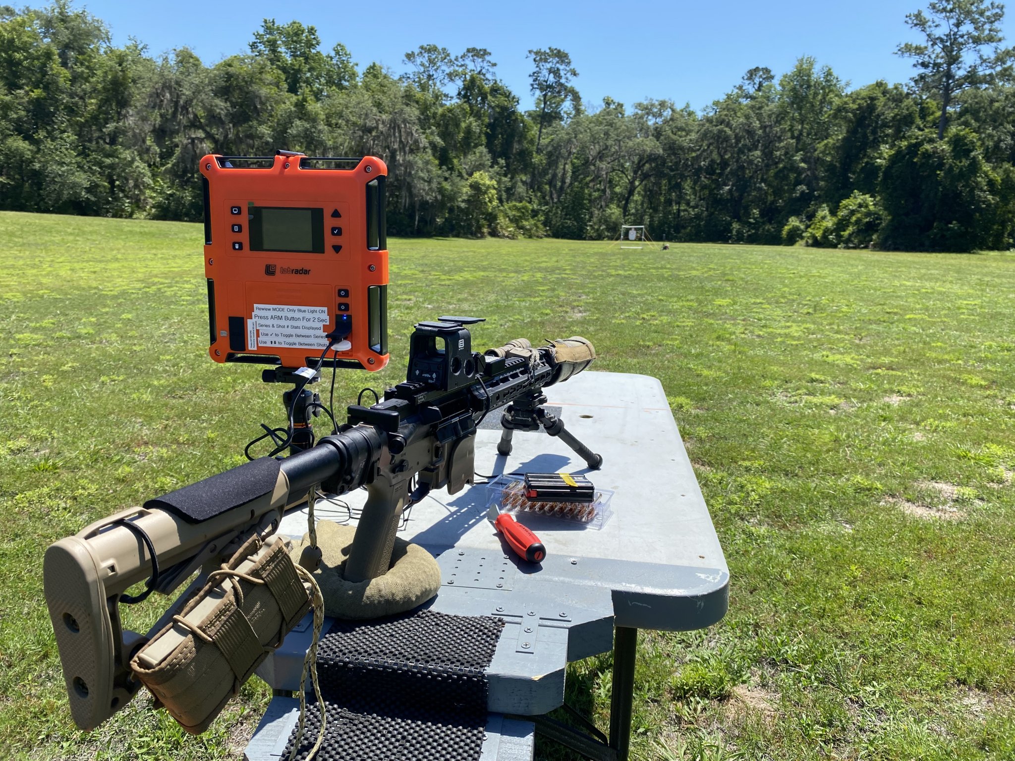

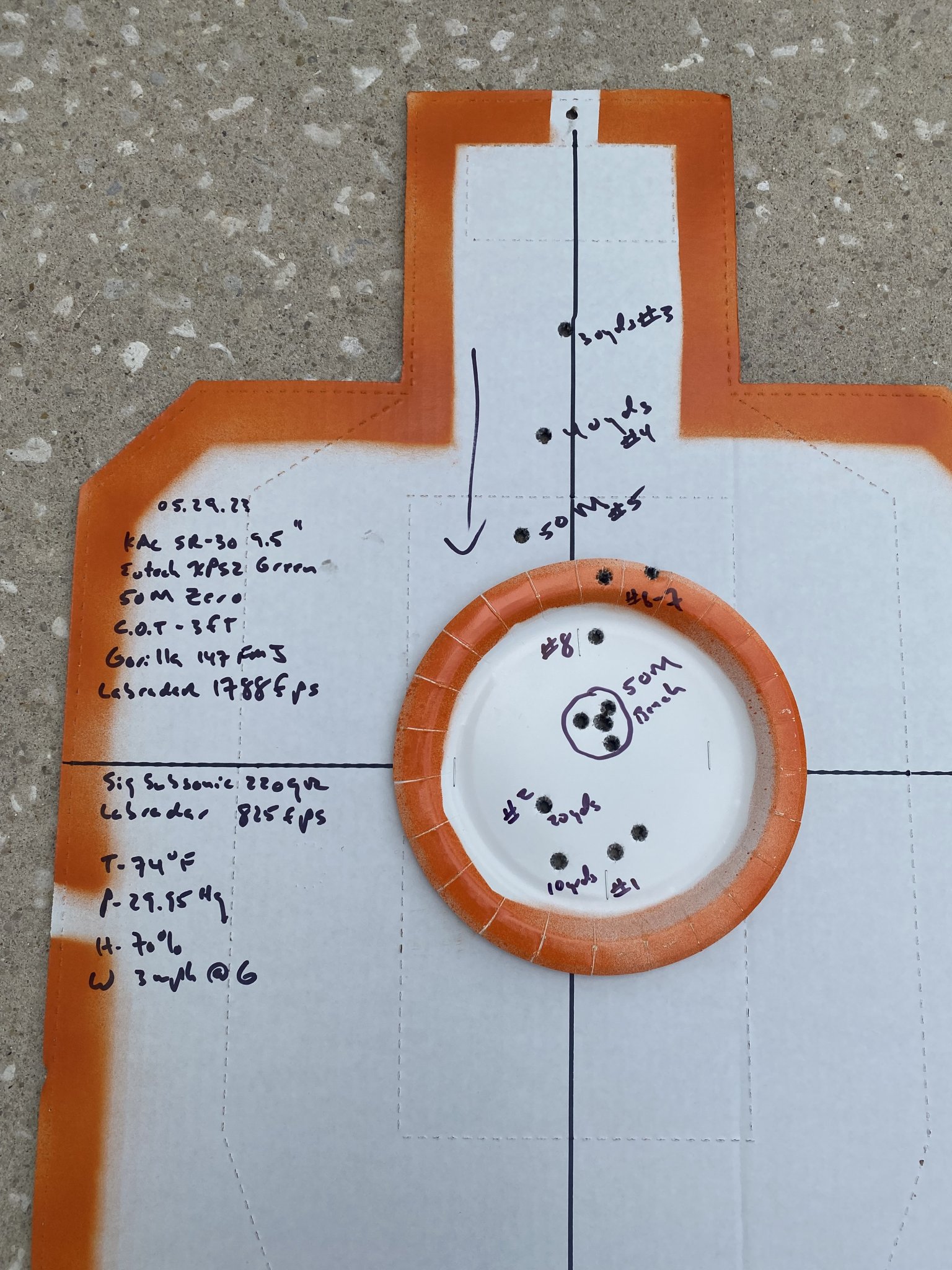

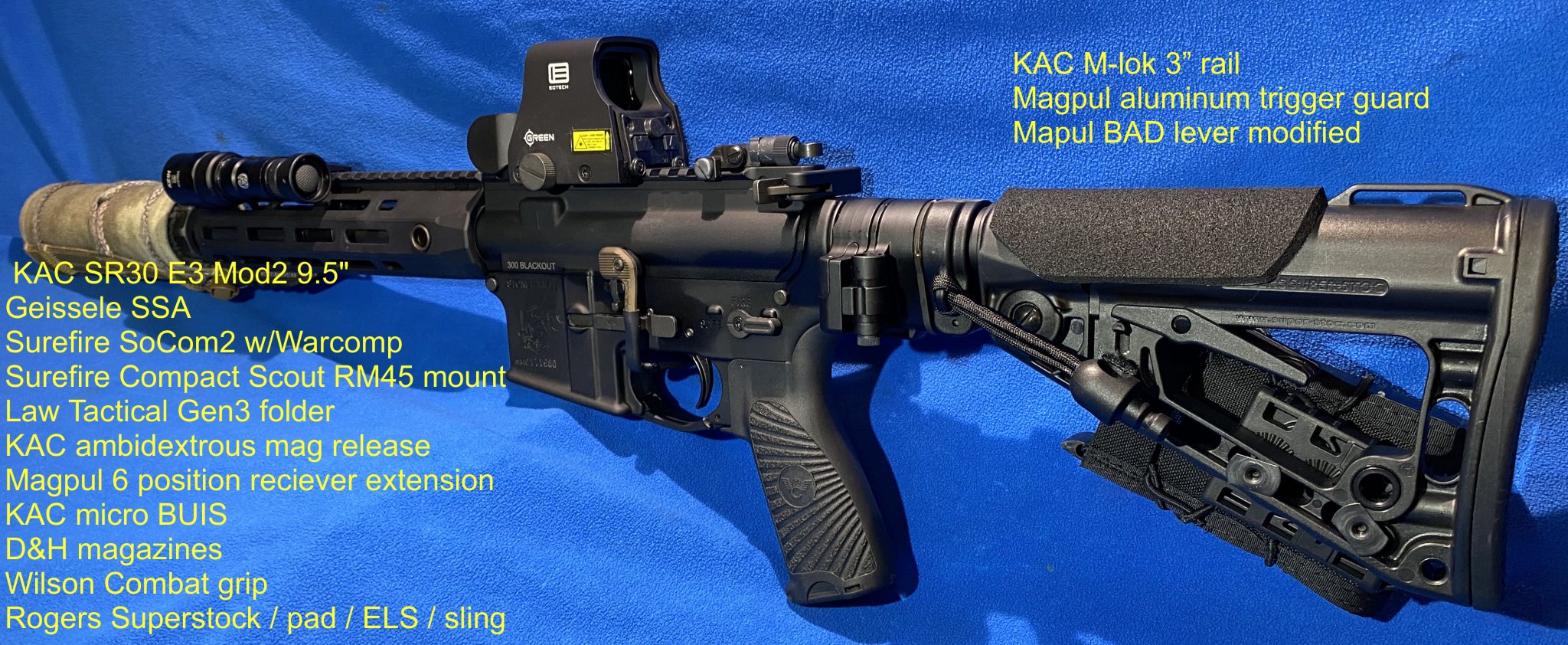

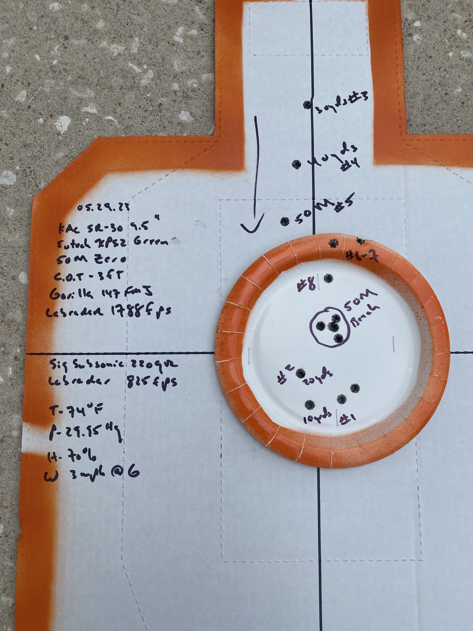

This is my 9.5" KAC SR-30 @ 50 meters. Don't reload. Usually Gorilla or Black Hills supersonic, Sig subsonic. I don't believe there is any inherent over all advantage to a shorter barrel, particularly if it is configured on a folder receiver. Not super-accurate, but his is the best I could achieve with factory ammo and I can pull a trigger followed-thru straight back.

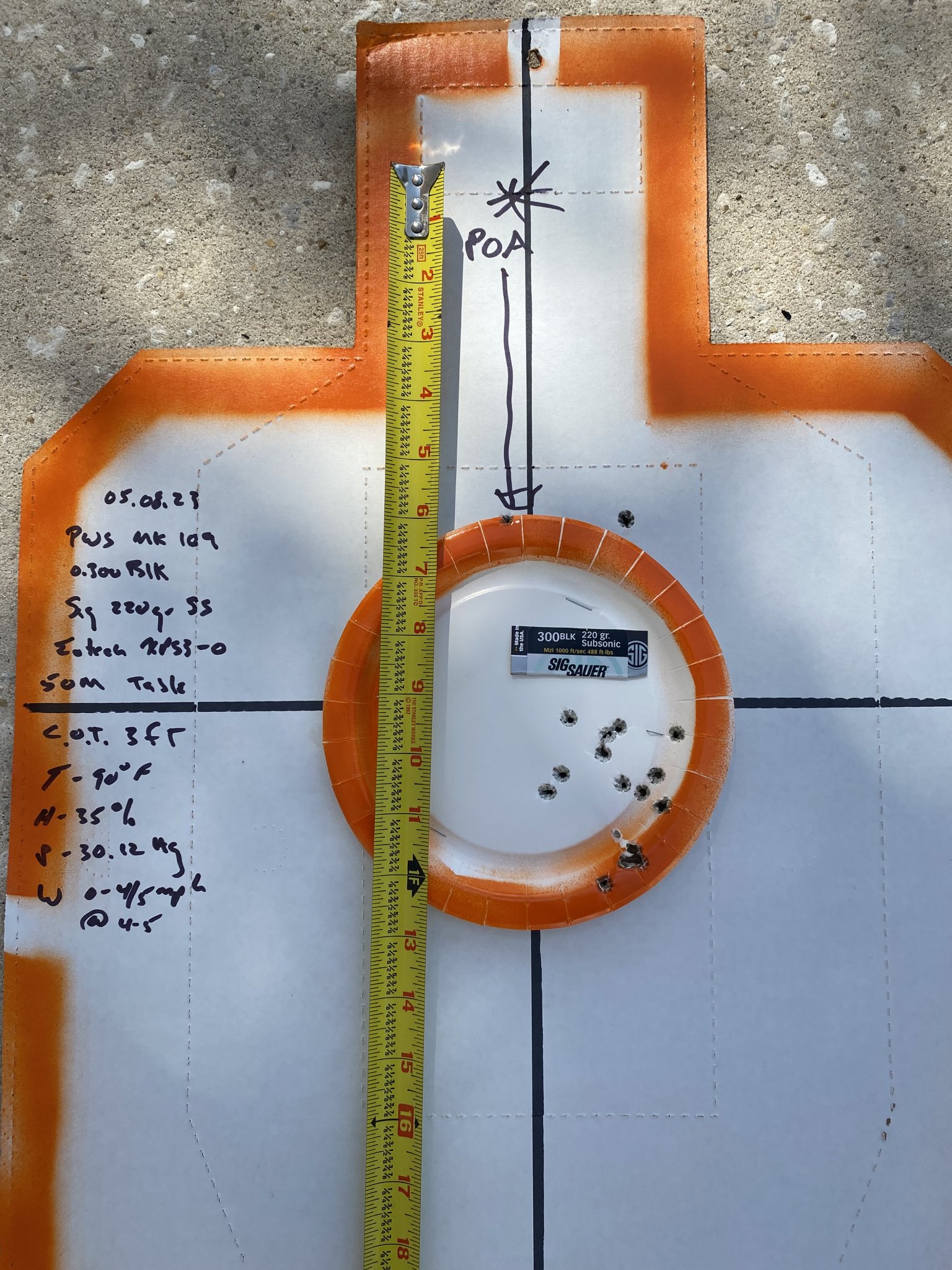

This is my 9.5" KAC SR-30 @ 50 meters. Don't reload. Usually Gorilla or Black Hills supersonic, Sig subsonic. I don't believe there is any inherent overa all advantage to a shorter barrel, particularly if it is configured on a folder receiver. Not super-accurate, but his is the best I could achieve with factory ammo and I can pull a trigger followed-thru straight back.

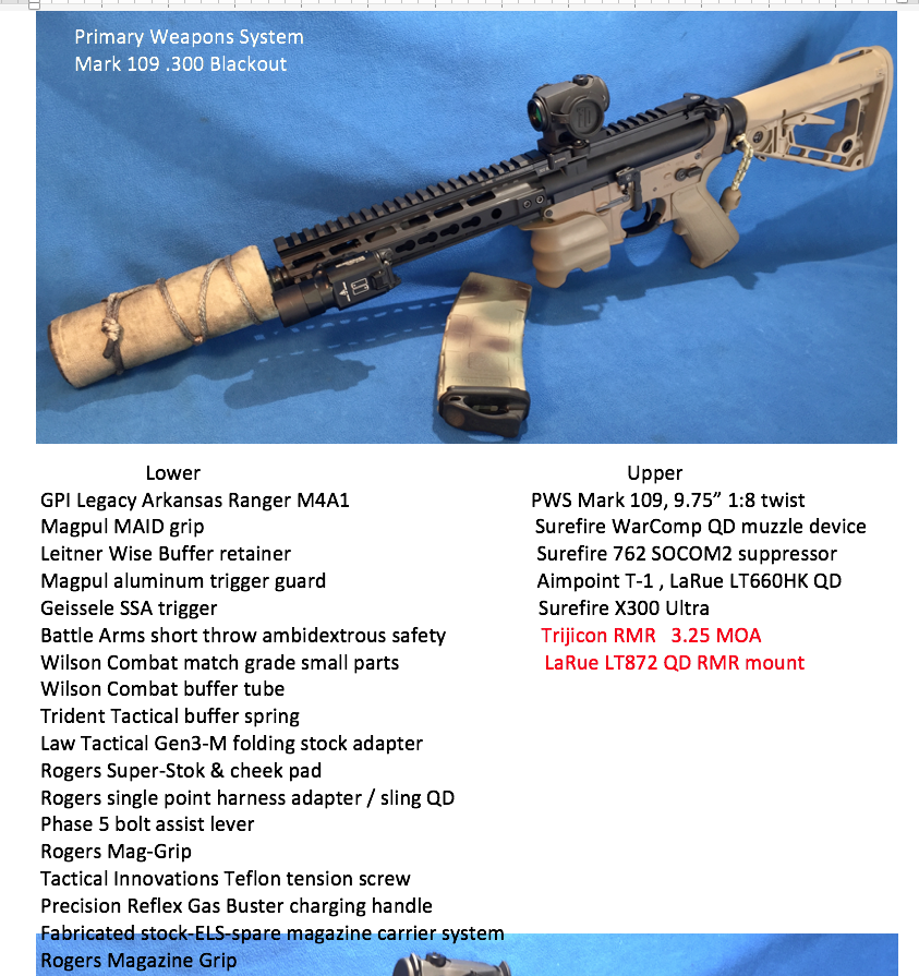

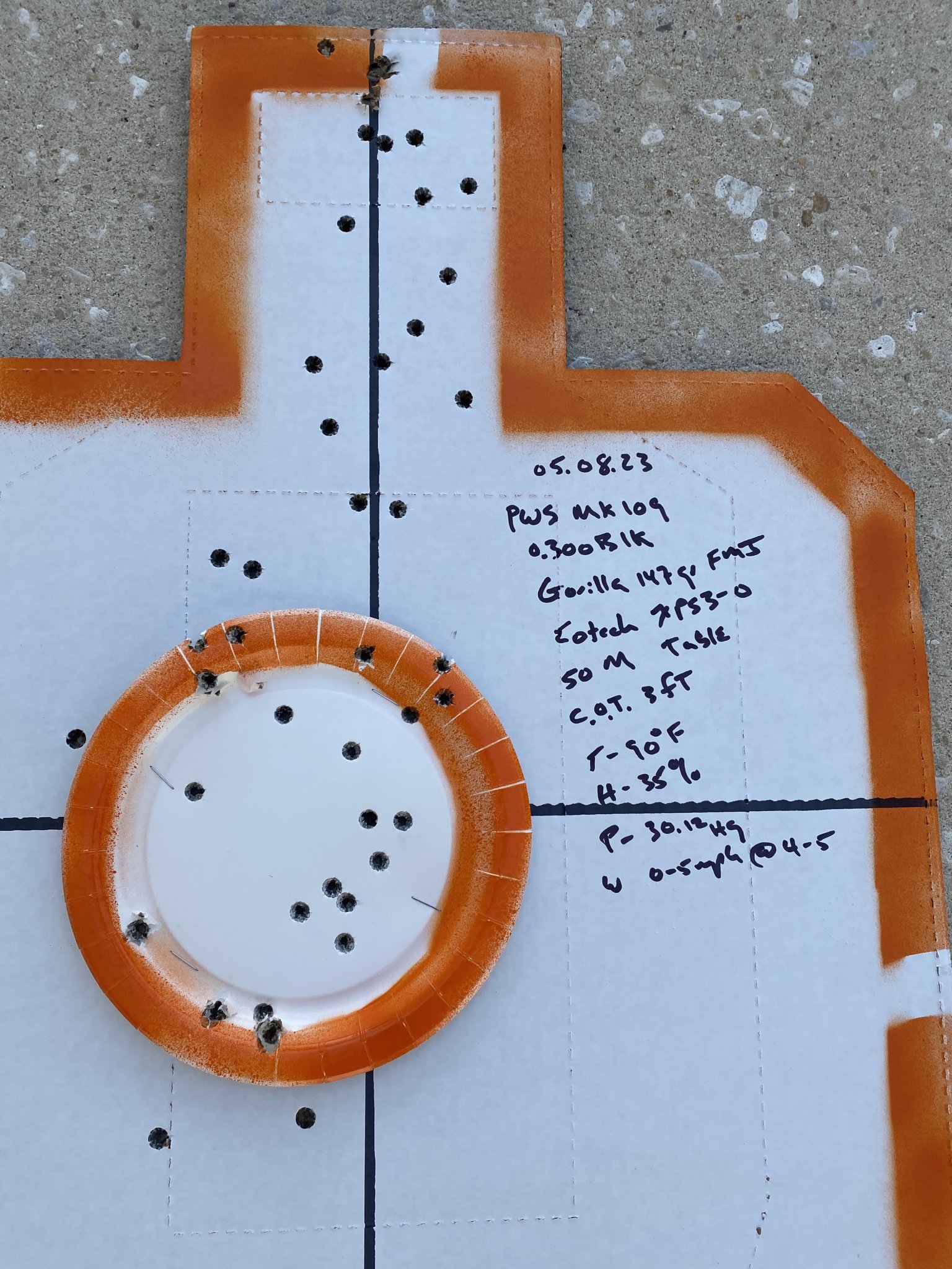

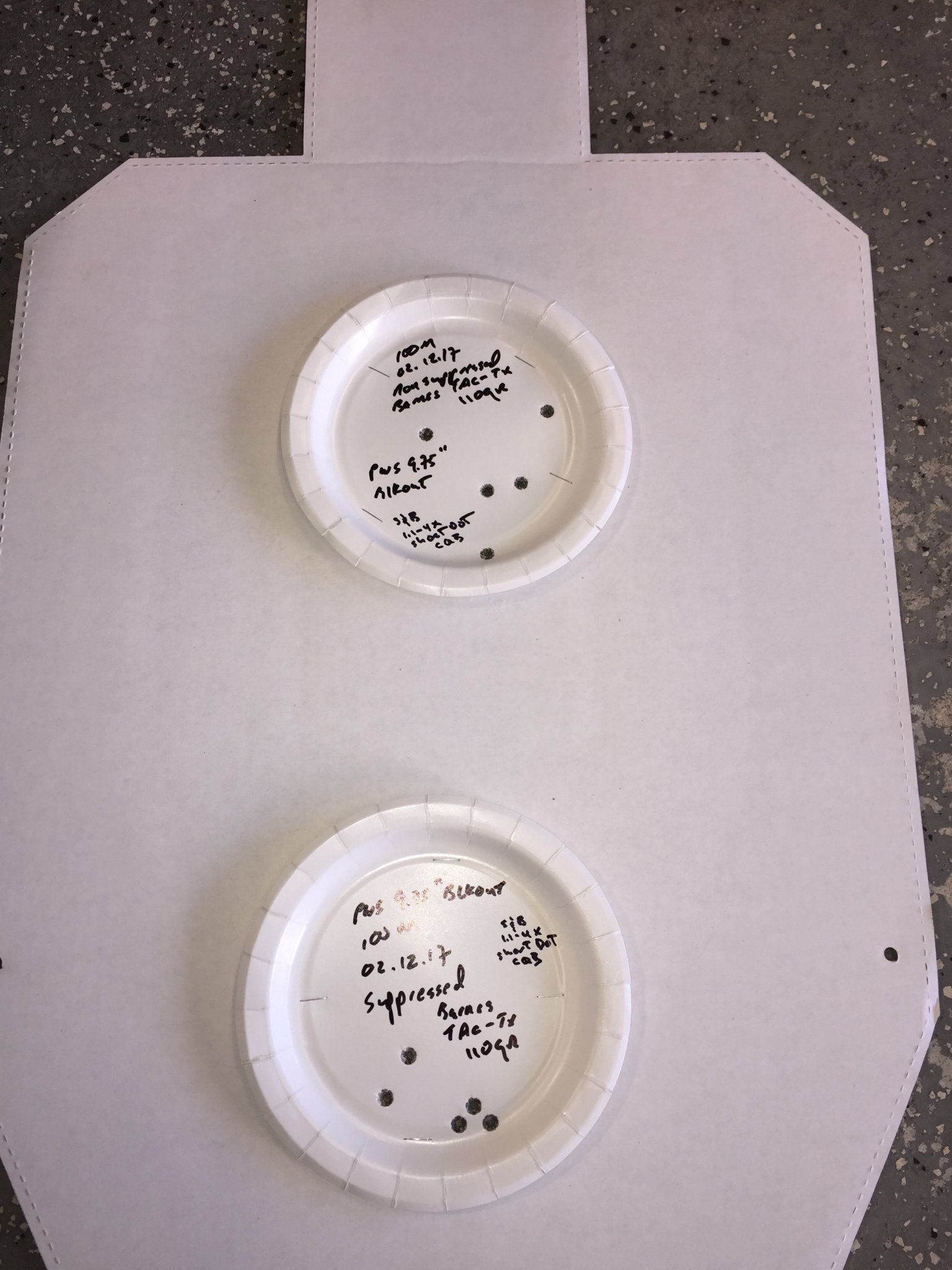

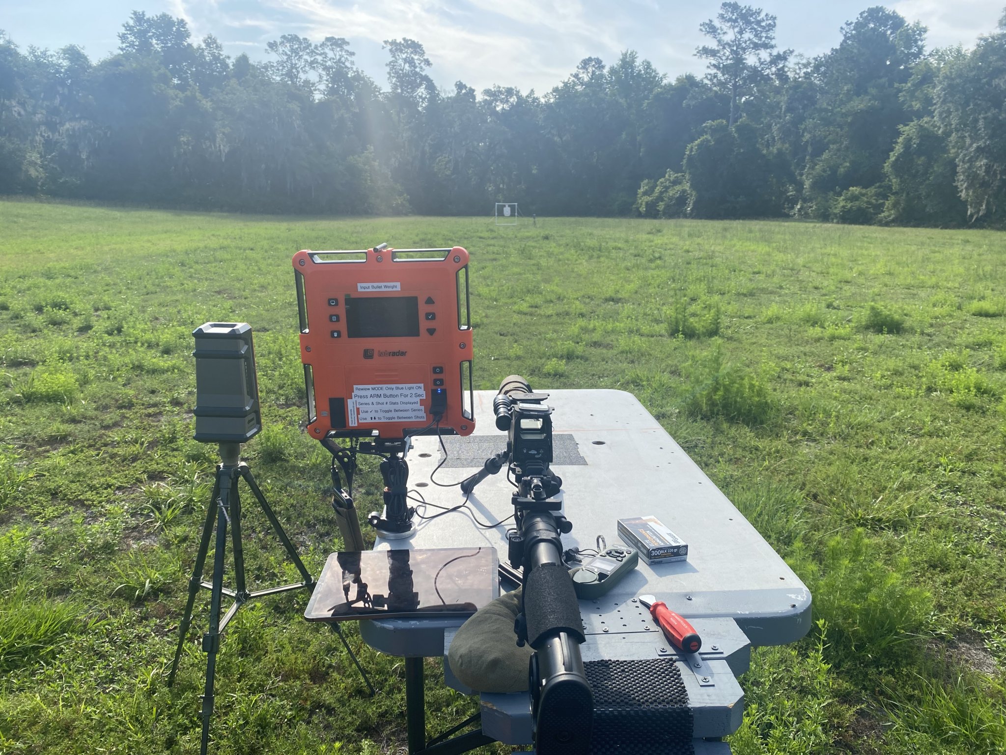

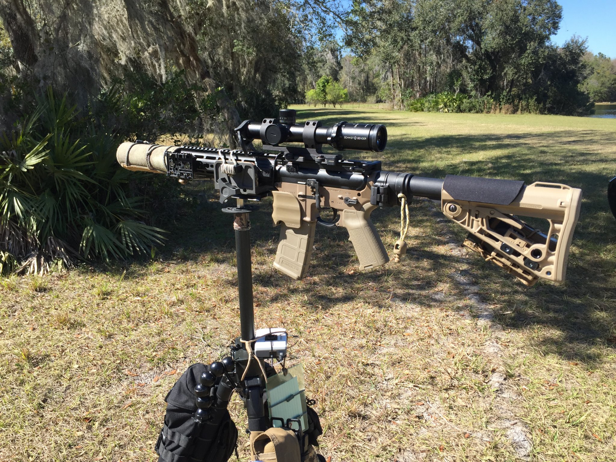

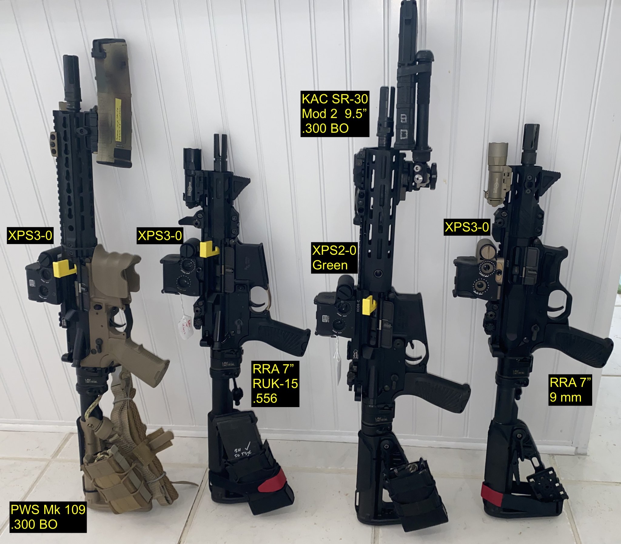

I cobbled together this Primary Weapons System (piston) Mk109 .300 BO a few years ago. Used a variety of sight systems, finding the need for real scope e.g. S&B 1.1-4X short dot, to increase precision @ 100 meters, the 1-2 MOA dot just can't provide. Running Gorilla 147 FMJ @ 1821 fps. These platforms are not sniper rifles, but the hogs don't know that. Subsonics POI ~ 10-11" lower @ short distances. Recently zeroed with an Eotech to conform to some other assemblies.

IMG_7038Eotech XPS3-0  XPS2-0 Green Rock River Arms 5.56 9mm PWS .300 BO KAC SR-30 05.03.23A c...jpg
