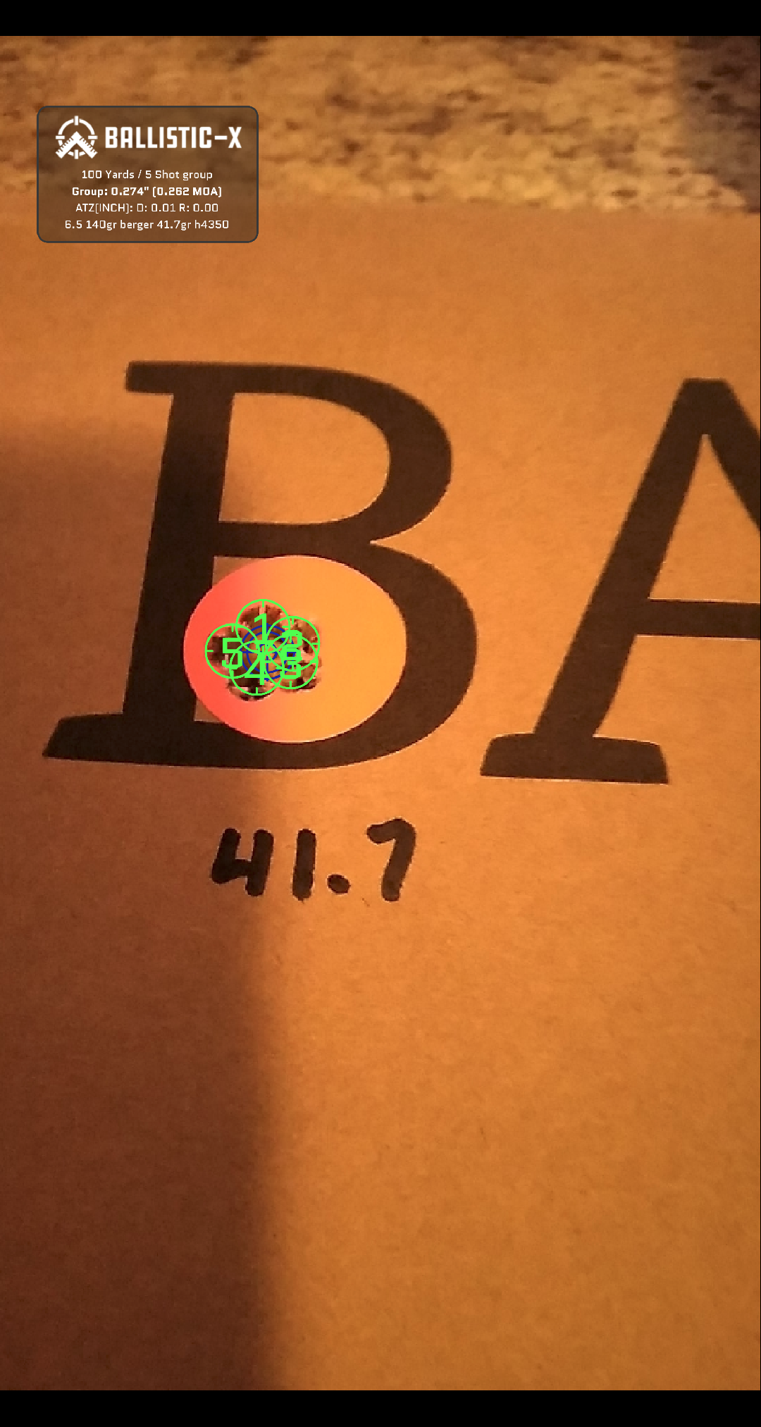

i think it's a good question I believe my 6.5 creedmoore m24 mtu contour 26'' barrel bored and put together at mile high is close to needing to be replaced the throat looks like an old man that sat out in the desert for a few months too long , the thread is still really nice , and the groups to me I am happy with it still even after 6400 rounds . Even with the replacement barrel in my possession I don't feel hurried about swapping it in yet . well not being a 5 shot one hole shooter I am still hitting a 3'' target at 600 yards 5 out of 5 tries a better shooter than myself did it 10 out of ten tries , I make more mistakes than the gun does still so consistency well its more me than the gun . had 5 touching at 200 yards last weekend and the speeds have been varied with my hand loads I want to keep it around 2680- 2760ish while keeping my powder around 42gr or less for the 600 yard range and 2760-2880ish for the 1k range which was easy using some powders and difficult with others . Id have to go back and check but the fastest speed I have gotten is 2890's but I had no need for anything that hot so I have not pushed it again and that was with rl17 and a 140 gr hornady bthp bullet . not that this means much but its the last pics I got before my phone died 5 shots at 100 yards under a dime not sure exactly how many round through the barrel at that point but its at least 5,600 + Just to note this is not my normal shooting I am just not that good of a shooter .I have far too many shakes to do this more often but it does feel nice when I does happen ..

i think it's a good question I believe my 6.5 creedmoore barrel is close to needing to be replaced the throat looks like an old man that sat out in the desert for a few months too long , the thread is still really nice , and the groups to me I am happy with it still even after 6400 rounds . Even with the replacement barrel in my possession I don't feel hurried about swapping it in yet . well not being a 5 shot one hole shooter I am still hitting a 3'' target at 600 yards 5 out of 5 tries a better shooter than myself did it 10 out of ten tries , I make more mistakes than the gun does still so consistency well its more me than the gun . had 5 touching at 200 yards last weekend and the speeds have been varied with my hand loads I want to keep it around 2680- 2760ish while keeping my powder around 42gr or less for the 600 yard range and 2760-2880ish for the 1k range which was easy using some powders and difficult with others . Id have to go back and check but the fastest speed I have gotten is 2890's but I had no need for anything that hot so I have not pushed it again and that was with rl17 and a 140 gr hornady bthp bullet . not that this means much but its the last pics I got before my phone died 5 shots at 100 yards under a dime not sure exactly how many round through the barrel at that point but its at least 5,600 +
What barrel? Thank you for such a great report!
Damn, I thought my Bartlein was shot out at 3200 rounds. Last couple of range trips have been a struggle to keep it under 1MOA. I guess I'll mess with the load some more and see. I do have a Proof at GAP right now waiting to be chambered.
i think it's a good question I believe my 6.5 creedmoore m24 mtu contour 26'' barrel is close to needing to be replaced the throat looks like an old man that sat out in the desert for a few months too long , the thread is still really nice , and the groups to me I am happy with it still even after 6400 rounds . Even with the replacement barrel in my possession I don't feel hurried about swapping it in yet . well not being a 5 shot one hole shooter I am still hitting a 3'' target at 600 yards 5 out of 5 tries a better shooter than myself did it 10 out of ten tries , I make more mistakes than the gun does still so consistency well its more me than the gun . had 5 touching at 200 yards last weekend and the speeds have been varied with my hand loads I want to keep it around 2680- 2760ish while keeping my powder around 42gr or less for the 600 yard range and 2760-2880ish for the 1k range which was easy using some powders and difficult with others . Id have to go back and check but the fastest speed I have gotten is 2890's but I had no need for anything that hot so I have not pushed it again and that was with rl17 and a 140 gr hornady bthp bullet . not that this means much but its the last pics I got before my phone died 5 shots at 100 yards under a dime not sure exactly how many round through the barrel at that point but its at least 5,600 + Just to note this is not my normal shooting I am just not that good of a shooter .I have far too many shakes to do this more often ..
