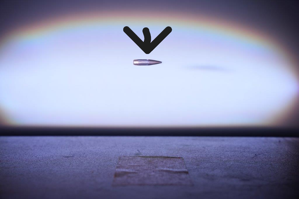

So here is the only picture I was given after several requests and it's a redacted photo... what I mean is... it's set up so the more you zoom in..... the blurrier it gets.
This is one of the bullets fired out of the conventional 6 groove rifling. What I'm trying to point to in the photo is a burr on this particular bullet. The shiny part is the burr and the cameras flash is reflecting off the burr.
Thanks! That's really interesting, it looks like there might be something there at 180 degrees opposite as well. I am going to have to slug some barrels and see if I can create a burr like that in a static test.
