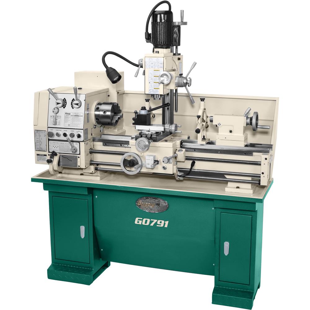

    Any of you have experience with one of these?
    I'm used to much larger equipment.
