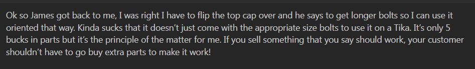

    Correspondence with Northland Shooters Supply indicates that while they advertise their action wrench as being Howa compatible, it really isn’t, as the screws that come with it aren’t long enough, thus requiring an additional purchase once it arrives, which displeases me and seems like misleading advertising.
    -Stan
    Well at least you found out before you spent your money on it.
    He had Tikka as compatible on that list last month and I guess he removed it after a discussion in another forum.
