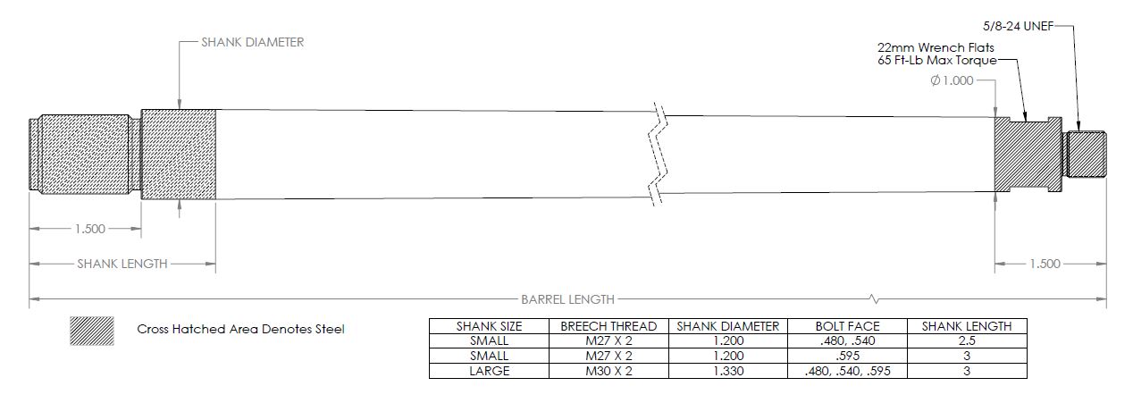

Looking to have a barrel blank fit to my AI and chambered (when it arrives: AT-X).
Is there a diagram or spec sheet someplace that I can give to the gunsmith to have this done?

Does it use the AI AT tenon?
There’s a few pics of that floating around.
I’d play it safe and order a barrel from mile high or measure your AI-x barrel when it arrives.

You can get AT barrels anywhere. Just order an AT prefit from Sawtooth, DMR, Mile High, Bugholes, Straight Jacket, whoever....tons of guys can have you a perfect barrel done before you even get the gun.
