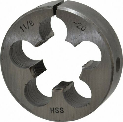

I have a Savage large shank barrel, 1.120. The total threaded length on the barrel is about 1.3 inches. For a number of different reasons I'd like the threaded length to be longer, about 1.5". Can I thread this by hand using a 1 1/8-20 UN die? I have access to the die and 2-1/2 handle for free. Any helpful advice would be greatly appreciated.
Here is a picture of the type of die I was going to use. It is a split adjustable die so I wouldn't have to cut the threads all in one pass.

To actually cut 0.2 threads with a die, you have to take the die well past the threads you want cut - i.e. 0.2 inches of thread is going to have another 0.1-0.3" of thread past the thread depth desired of 'started cut' where the thread is not full depth or usable. On a lathe the threads can be chased and stopped at exactly 0.2"of additional thread.

Thread the die on until it hard stops. Give it four more turns, bam, .200” more threads than were there before.
