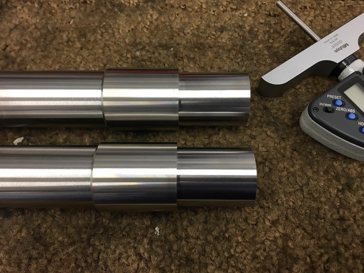

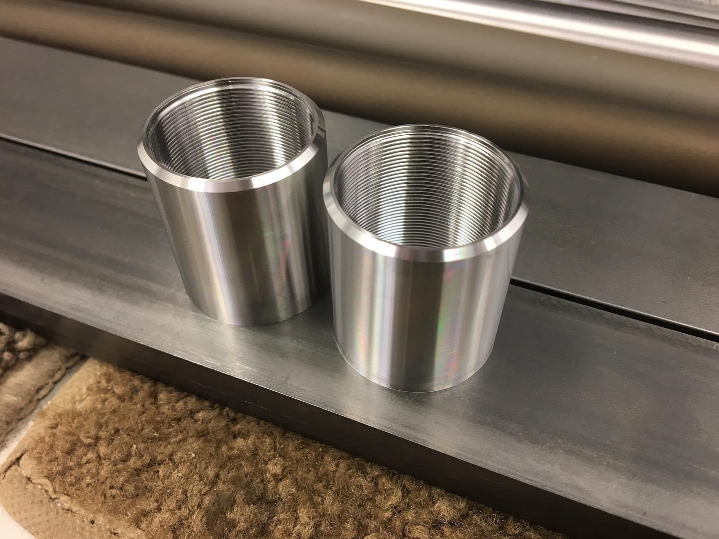

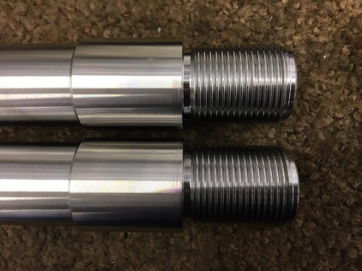

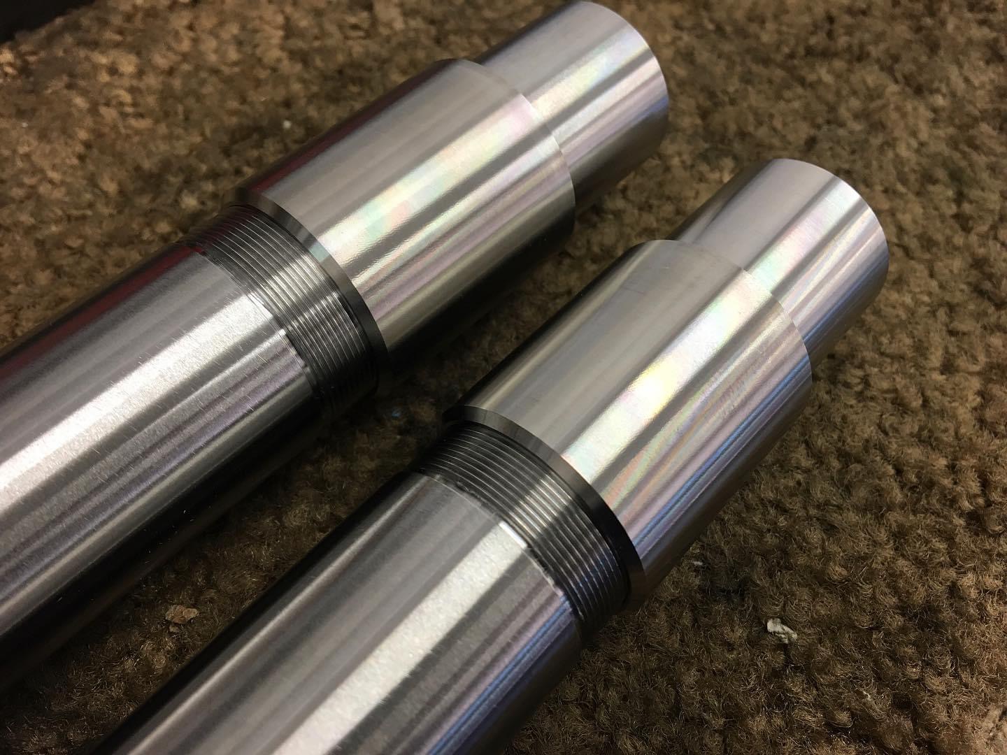

Thread the barrel for 5/8X24. Screw on and lock-tight a internally threaded 5/8x24 piece that will become the shoulder. Machine that piece square with the bore to become the shoulder abutment, & contour to your liking.
There is a video on U tube showing it all, but can't find it right now. Simple to do and when you are done, no adapters required.

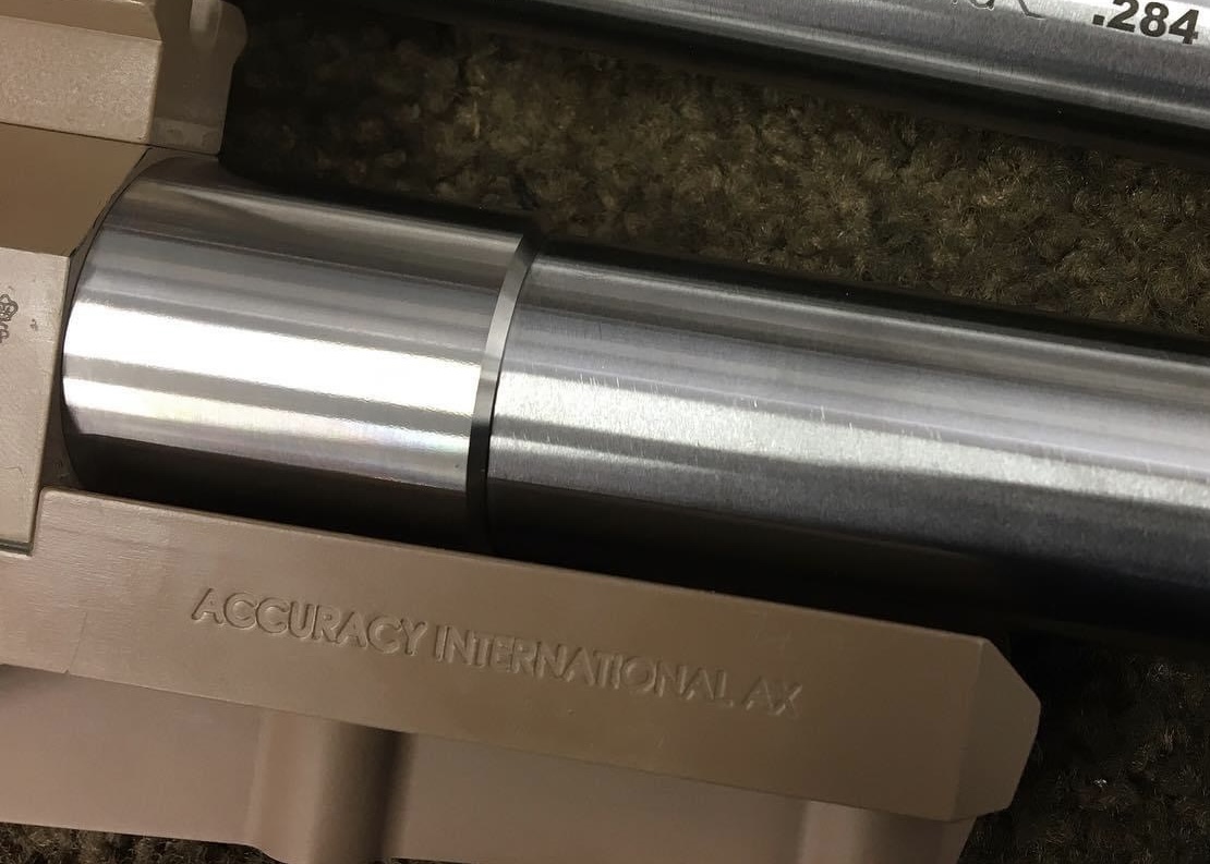

This is what I’d recommend if a suppressor is the planned use to end up with a much more common thread. If it’s a permanent/semi-perm muzzle brake, I’d likely default to a 1/2-28.
I’ve even done similar to repurpose some 1.25” shank barrels for large shank AXMCs.

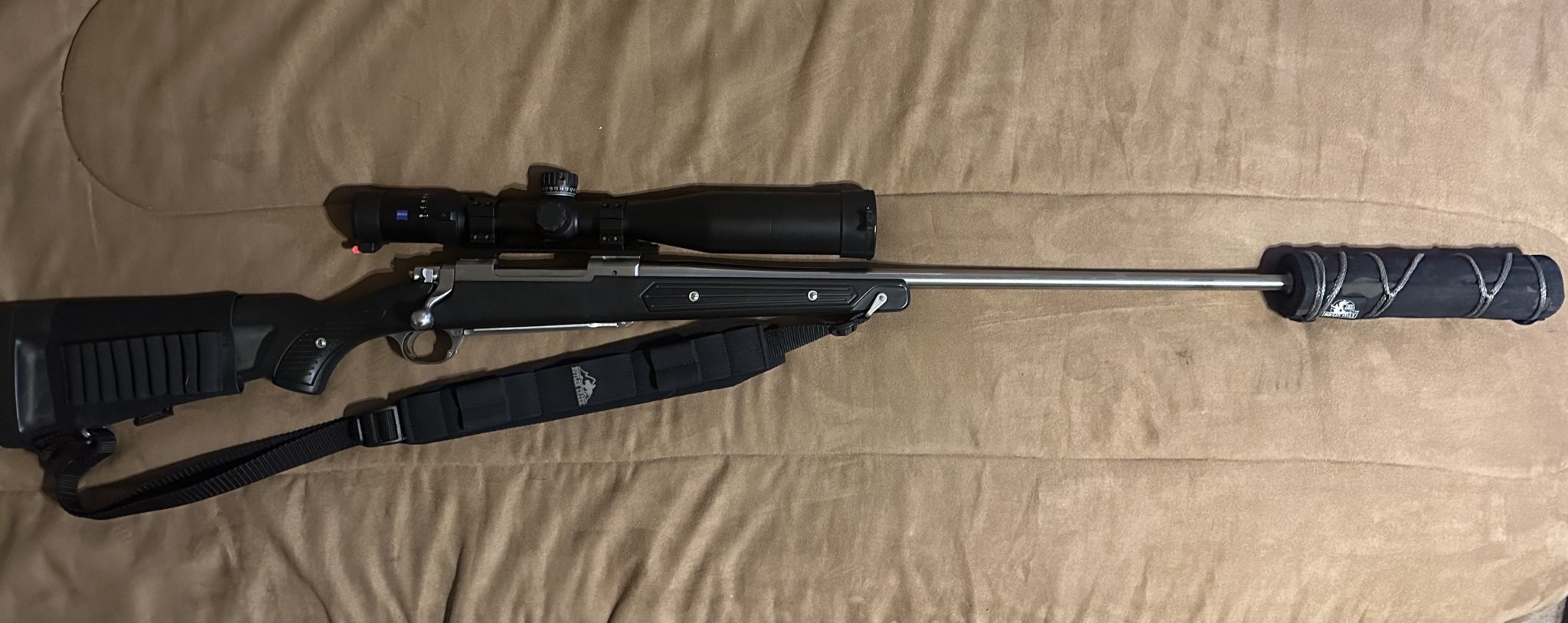

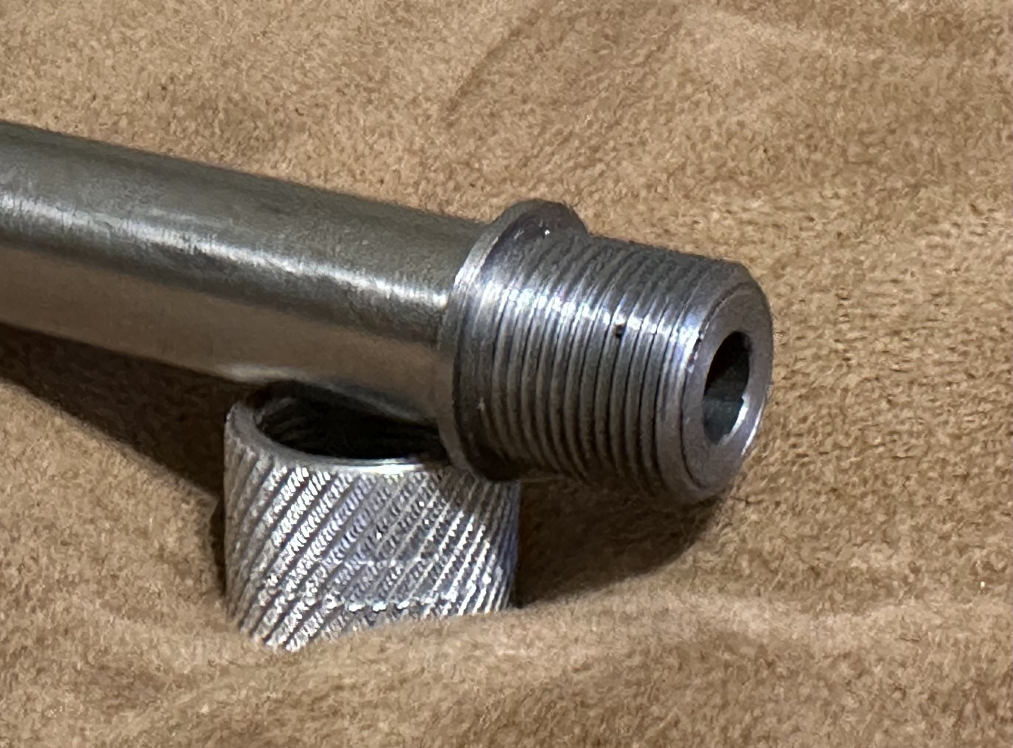

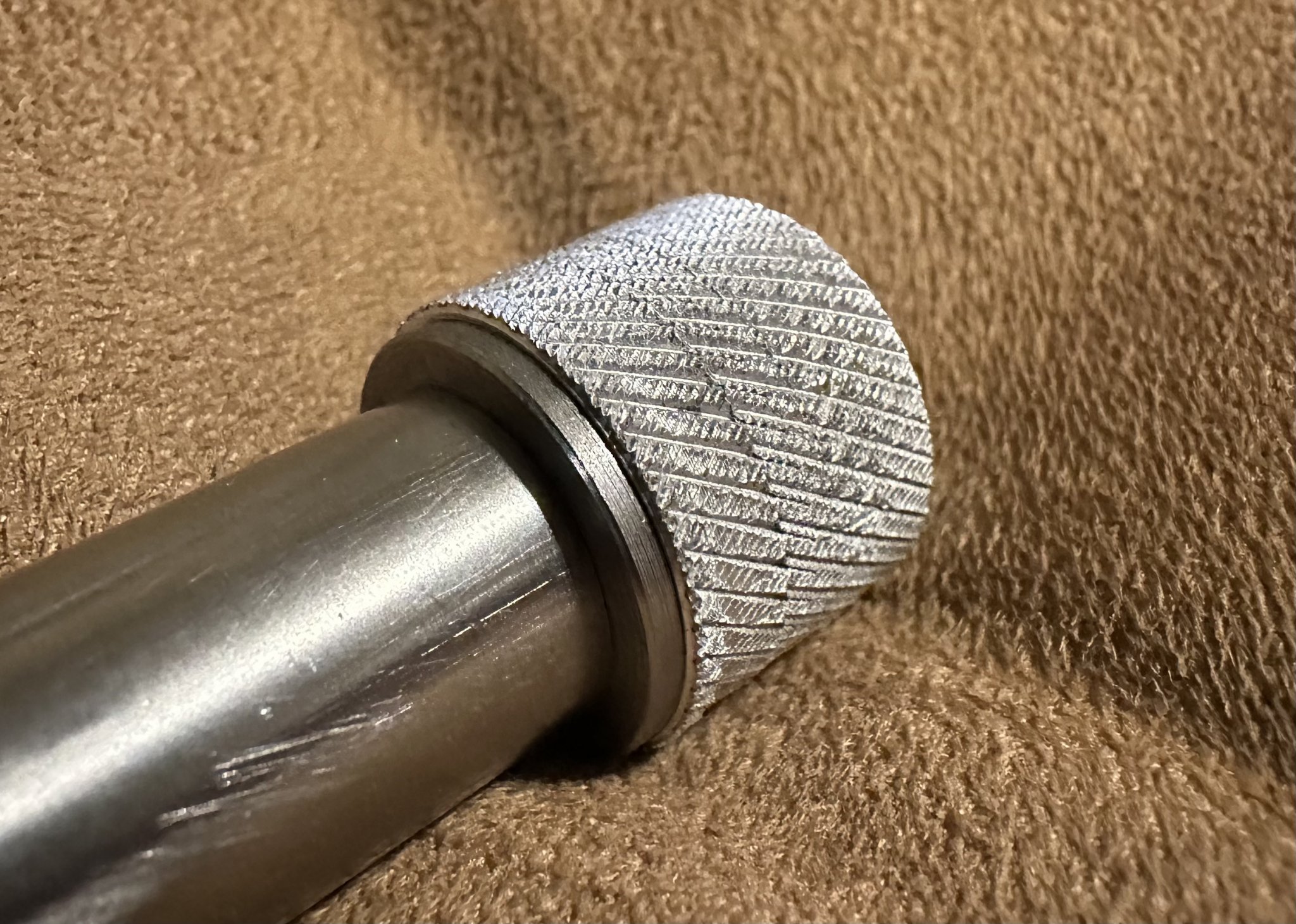

Have a gunsmith make you a threaded adapter to permanently attach to your barrel. I had this done last year on 2 old Ruger M77 MKII's that I've had for 22+ years. I finally decided to thread them to run my suppressors on them. They turned out excellent. And even though they are not the fanciest job, they are straight and true to the bore, and have nice tight threads with minimal wiggle.
9/16-24 is fully adequate for a 7mm Mag; no strength issues there.
Since TB makes a CB mount in that thread, seems to me you're good to go with that, no adapters or other methods needed. It's not that uncommon anyway; there are options for that thread size from other suppressor manufacturers too.
