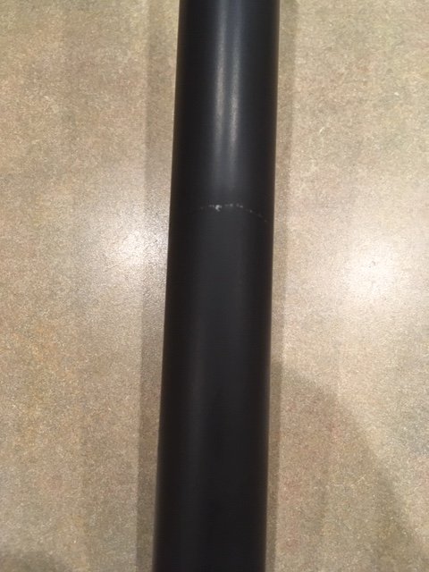

My personal HTG stock with a bighorn tl3 and bartlein rem varm .308 win was showing signs of contact on the barrel and stock. Hitting so hard it wore through the cerakote. It had what I thought was plenty of clearance. So I opened it up to probably .050" which is what is recommended by Mcmillan. Fresh coat of spray paint on the inside, take it out to shoot it, take it apart, still making contact. The rifle was stringing vertically in the beginning, after opening it up it started shooting better. So I opened it up again to now what I would guess to be somewhere around .120" clearance. Take it out and shoot it, disassembly, still showing marks of contact on the freshly painted barrel channel at the end. Thought there is no way and something is going on here. Glass and pillar bedding are perfectly stress free and nothing is loose or shifting. I went ahead and redid the bedding just incase there was something going on. Take it out and shoot it, shoots really well, but still showing signs of contact.
My buddies rifle which is basically the same as mine except 22" .260 remington. I took it apart to check to see if his was making contact with about the .050" clearance and sure enough, it has been hitting so hard it wore through the cerakote as well. (Pictures below) Just squeezing the stock against the barrel at the tip of the stock does not take much pressure at all. If I take some manners carbon fiber stocks, it is much much stiffer and harder to make contact with the barrel.
All this being said the whole "slide a dollar bill under the barrel" doesn't seam to be making since. Spoke with mcmillan and they don't seam to have an explanation for it either. I know the saying if the rifle shoots, don't mess with it. I agree with that, but that still doesn't make it right and could contribute to flyers.
Any Ideas? Any advise? Once again, the bedding is completely stress free and the pillars are in there tight.

I think I kinda figured out the problem but still kinda weird. I’ve been playing with the amount of force it takes to squeeze the barrel and stock together on these htg’s as well as many Manners stocks. The carbon fiber stocks are way way stiffer. That being said, I don’t think the barrel is actually touching under recoil. If you slap the bottom of the stock near the end, it doesn’t take much to make contact. So I’m thinking bouncing around in the truck and putting it down on bipods hard is probably what’s causing it to show signs of contact. Just thought this was an interesting find.
