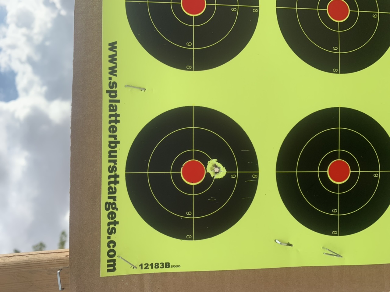

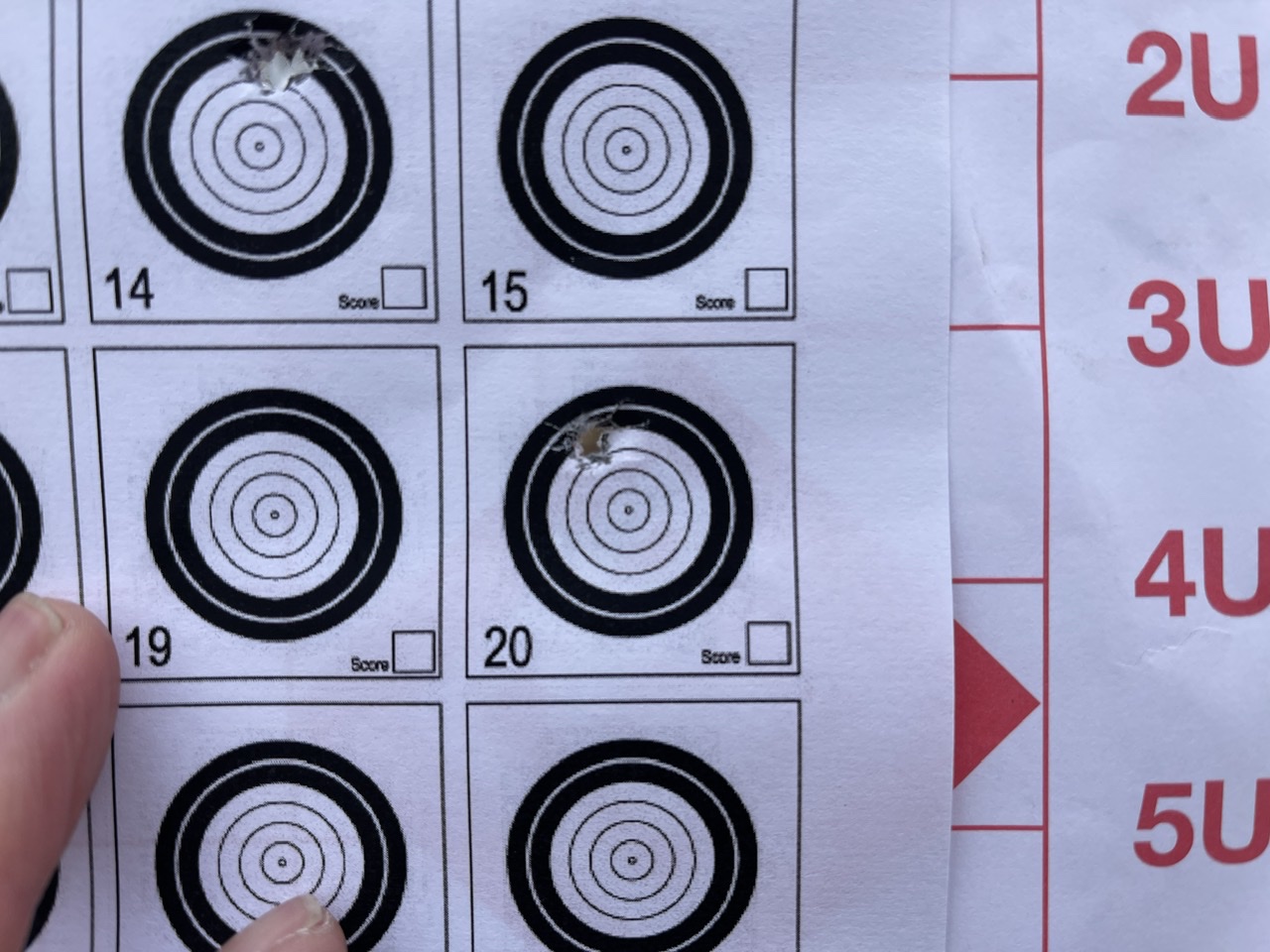

26” MTU with an EC tuner. Even though it’s a thick barrel it still is tunable. The other day.. One hole at setting 20. I got equal results with my B14R as well in the past.
