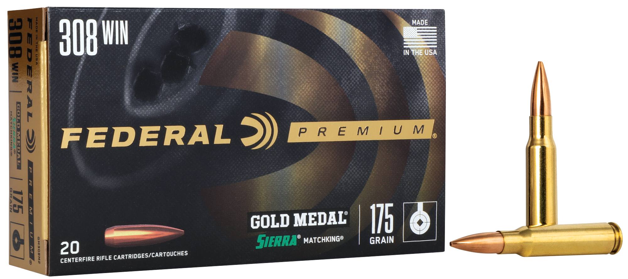

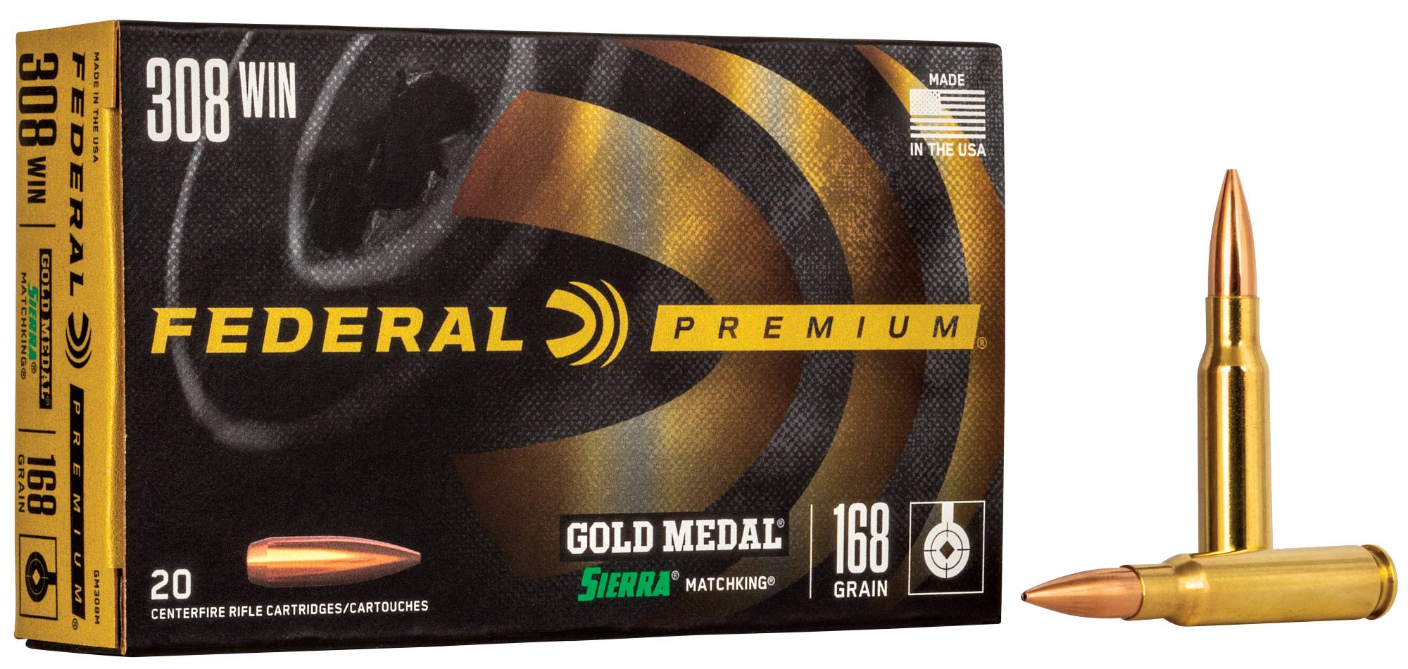

With that calculator, I used the data from Federal's website:
Even the twist rate drops from 7inches to 10inches, on a average day, the stability factor is still over 2.0 between 2.1 and 2.7. Does that mean I need to drop to something like 11 or 12?
11 inches is what the factory barrel uses, then the stability factor stays at about 1.9, which is under 2.0, does that mean I'd better sticky with that 1:11 twist rate if I just want to shoot 308 for average factory match ammo?
Thank you

MV stands for muzzle velocity.
Optimal stability is 1.5. You don’t need any more than that.
1:10, or 1:11 would be fine for those bullets in .308 win, and still let you go a bit heavier/longer.
You’re not going to find many factory .308 win options with bullets heavier than ~185gr due to the 2.800” cartridge overall length saami spec they’re all loaded to.
1:7, 1:8 twist is for .300 blackout
1:8.5, 1:9 is for the big 30 cal magnums firing the 230-250gr bullets.
Those twist rates are excessive for .308 win and you could see negative effects down range.

I think I will go something like 1:10 or 1:11. Not going to shoot anything heavier than 175gr, mainly 150-170gr.
Thank you for the explanation.
If you are going to shoot the 155gr stuff close up, it really works well in the 1:11 and 1:12 barrels from what I've seen.
And those same barrels will still do good on the 175gr.
