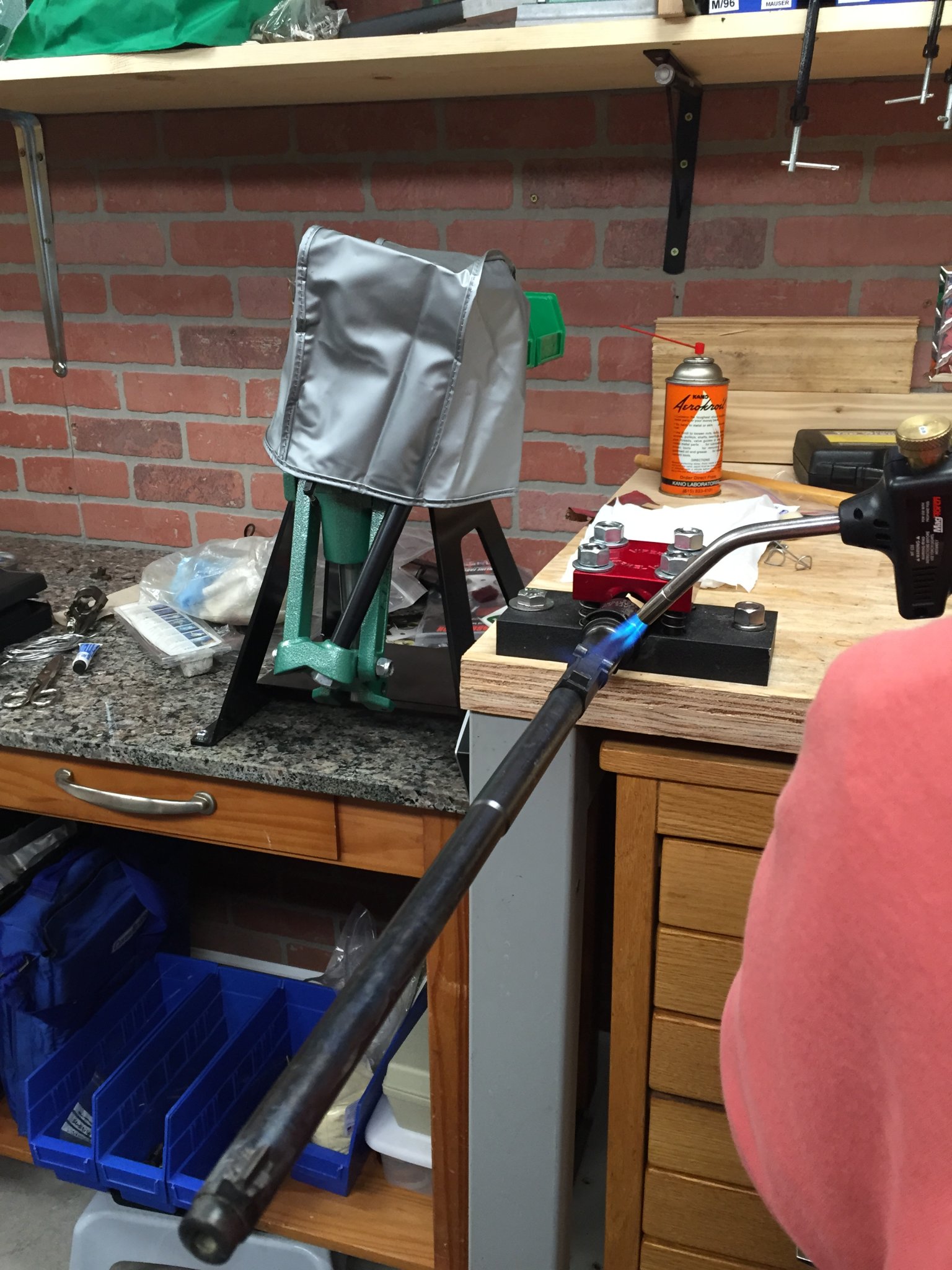

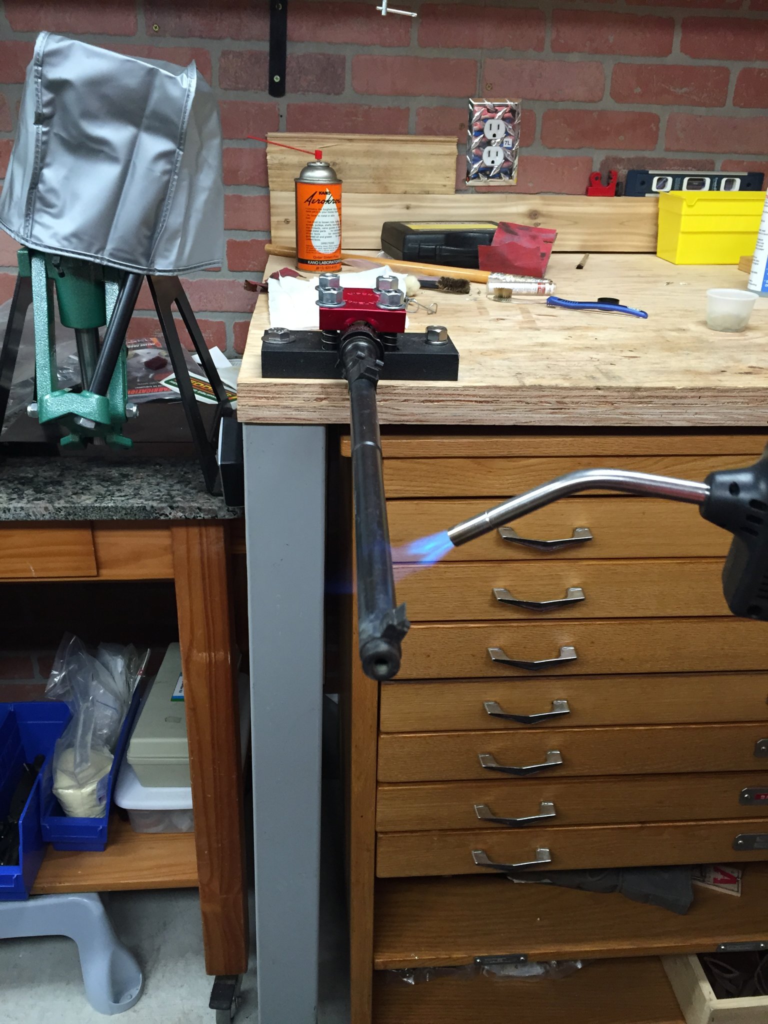

I use the cardboard roll out of a tp roll on mine. After a couple factory remington barrel removls my viper gice is pretty beat up, but I still use it/have used it a lot since the tough removals. I bent the top cap and had to bend it back, marred the finish, and one stud gualed to the nut. I replaced it and epoxies the studs in so they wouldn't come out.

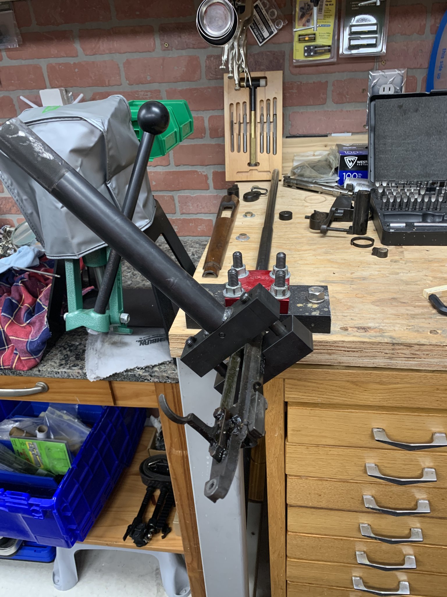

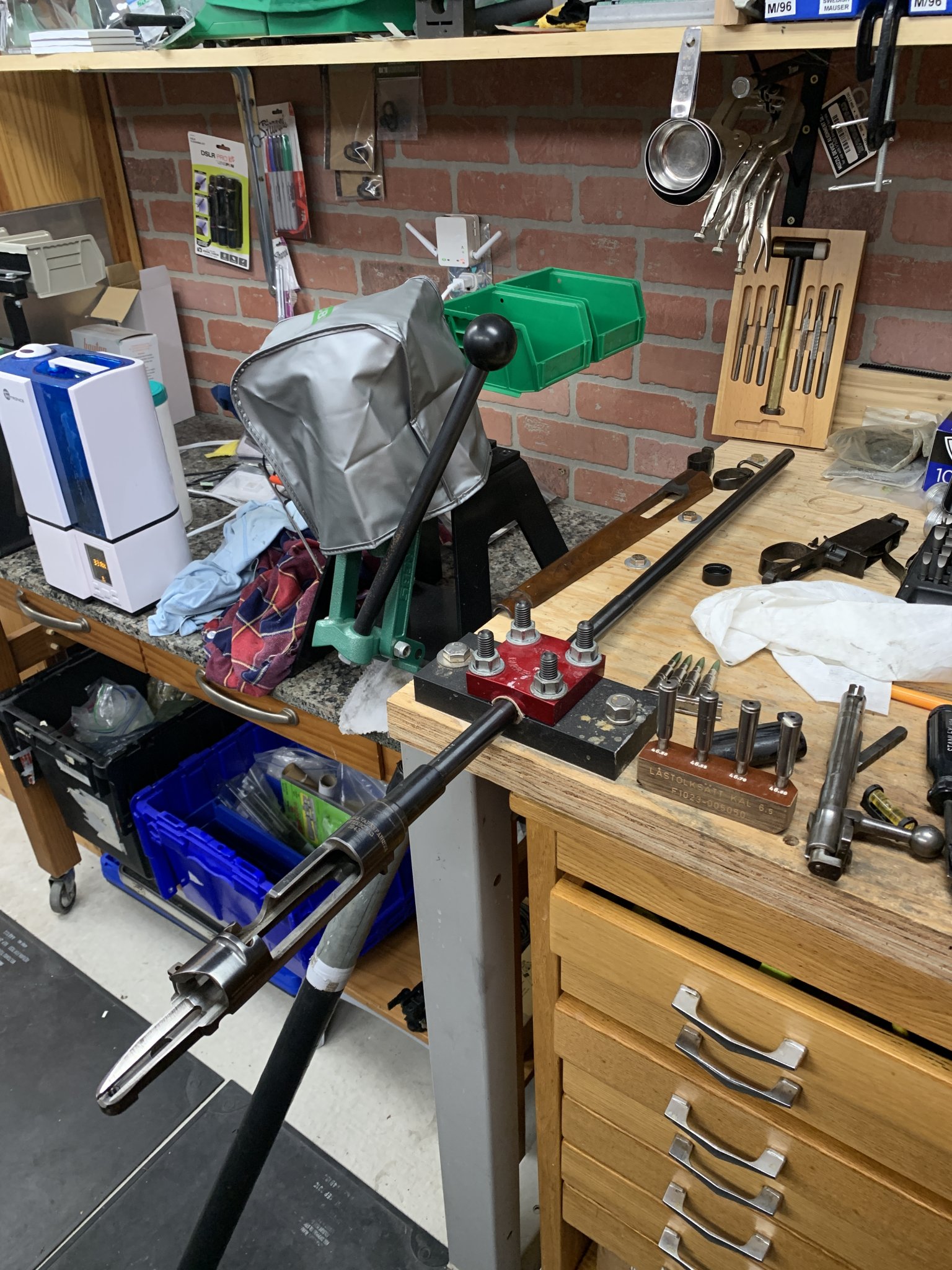

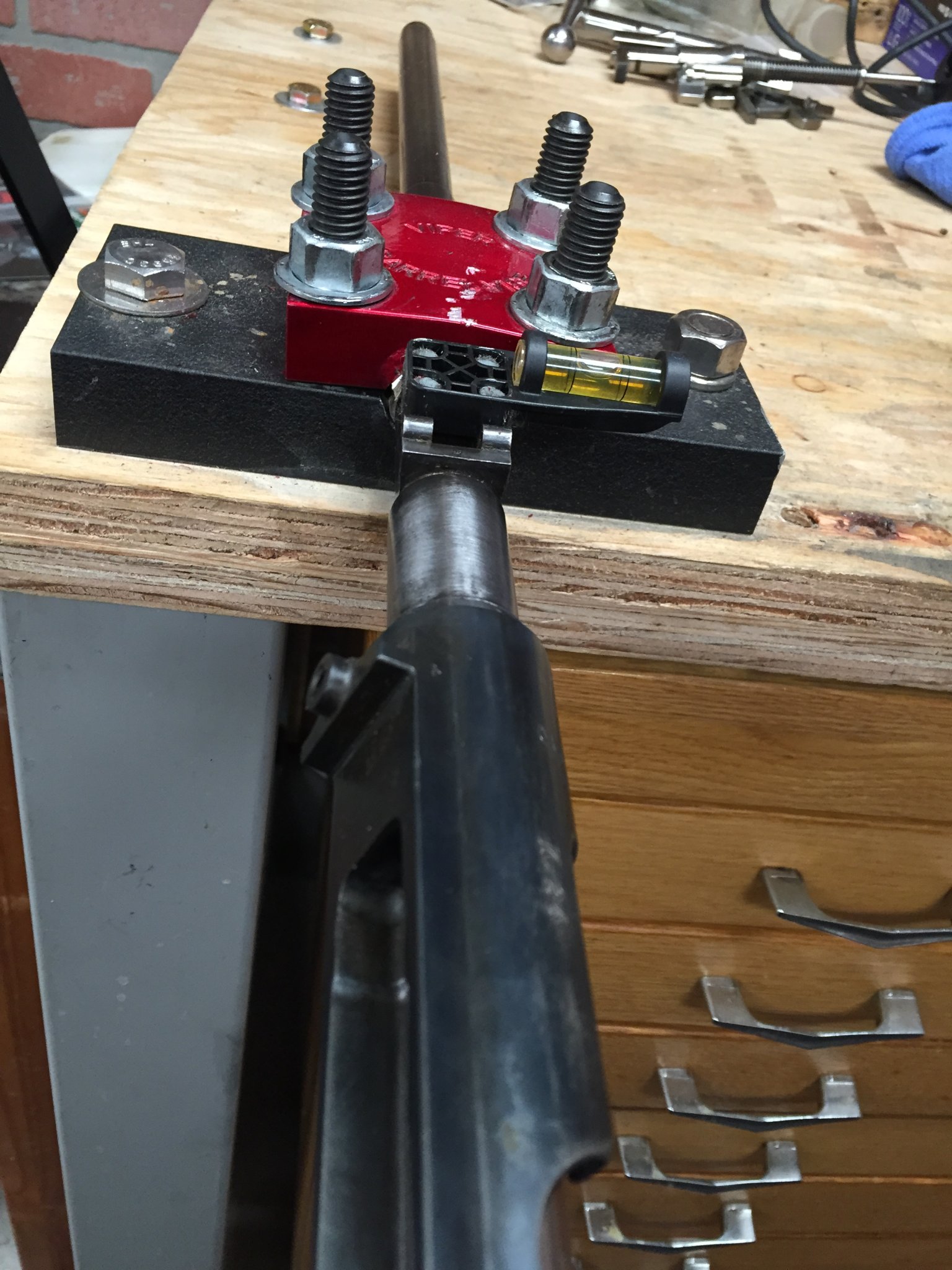

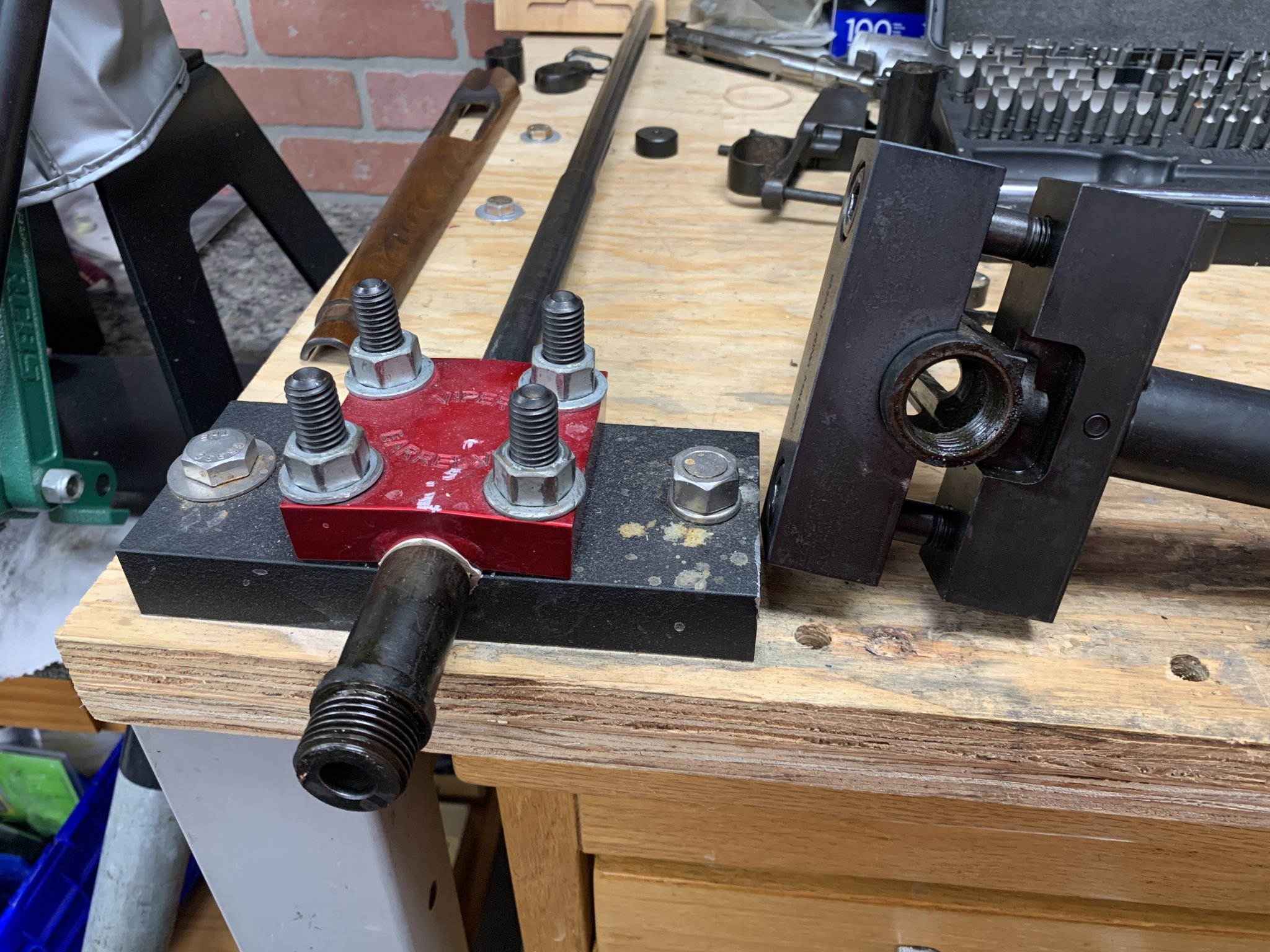

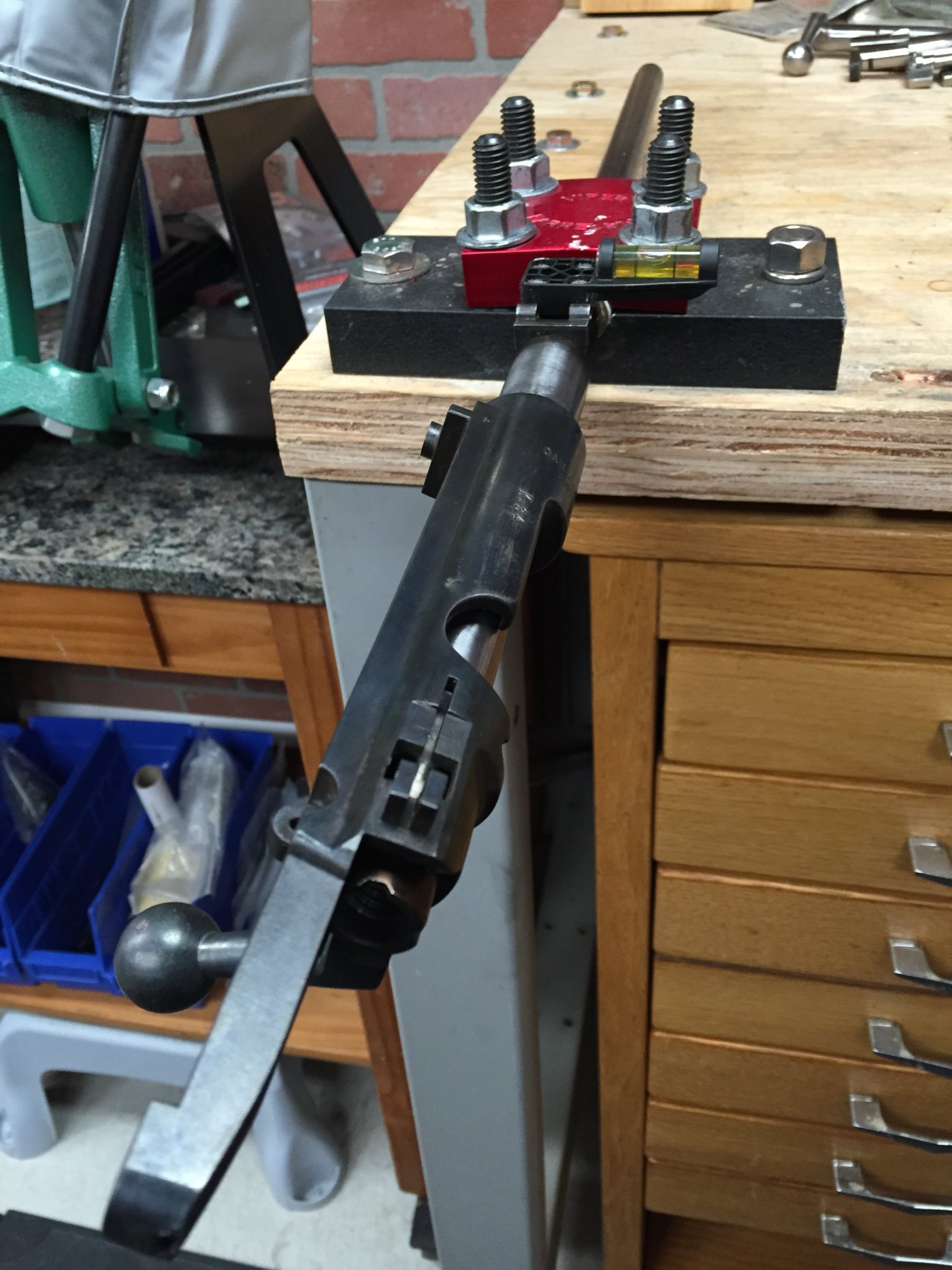

I do quite a bit of spinning on small ring mausers (swedes) so a decent vise (well, and a correct action wrench) is a must. I have tried close to a half a dozen of different vises - Viper has been wonderful, as a matter of fact - its probably 10yrs old, all original, nothing ever failed. I use toilet paper center roll and a fine rosin to avoid mars or slips. Oak blocks could NOT spin most of the mauser military barrels off…

Put a drill rod in your bore then clamp down with 4 points of contact in the Viper and see what happens.
I can tell you first hand, that chamber casts are IDENTICAL prior to removal and after barrel was spun off.
I can’t say anything about drill rod, never tried it.
Are you suggesting it compresses enough to mark/jam a rod? Just curious
It will crush you bore enough that you won’t be able to remove the rod.

Chamber cast will be- you're clamping the barrel a foot ahead of the chamber. It's obviously not going to affect the chamber behind it.
Barrels should always be clamped just ahead of the receiver ring.
Actually I do clamp it in a chamber area, after its headspaced - I re-solder my rear sight base (so its leveled properly).
Perhaps my “anti slip spacer” provides sufficient insulator and prevents crushing…
Picture where I have clamped it about mid point- if you look closely- there are 6.5x55 Swedish armorer regimental headspace gauges. Meaning I was doing final headspacing tweaks and it does not require all that much force, unlike a 100-130 years old barrel removal.
I am not saying you are wrong, I just never personally encountered that (“crushing barrel”) particular condition and I have done 50-60 swede mauser re-barrels…
