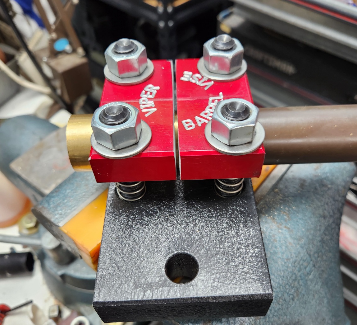

Indeed. Even some suede patches from Hobby Lobby will work.I use a oak blocks that I drill to the diameter I want with a hole saw and then split them in half with a band saw. I wrap a thin piece of leather around the barrel, put them in the blocks and clamp it in my old 8 inch Wilton vise. I haven't had a barrel slip yet with this setup. I do like the Viper Vise set up. I may make something like that which I can bolt to my metal work and move from vertical to horizontal work.

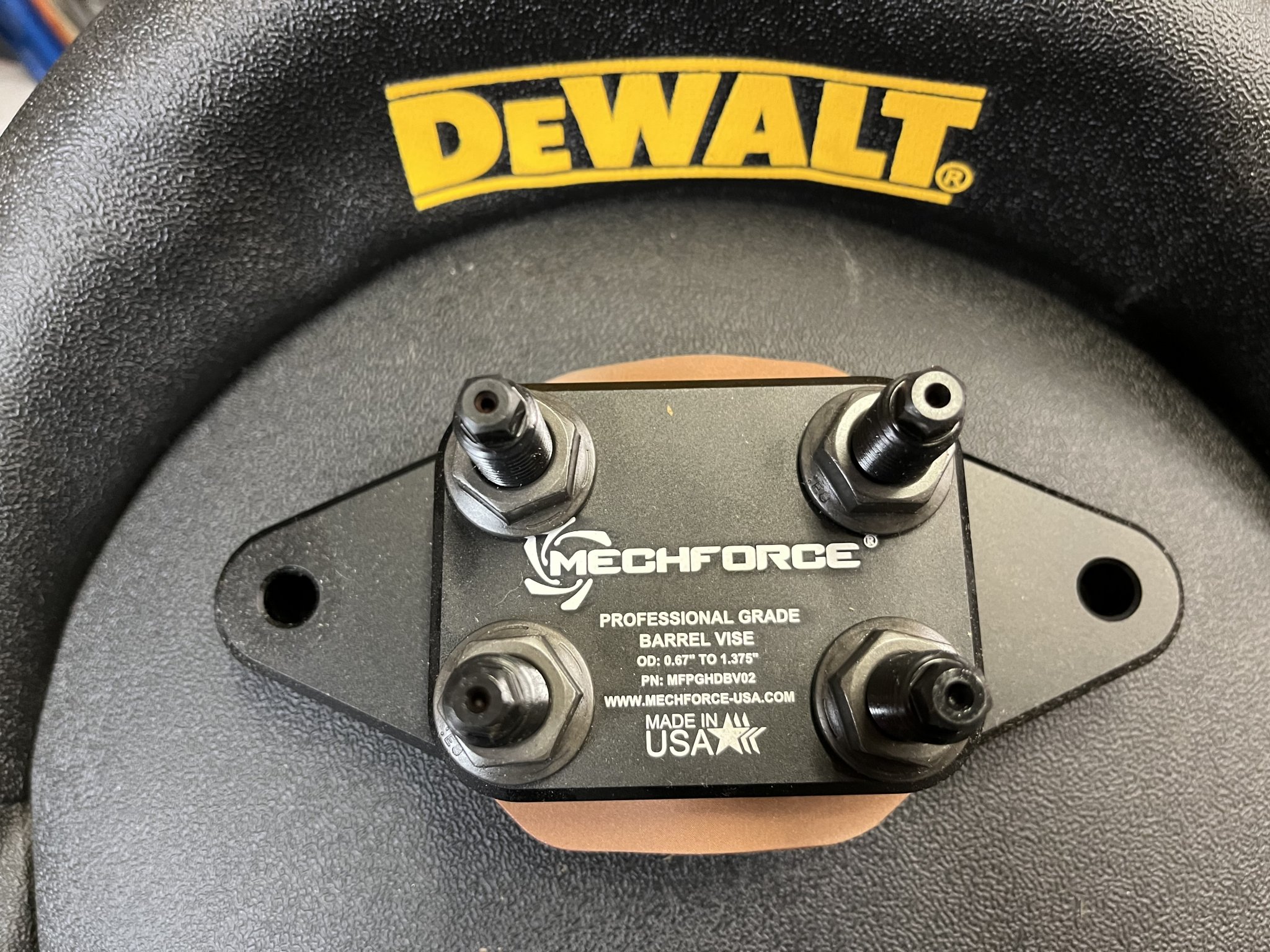

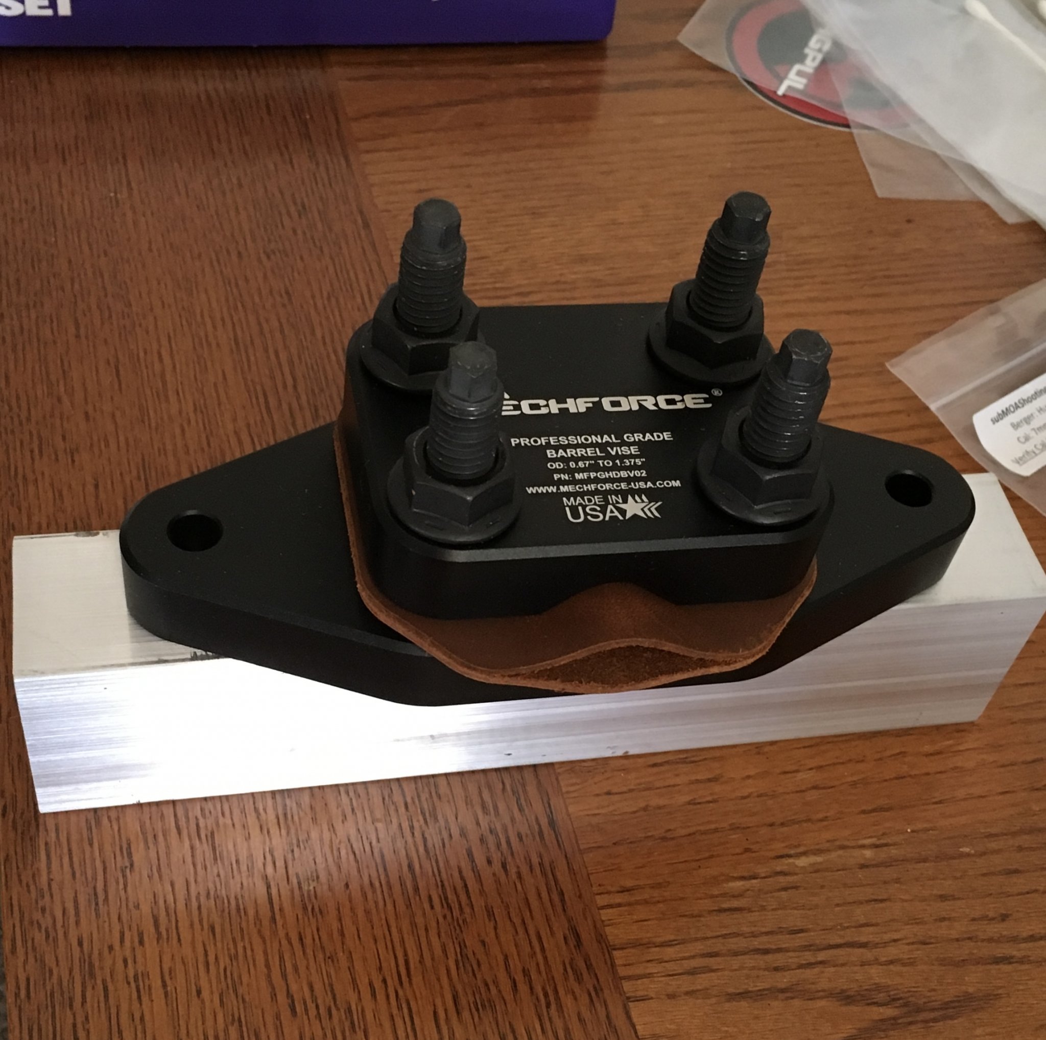

This is what I have. I broke loose several Tikka and TRG barrels with it. The best thing I did was throw that piece of leather in the trash. A simple wrap with notebook/copy paper keeps the barrel from slipping in the vice and protects the barrel’s finish. The leather will allow a tightly torqued barrel to slip, a lot.
Good to know. Thanks.This is what I have. I broke loose several Tikka and TRG barrels with it. The best thing I did was throw that piece of leather in the trash. A simple wrap with notebook/copy paper keeps the barrel from slipping in the vice and protects the barrel’s finish. The leather will allow a tightly torqued barrel to slip, a lot.
