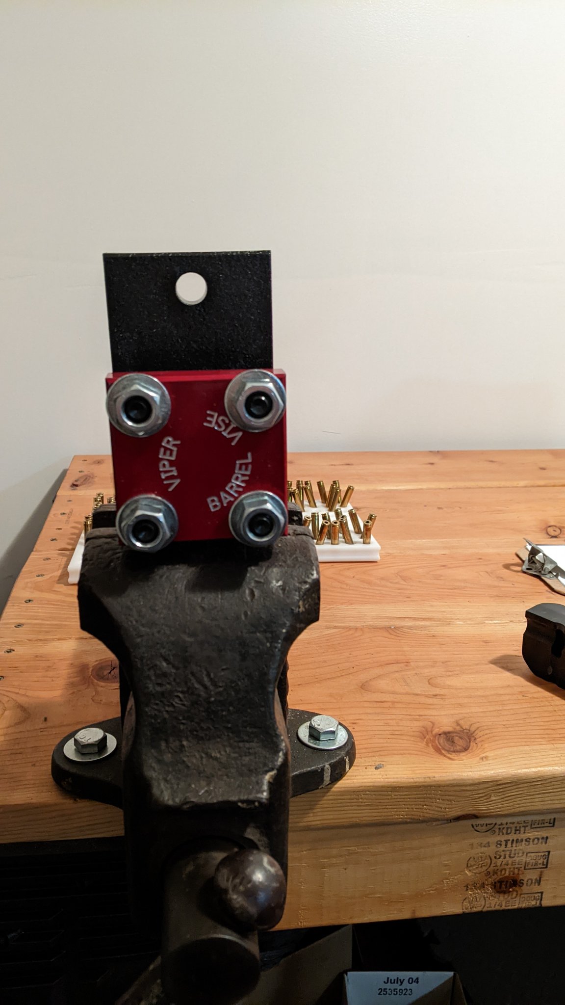

I don't keep my viper attached to my bench. I use a couple of old C clamps when I need to use it. I've also seen some people toss their barrel vise in their bench vise when needed.

I figured that might be possible to just clamp a normal barrel vice into a bench vice but wasn’t sure the success with the twisting force and the barrel vice turning. Main goal is to avoid taking up bench space with something that I use a couple times a year
I have a Viper as well and use it with two pieces of leather to grip the barrel. I use C-clamps to hold it to my bench or I will put in my vices lower jaws to hold it.
I do this with my Viper. Have gone up to 120lb-ft with no issues.

Get a proper barrel vise and clamp it to your bench or in your vise. I had a set of jaws for my vise and it just doesn’t clamp the same and barrels would often spin when using leather to protect the finish. In regular barrel vise with nuts or bolts you torque they don’t spin.
You can clamp it to your bench, a table, your bumper or any other surface you can get a clamp under. You can also clamp or bolt it to a small piece of 2x4 to use in your bench vise, or you can grab it with the vise like pictured in the post above.

When it's attaching a barrel, I've put my viper in my bench vise because I'm not putting a ton of torque like the OEMs.
But I've never tried with removing a barrel, that's whey I use plain old steel C clamps.
