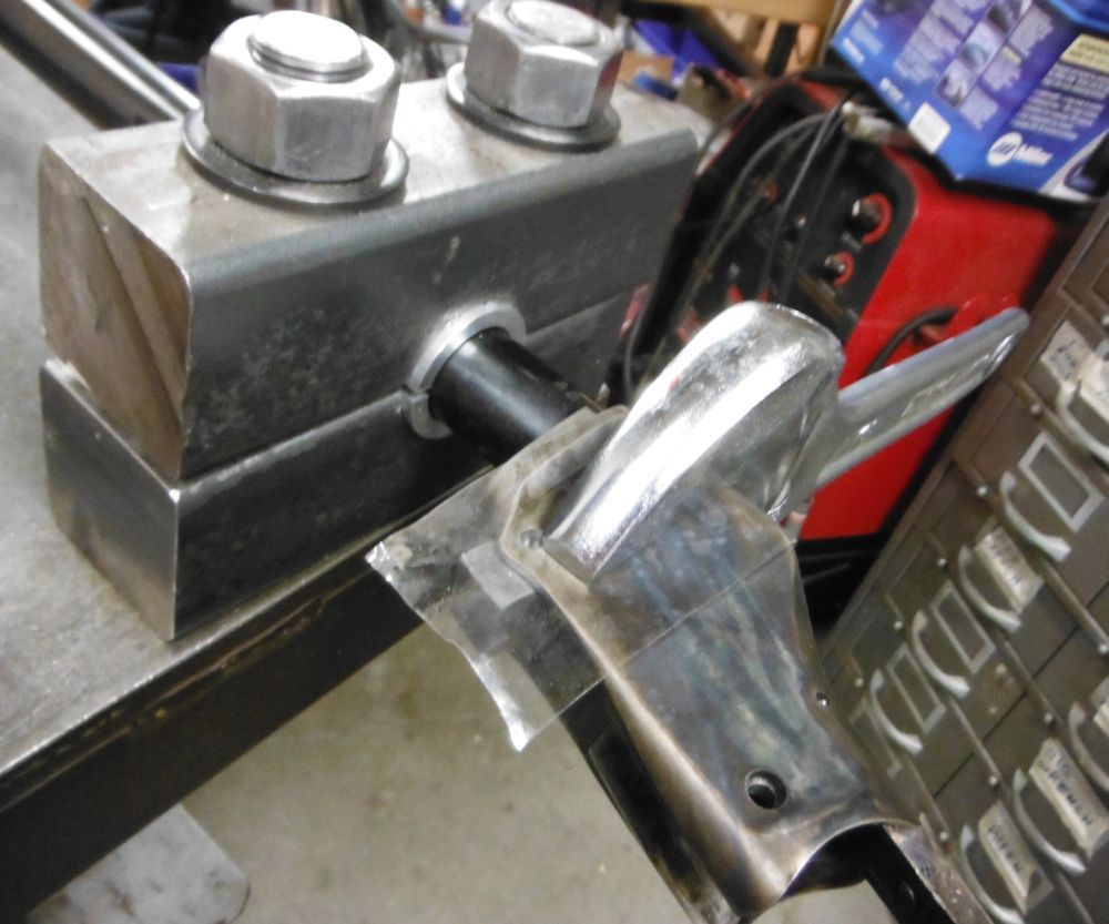

Make your own. Drill holes for bolts in 2" x 2" x L" steel.
Clamp a shim between them.
Bore a 1.5" diameter hole centered on the shim.
Mount to a 200 pound bench.

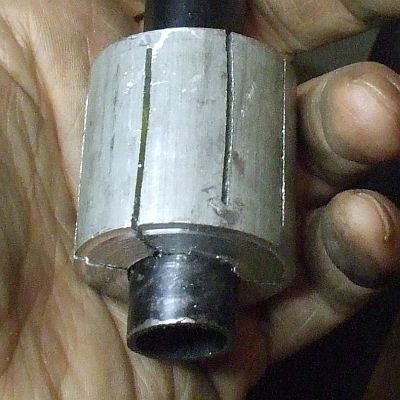

Buy 1.5" diameter Aluminum alloy. Cut 2" lengths and make collets to fit barrel diameters or tapers.
With a cheater bar on the action wrench, this system can make 600 foot pounds without the barrel slipping.
  • Barrel vise, custom collet, .800 in block filler in 1885 receiver, packing tape to protect fin...jpg
  • Collet 1.5 in outside .75 in inside for taking off co-ax press handle   put the collet in the ...jpg
