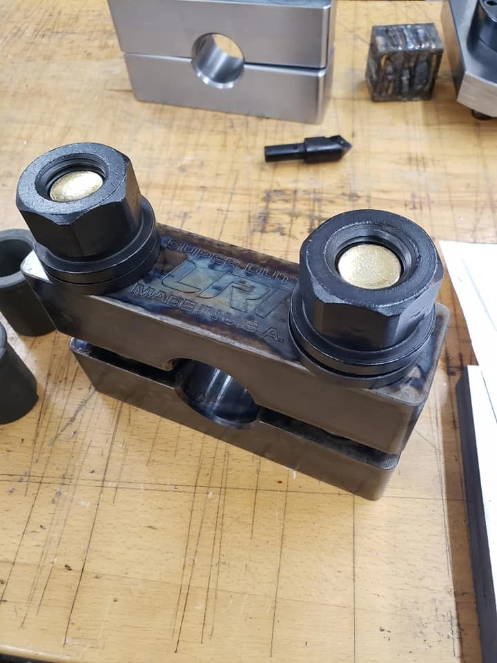

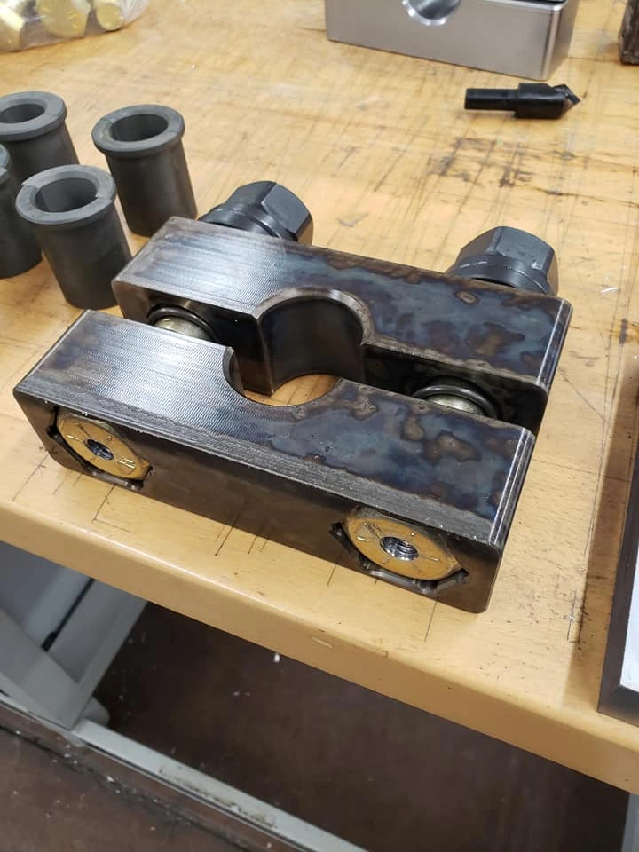

Then LRI unit is the TANK of barrel vises

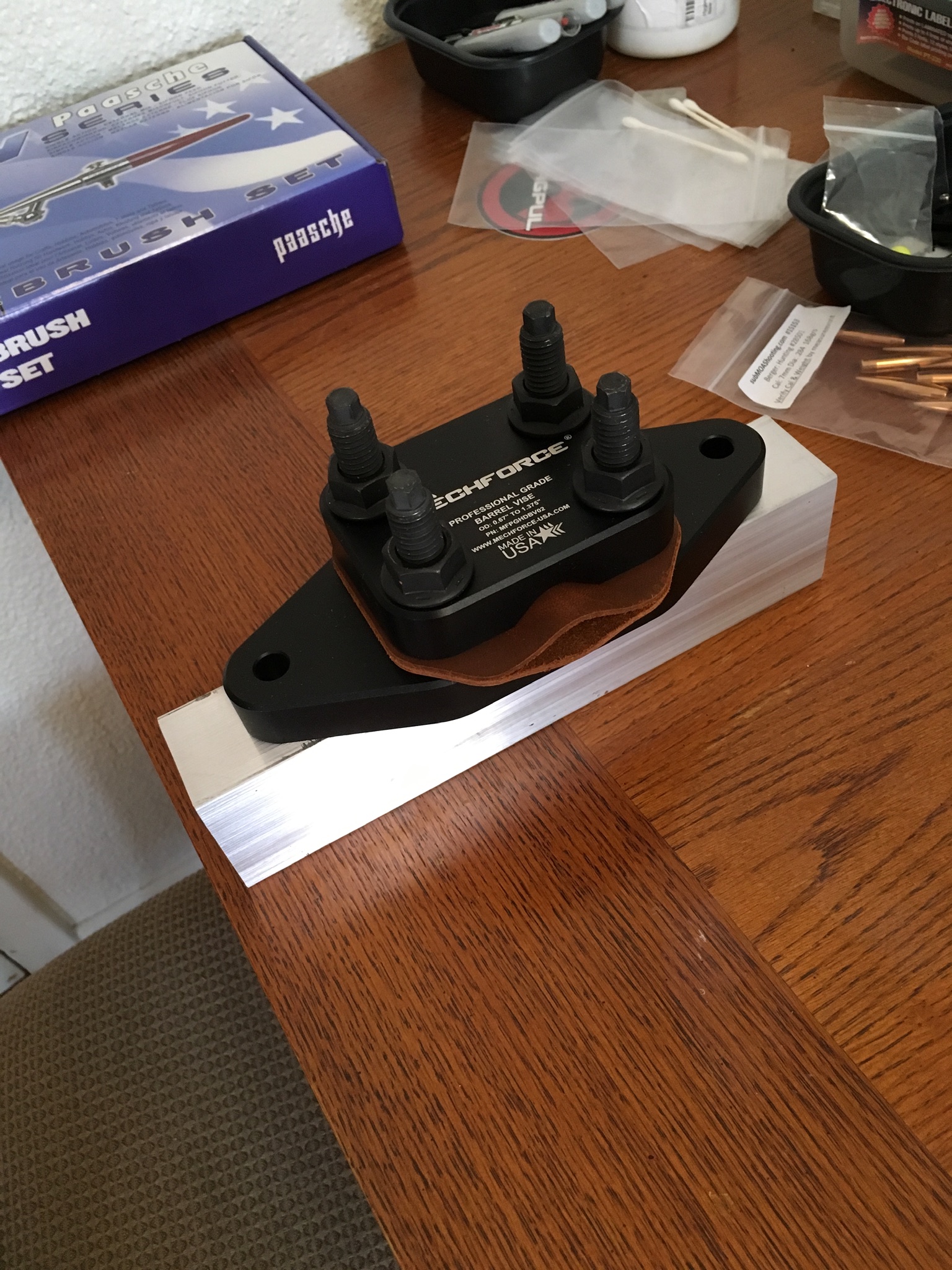

Yea I have a mechforce which is very similar. Great for installs and brakes but USELESS for removing a stubborn 2010 Rem 700 factory barrel. I had it so tight I actually started to gall the threads on the bolts........
One thing I did to mine was mount it on a 2 x 3 x 8 inch piece of aluminum bar. That way it clamps into my heavy vice at will instead of bolting it down.

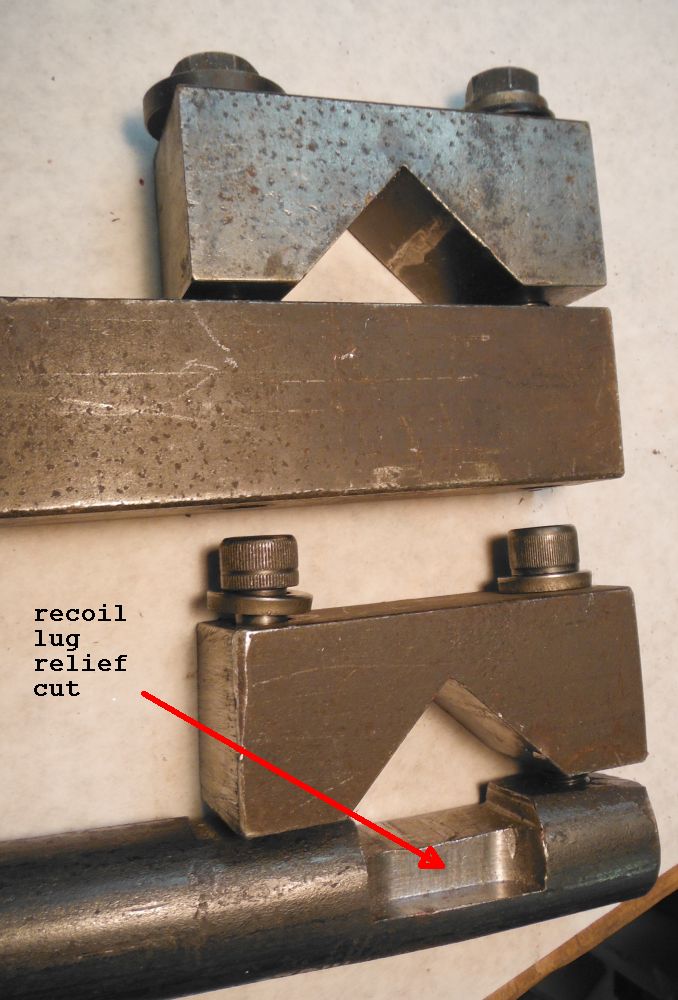

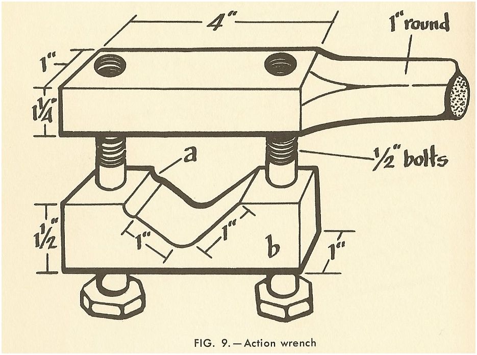

I have been making barrel vises and action wrenches for years.
1) I learned that 1/2-13 bolts in any grade can snap in a barrel vise. I use 7/8-14 like reloading die threaded rod. 1/2-13 is fine for action wrenches that do not have to create huge forces of compression to increase the coefficient of friction, like when gripping a barrel.
2) I learned that the action wrench must support top and bottom in at least one cross sectional plane down the axis of the receiver. That means there is a mistake in the otherwise great gunsmithing book by MacFarland. Put a Mauser action in that wrench and there will be a bind. This can be fixed with a relief cut.
3) I learned that Rem700 actions in action wrenches [that look like barrel vises] can pinch the threads and cause galling. I now use the wrench that goes inside the action and turns against the bolt lug race ways.

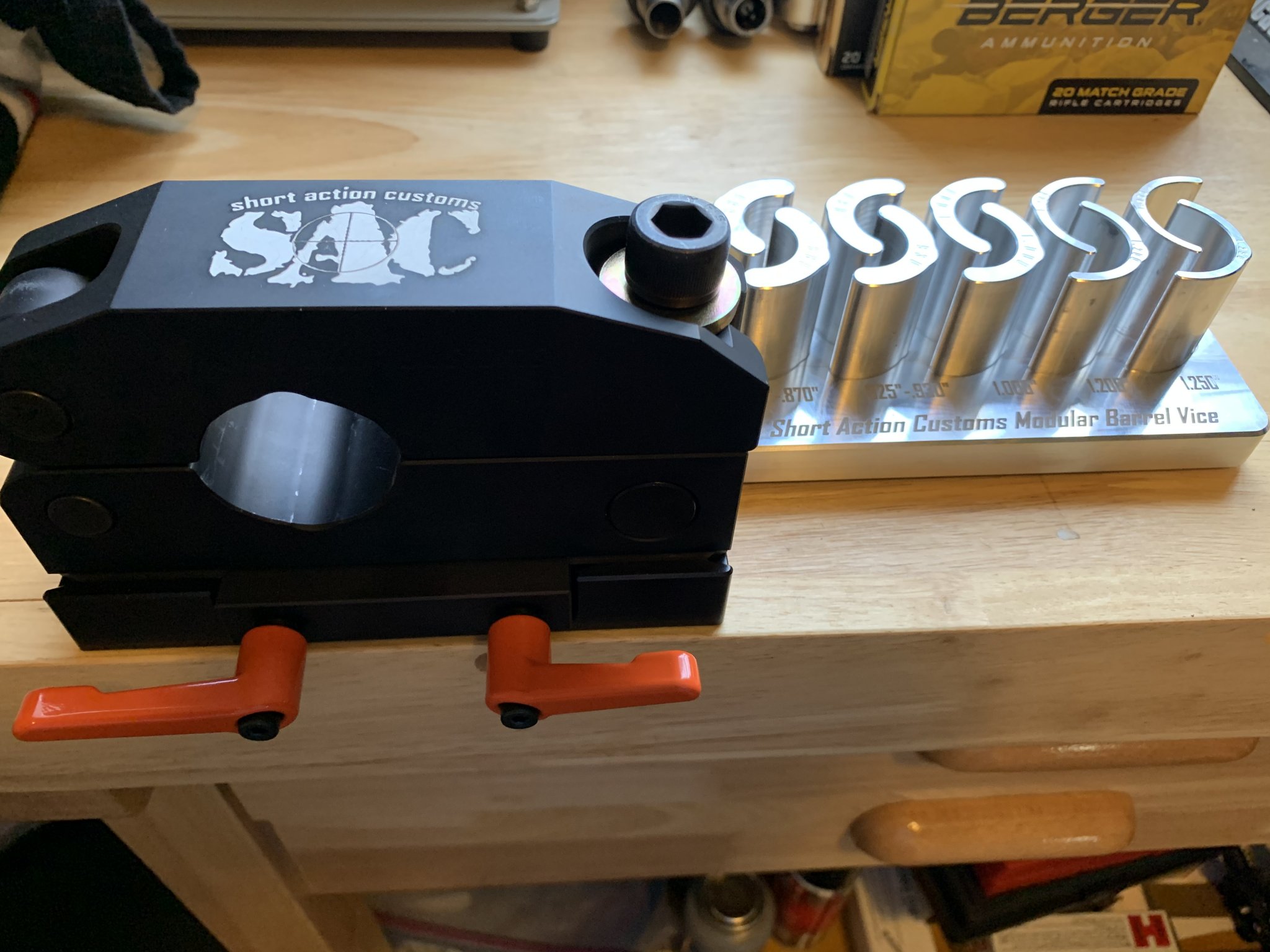

Recently received this from SAC. I have a Bighorn TL3 and a couple of barrels. Initially used a cheap 21st century vise, but quickly realized it left a lot to be desired. I really like the hinged design of the SAC vise with one bolt to tighten. Very easy to load the barrel into the vise, and the Arca mount base plate is really cool. I mounted the base to a piece of 2” square tubing that I can slide into my receiver hitch. It’s a solid piece of kit that will last a lifetime and never leave you wanting for more.
So, you would use the lead instead of the aluminum inserts?
No, if you don't have the correct tapered bushing (some sporter contour barrels taper dramatically) you can use lead to fill in any gaps between the standard bushing and the barrel rather than buying or making a custom bushing. You still need a bushing.
Ahh ok, I guess I will see if it fits once I get the vice in. I might need to find a bunch of fishing weights.

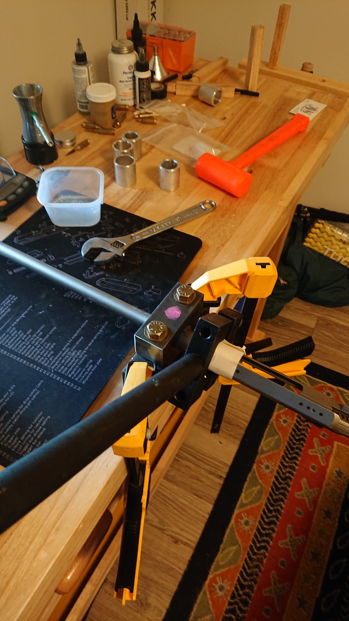

I bought a lightly used Tikka T3x in stainless. Got a Wheeler #1 action wrench and had to buy longer bolts but it worked great. Bought a Wally Cooper barrel wrench with a variety of Al bushings off eBay. That didn't work at all, barrel kept slipping, so I bought the SAC tapered Tikka bushing. Nice piece, fits great. The nubs only fit on the sides, should have paid the slightly more and gotten the SAC Bravo vise.
However, even with a 3' cheater and a dead blow hammer, the barrel wouldn't budge. I ended up having to send it off to LRI anyway. They had no problem torquing it off, I don't see any marring I didn't cause, and I had it back a week after I sent it (during the Sturgis rally too). YMMV obviously, and the wrench and vise worked great to put on the new barrel, but I kinda wish I would have just started out sending it to LRI.
I think part of the problem with your Cooper barrel vise/SAC bushing combination is you have the bushing perpendicular to the vise. The bushing is resisting the vice. I suspect you'd get more grip if the gap in the bushings were in the same plane as the vise. The nubs fit in the SAC vise to keep them in proper orientation.
Try the Brownells bushings. They don't have the "nubs".
Well, a little kroil soaking, a lot of profanity, a few scratches, and I finally got the stupid thing off. I did not mark the receiver, but the barrel receive a little scuff.
