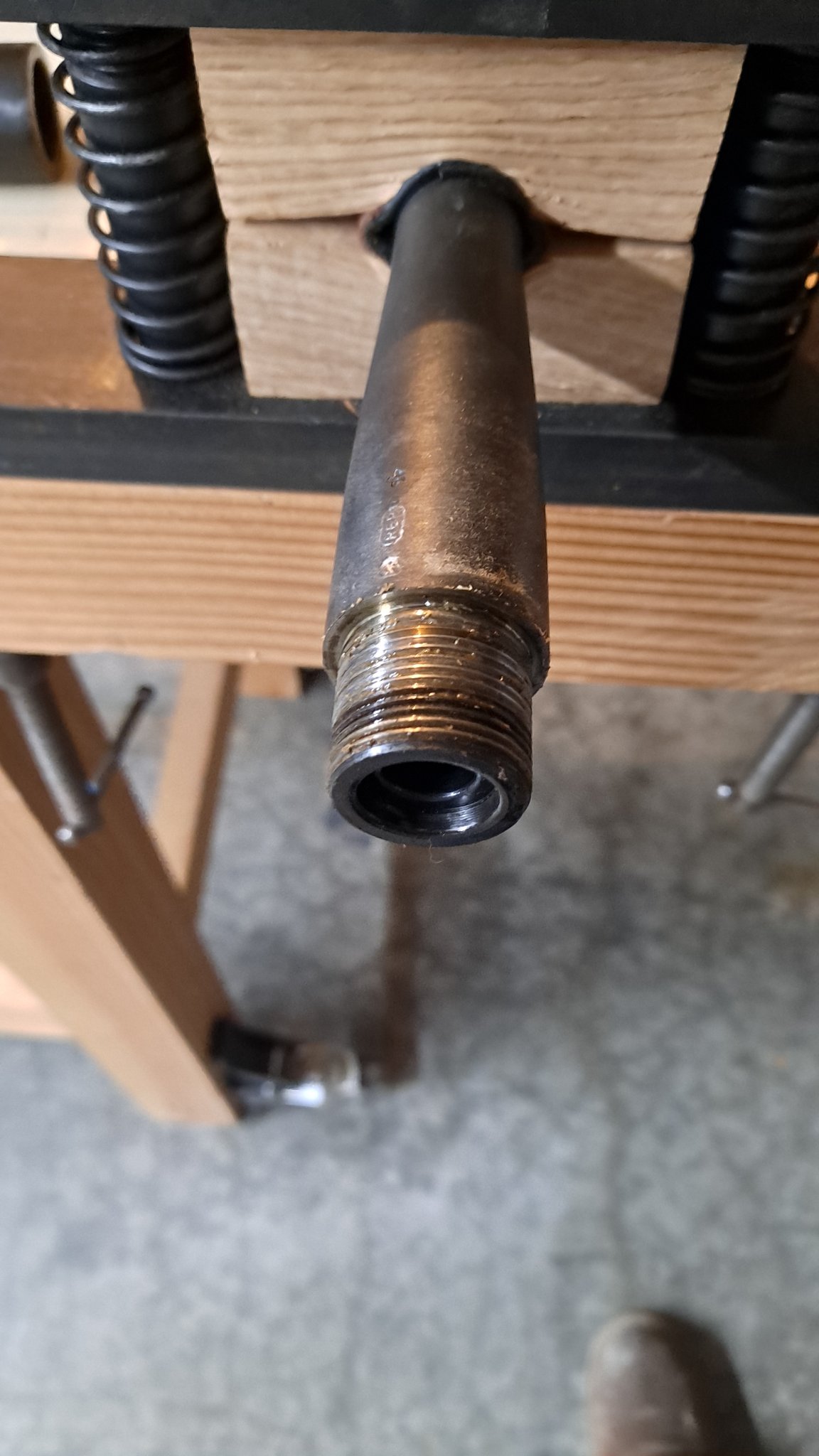

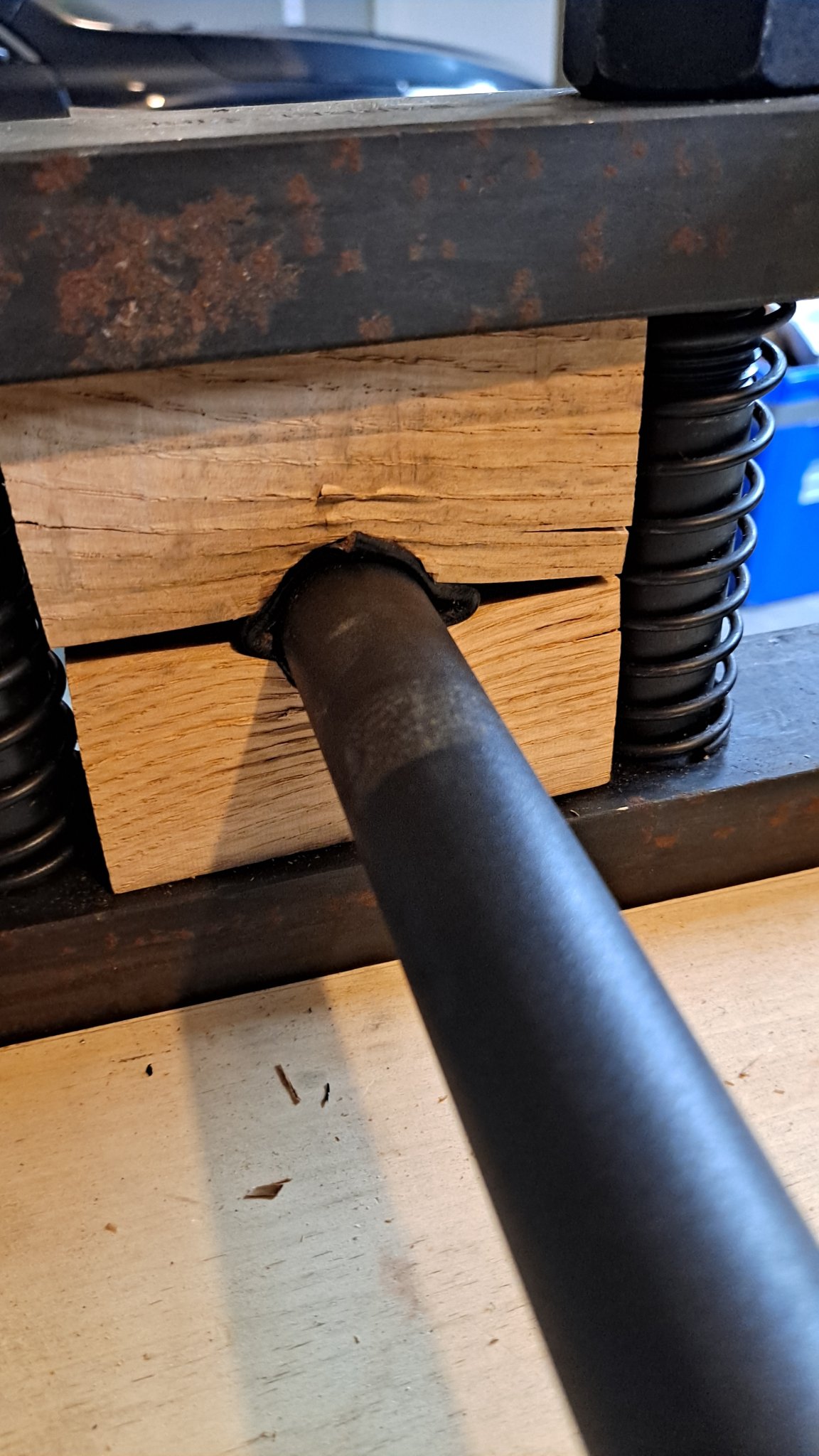

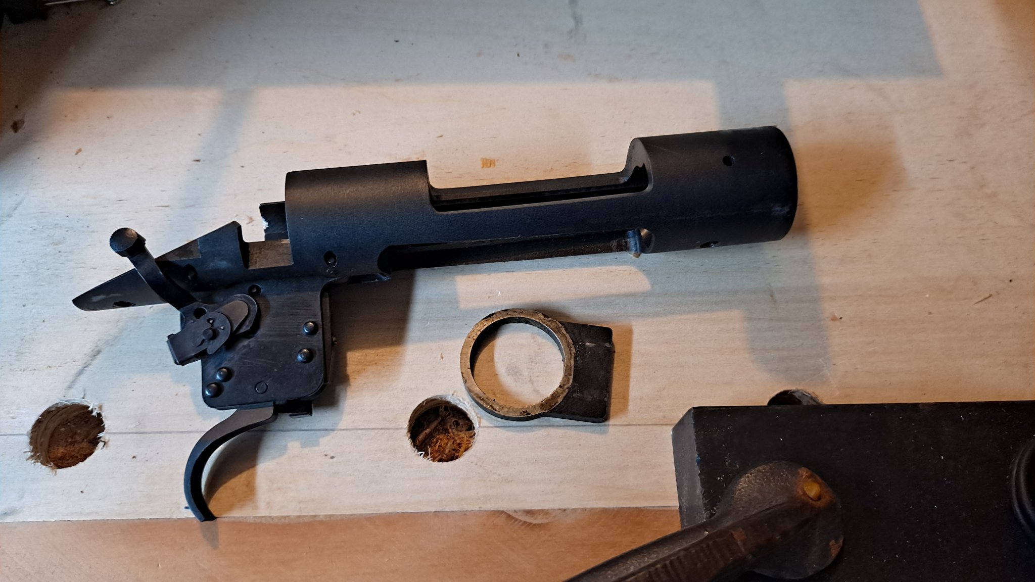

Worked like a champ! Since I'm so impatient with things like this, I managed to find an actual leather belt that no longer fit and cut off about 6". My daughter provided the extra set of hands, and with only about half of my 220lbs, this barrel/receiver broke loose. Now just have to wait for the new parts to arrive. No breaker bar needed, used a 12" Cresent to tighter the barrel vise, and a Northland Shooter's Supply action wrench to break things loose.
