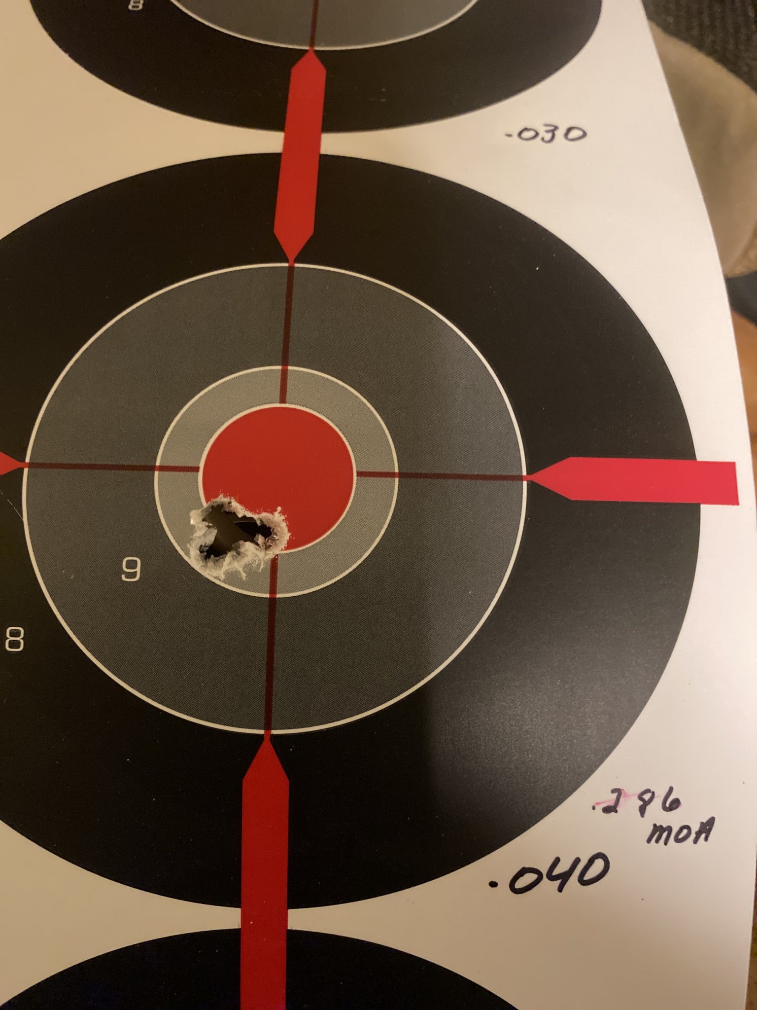

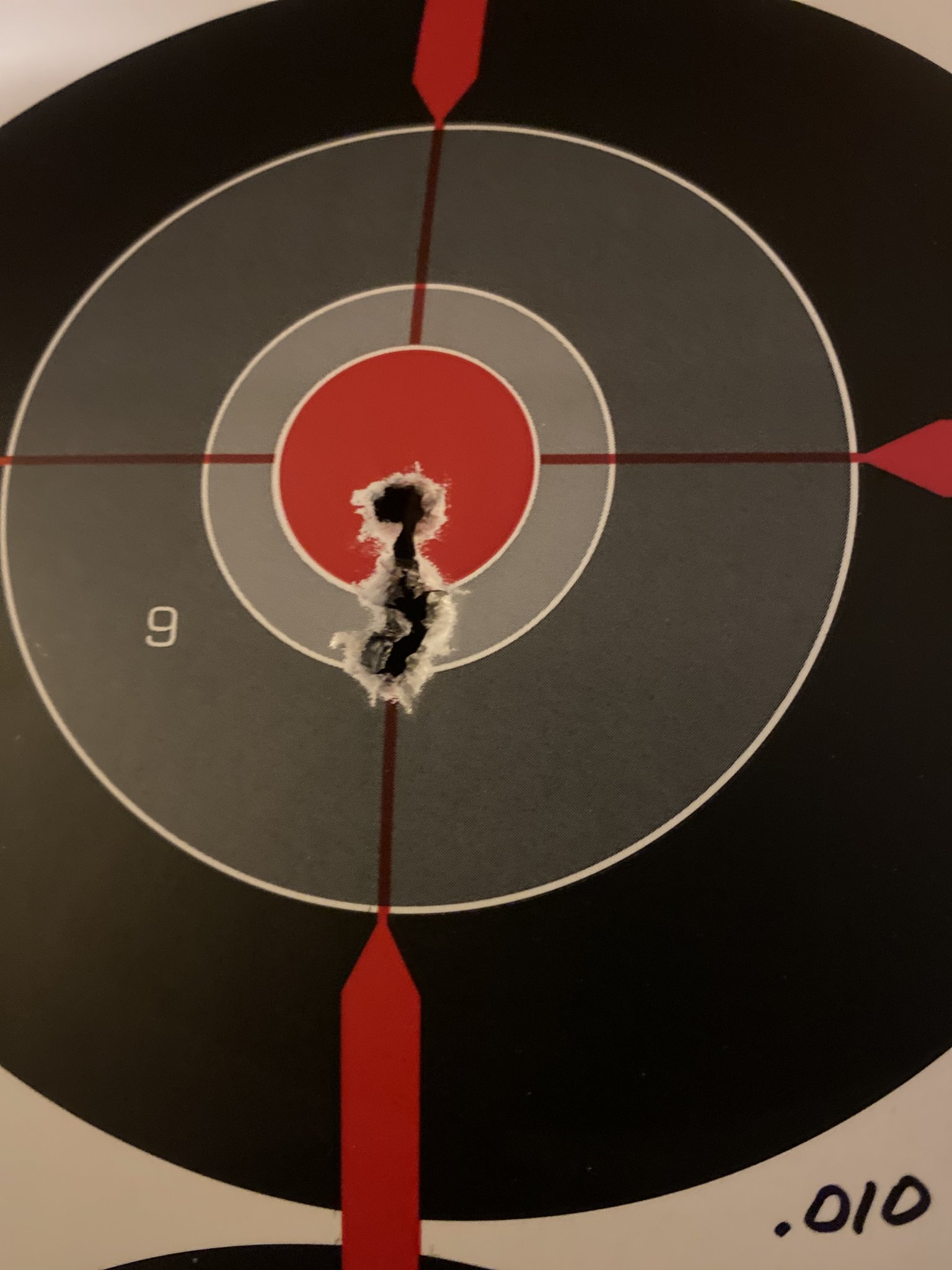

Working a load for my 6.5 Creedmoor. Currently using Lapua small primer brass, H 4831SC, Nosler 140gr match, and CCI400 primer. Settled on 42.7 gr of the H4831SC. Nice node at 2650 fps. Started looking at bullet jump. Loaded 5 rounds each .010, .020, .030, .040. Shot one of each with chronograph. Velocity went up from .010 to .020 about 30fps (surprised me), then went down from there to about 2626 at .040. Then shot 4 shot groups without chronograph. My question is for the .010 group. Is this vertical group caused by barrel whip? If not; thoughts? .020 had similar verbal group; .030 tightened up with some lateral spread; .040 shot a .286 group. I’m new at this, but just trying to keep on track and not chasing my tail. Thanks in advance for sharing experience

Hope I didn’t make you too mad. I guess the question is does this kind of vertical grouping typically indicate barrel whip? Or is this typically a velocity difference? Or means nothing at all.

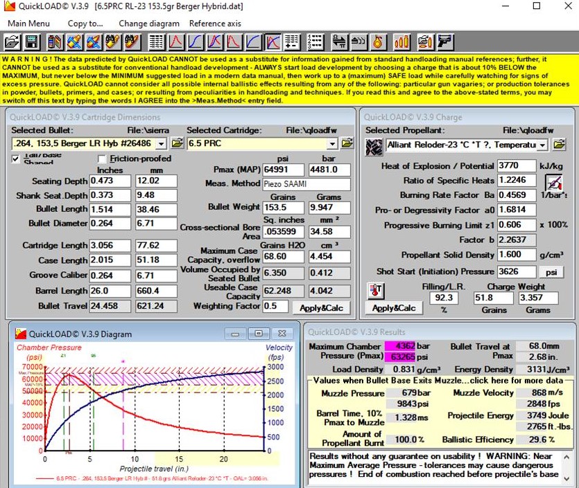

Be sure to understand the difference between "Barrel Whip" and the harmonic vibration that's at the heart of finding a "node" that give you consistent accuracy.

It may be that it likes that particular seating depth rather than the jump. Rather than load at exactly the same jump, it'd be better to load to exactly the same seating depth to verify.

Thank you for your reply. I still think a vertical grouping has a specific cause, and will continue to try and figure that out. I have 10 rounds already loaded, but the wind has been gusting at 30kn.
If you believe the three shot group, vertical usually (but not always) means a powder adjustment is needed.
Seating depth can tighten up groups. Looks to me that at that depth your load doesn't like it. But as others have said test them again, and try more than three shots to confirm what you have. Take it out beyond 100 yards.

Thank you for your response. I completely understand sample size. The same powder load was used in both the over 1 MOA vertical group as the .286 group. The variable used in this very small testing was seating depth. All four of the projectiles in the vertical group are touching. The difference at the muzzle between the top and bottom of that group is very small. I compile and analyze data for a living. I look for clues in the data that elicit response. I believe this vertical group is a clue. I’m thinking of moving closer to the landing .005 and maybe away .005. I did see a velocity increase between .010 and .020 that I did not expect.

You’re attempting to connect dots that aren’t there.
It could have just as easily been your breathing or rear bag use that resulted in the vertical stringing.
Also, your velocity isn’t going to jump 30 fps from .010 to .020 but then drop as you moved to .040. It’s not going to do that with that slight of change in capacity, but then turn and go completely the other way when you continue to decrease capacity.
If you analyze data for a living, you should absolutely know that you’re chasing your tail trying to find signal in all this noise.
I’d also suggest not starting out saying you’re new to all this, but then correcting people when the answers are not connecting the same dots. It’s a quick way to not getting much help.

True, but I don't believe that was part of this discussion. The OP got his best group at .040 off. He should continue to experiment at .040 off. Now if he changes bullet lots then he will need to make adjustments. I guess I made the assumption that most folks don't use bullets with wild variation in bto. However I shouldn't assume.

OP has listed jumps from .010 to .040 and was asking about the vertical he got with .010 and if it had anything to do with barrel whip. Neither his COAL's or his jump is useful in advising him any about his question regard barrel whip. My response (in post #6 of this thread) was to encourage him to find out (do some research) what the difference is between "Barrel Whip" and the harmonics that we all try to tune out loads to; because they're not the same thing. And barrel whip is not what causing that vertical with that .010 off the lands as barrel whip occurs after the bullet has left the muzzle. It's the barrel time of the bullet that's not in time with the harmonics of his barrel. I don't know if the OP can understand this if he doesn't know the difference.

The hottest temperature on your barrel is always at the front and cools down moving to the muzzle. It's that extreme heat the causes fire fracking and the throat erosion.
Though burn rate is often emphasized, it's not the only factor on how the pressure performs in the chamber. The heat index is also a key factor effecting the pressure curve.
Take a close look at the details in pic below from a load of mine as depicted by the QuickLoad app. The graph on the bottom left should give you a good idea how powder burn and pressure progresses down the barrel.
