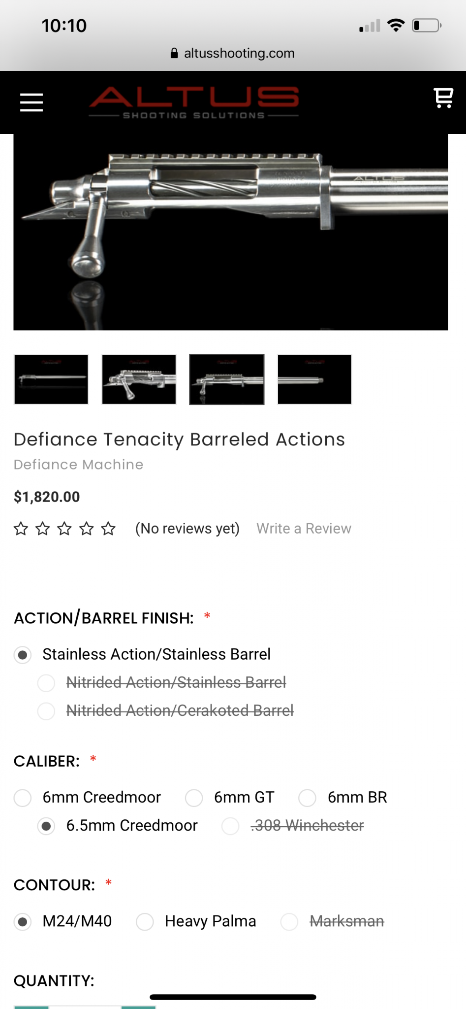

What’s everyone opinions on a barreled action vs a full custom long range gun for hunting.
this will be used out west for mule deer and elk.
i have been doing a ton of research and have come across a few barreled actions, the turnaround time is far better vs a custom Build and cost seems to far less. I don’t mind spending the extra if The extra cost and lead time is worth it in the long run
Thanks in advance
That price doesn't seem like it's saving anything. Right on the ballpark of they are using a good barrel. Actually seems a smidge high.
Action-$900
Barrel-$350
Chamber job-$400ish
=$1650
Not sure of the details of what all else might be included at that price of the screenshot.
In stock and ready to ship could save time though. Depends on the smith but there's plenty that'll cut a chamber and spin on a barrel pretty quick.
Could also buy the action and buy a shouldered prefit and screw it on yourself. Many higher end actions that's an option. Including the Tenacity you pictured.
With 0 effort I found Straight Jacket Armory has Tenacity shouldered prefits for $650. Not sure on quality or wait time etc...like I said that was a quick Google search.
So you could be at like $1550 with that barrel...
Lots of ways to skin a coon.
Action-$900
Barrel-$350
Chamber job-$400ish
=$1650
Hmmm your learning me some things 🤣.
Is there much of a downside to buying shouldered prefit vs sending it out and having everything done by a smith?
I’m quite new to all Of this and Don’t want to wish I had spent the money differently
I have a Howa 1500 barreled action in 6.5 and it was $500 from Brownells. Add in a Boyd’s stock for $200 and a Vortex PST 2 for $900 and you are almost all done save some rings and bedding. It’s almost as accurate as my Tenacity barreled action which alone cost 3 times as much. I like my Tenacity but all you really need is one flawless cold shot and both are more accurate than I am. So get what you really want but don’t think that spending another thousand will fix poor technique.
Reactions: Falkner
I can't really help with a shouldered prefit vs a smith chambering the barrel and screwing it on. If the barrel is of good quality and the chamber is cut right on the prefit, it'll all be the same.
Example....I can call Kelblys tomorrow and order a chambered barrel to fit my Atlas. It'd be no different than me sending them the barrel to chamber.

I just got a tenacity for $850 and a PVA prefit threaded barrel for $550. Thats $1400 for what the same setup as what they're asking $1820 for. Granted my way you may have to buy a action wrench and barrel vice and go/,no go gauges ($100,$60,$100) if you dont already have them but you'd be able to swap barrels whenever.

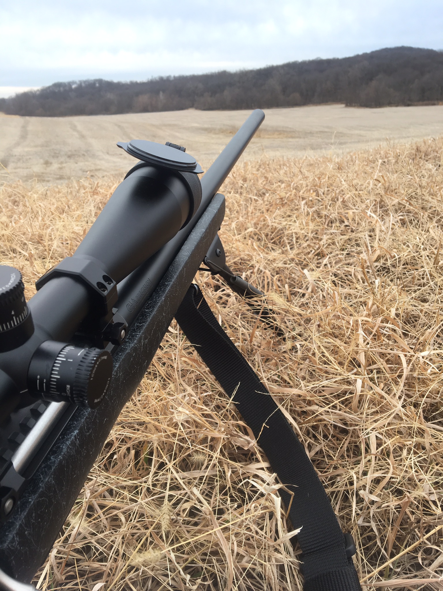

I left it to RBros to decide on reamer specs; my parameters were to have chambering and throating around the ELDM as the factory loads were readily available. Since then, I have loaded Bergers and A-Tips and they shoot just as well as factory loads when I do my part.
I had a Tikka in .243 and mostly hunt coyotes but the rifling and what I was shooting did’t jive. So I had George at GA Precision take my action and a Bartlein barrel, do their magic (6mm Creedmoor now) and now I’ve got a super accurate rifle shooting groups of 2 inches at 450- 500 yards for under $1500 total. Couldn’t be more happier and with my reloading getting better I’m hoping to shrink those groups.
