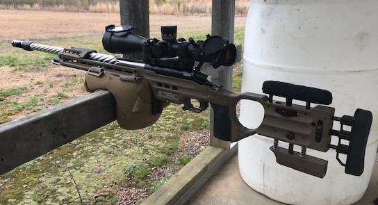

Go through PVA for the barreled action. I got my Osprey barrel at PVA for my TL3, same bolt face as Origin, and with the MDT mags it feeds like butter. Lots of fun to shoot. Even if you get your action somewhere else get the barrel through PVA. You will be glad you did. Mine is a 26" Proof Comp with spiral fluting. Length and contour will depend on what you plan to do with it. Mine is for PRS style matches. What's your plan?
