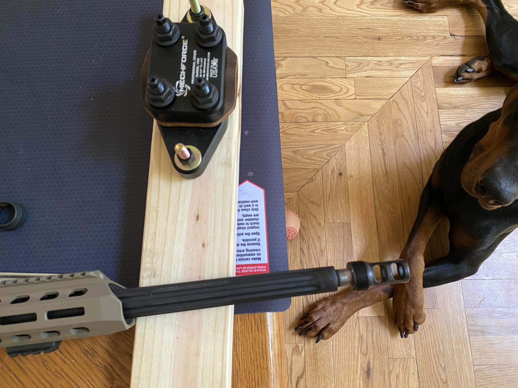

Thinking about changing the muzzle brake so I can use the suppressor I already have. But it seems the factory brake is super tight. I torched it for two minutes and it still won’t budge. Anyone has any tricks to share?

I have been using a tipton gun vise to hold it.
I figured you’d say something like that. Don't do that; you’re basically bracing the barrel against the locating pin and the receiver thereby sending all the torques into those instead of the barrel when you’re yanking on the muzzle device.
Or at least that’s this white collar man’s understanding.
That's a good point. Hopefully I didn't do too much damage to it.

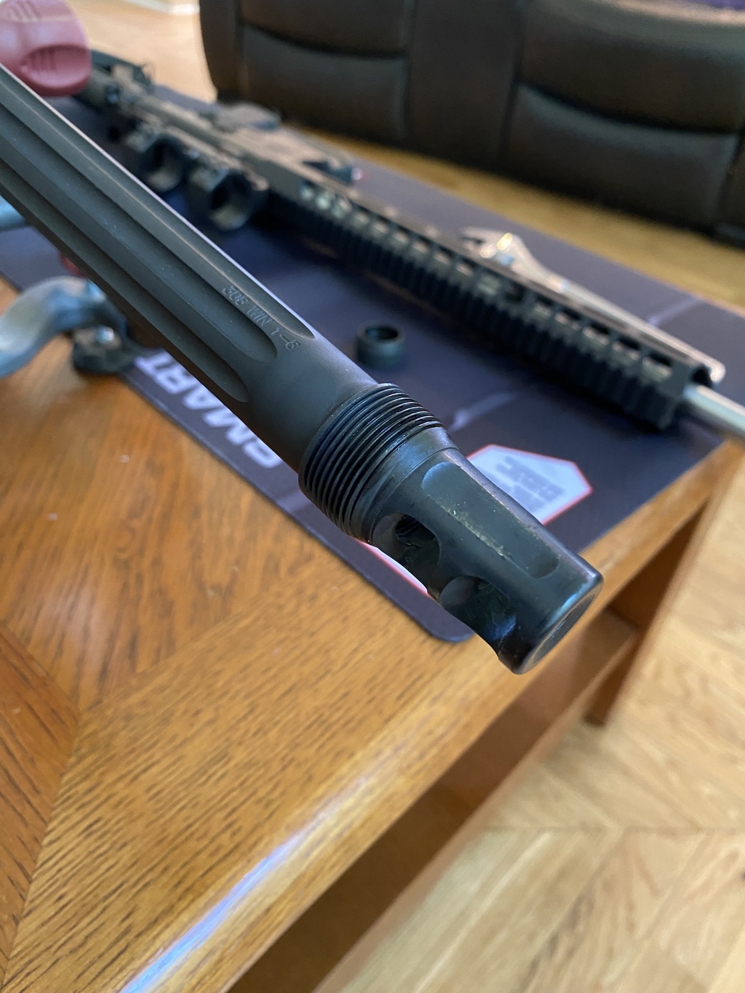

I was also able to get my muzzle device off with little to no fanfare.
As a data point, my 17 inch .308 barrel DID have red loctite on it. Not a lot but enough to notice it. I hit the muzzle device with a torch to soften the loctite prior to removal.
Easy day.
Reactions: roberthu526
