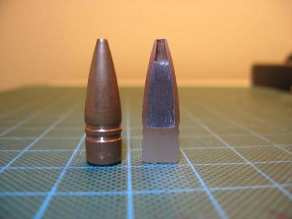

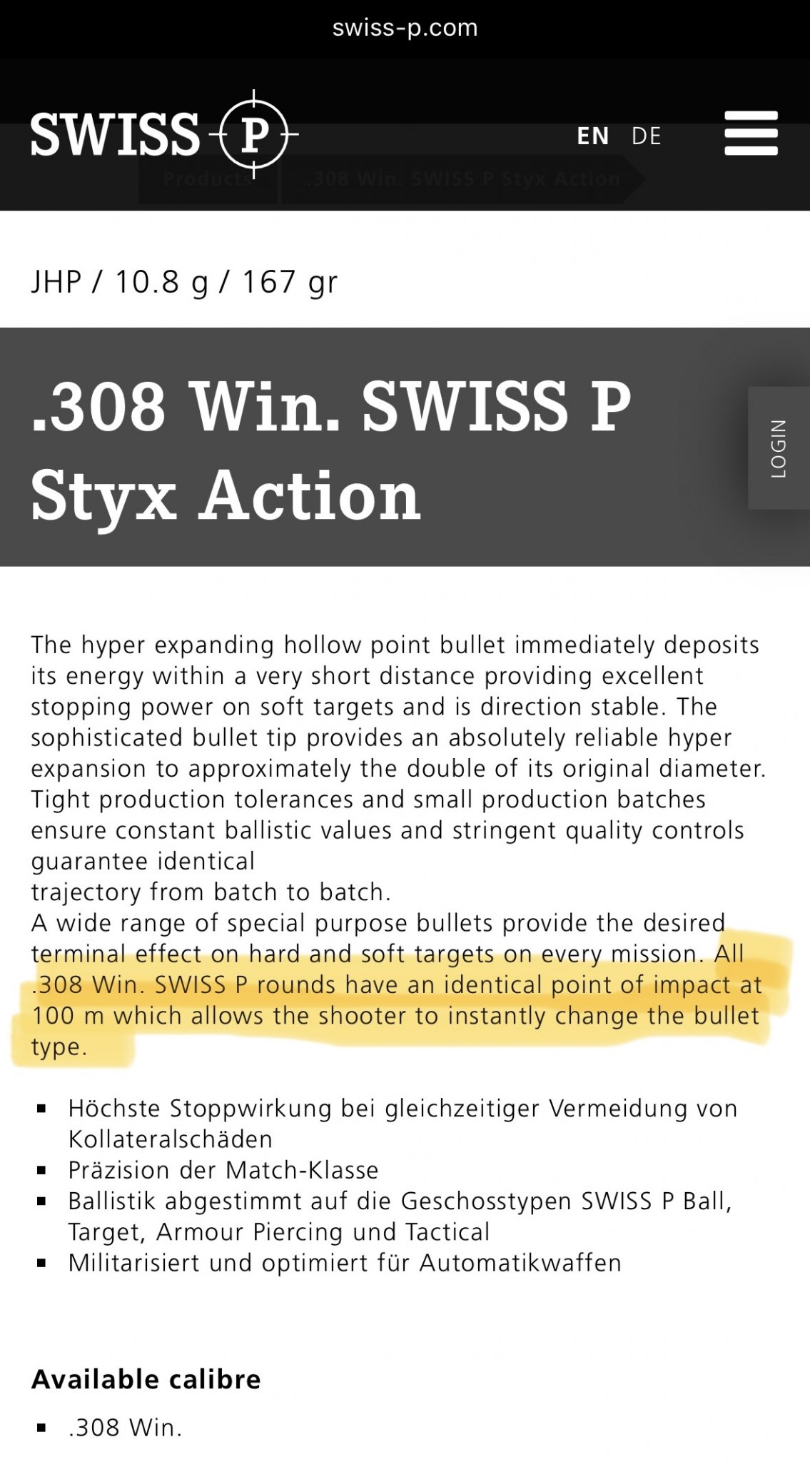

According to the Swiss P website, the Styx bullets sound like they behave more like a Berger VLD bullet, so I agree it’s going in the opposite direction than the OP’s stated use case.
The thing that interests me is the website claim that the various Swiss P loadings are designed to have the same point-of-impact at 100m. If that’s true, you’ve opened up your options for days when you aren’t training for shots through barriers. You wouldn’t burn through your barrier blind rounds when shooting at paper or steel.
The grain weights are different, so there’s that, but maybe two cartridges from the same manufacturer with close to the same bullet weight would behave more similarly than two cartridges from different manufacturers with the same bullet weight.

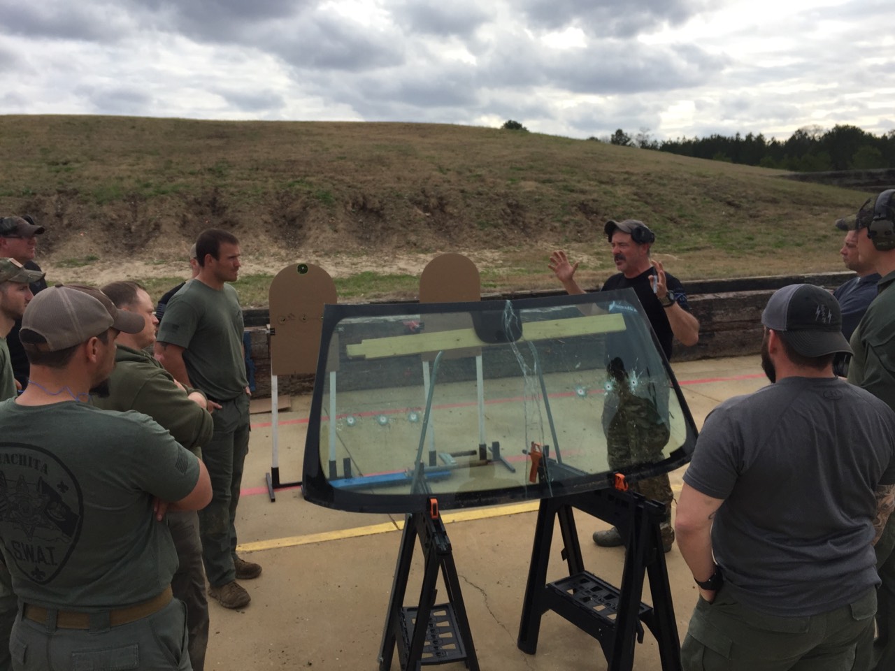

We ran the SMK through windshield glass from a few of different angles as well as different windshield angles. It surprised us how little deflection it actually had when the targets were in the front seat. By the time we did some rear seat shots the rounds started doing some funky things and it was impossible to account for

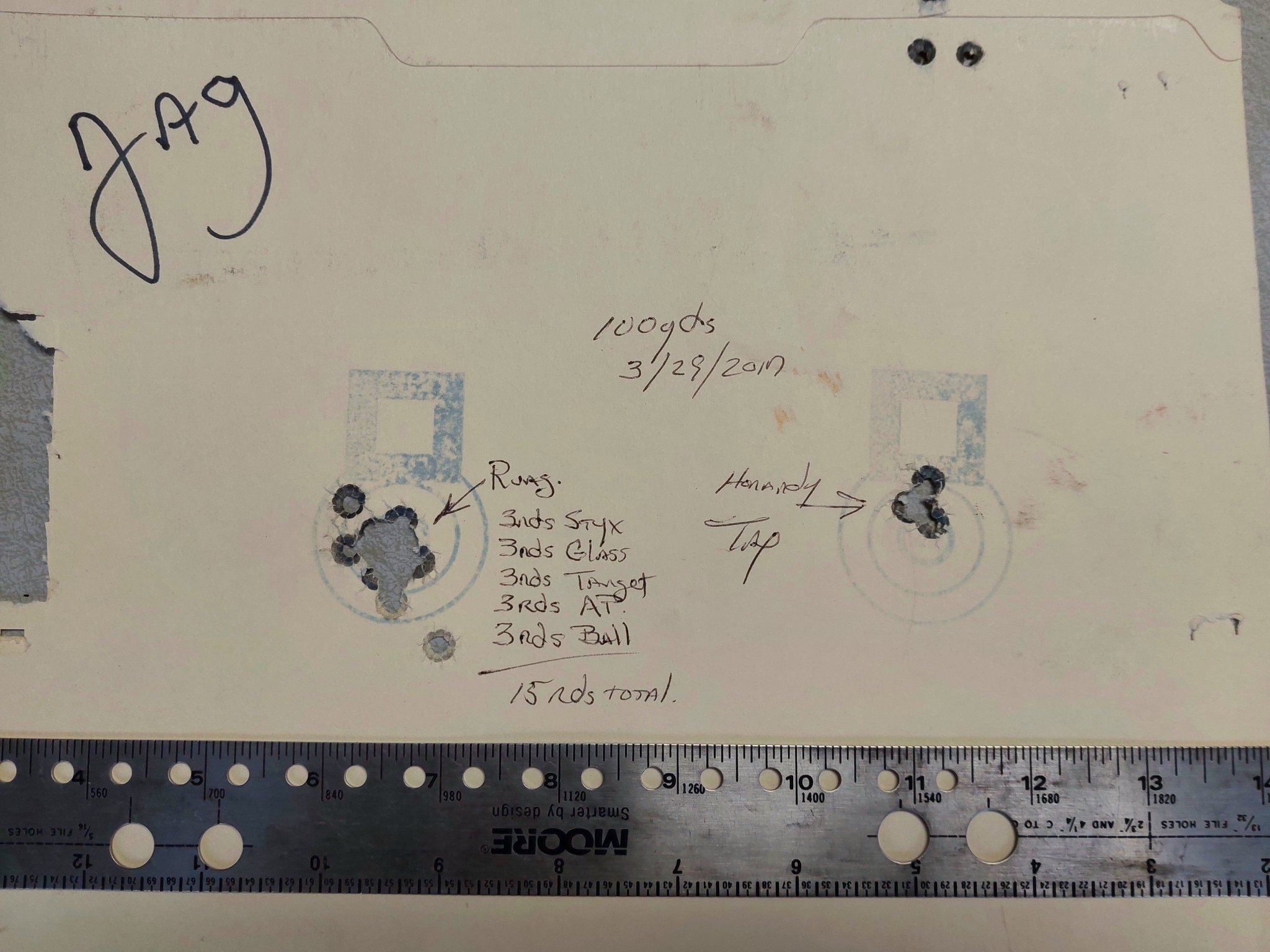

OK. I finally remembered to go dig this target up.
I fired this particular target almost 7 years ago during a demo at a SWAT conference. We are still seeing enough of this showing up in classes and training to believe current RUAG production will still perform similarly.
I fired these 18rds total in about 3 minutes from prone with Harris bipod and TAB gear rear pinch bag with a bunch of goons standing around.
I unboxed 3 rounds each of RUAG Styx, Tactical (I wrote "Glass" on the folder), Target, AP and Ball.
I tossed all 15rds into a hat, shook them up and laid them to the right of the rifle.
I got on the gun in a prone position and loaded 3 rounds of TAP (I am a Federal ammo fan but had none at this location) in the magazine.
I shot all 3 rounds of the TAP at the right bullseye.
I immediately started fishing one round of RUAG at a time out of the hat and firing at the left bullseye until I had all 15 rounds sent.
*I am pretty darned sure I did something stupid on the gun that sent the wild shot down at 5 o'clock.
So, I'm not a very solid group shooter but we were still impressed with the results from this impromptu demo.
I don't remember which of the 5 types that I threw the one low, right shot with but I know we pulled 3 more rounds of that type and shot a separate 3 shot group on a side target that was as tight or tighter than the TAP control group.
To me, it just reinforced that the outlier shot of the 15 was due to redneck upbringing and not the ammo.
I have no doubt that if a better shooter and rifle were to take time and do a more careful test, they would have even better results.

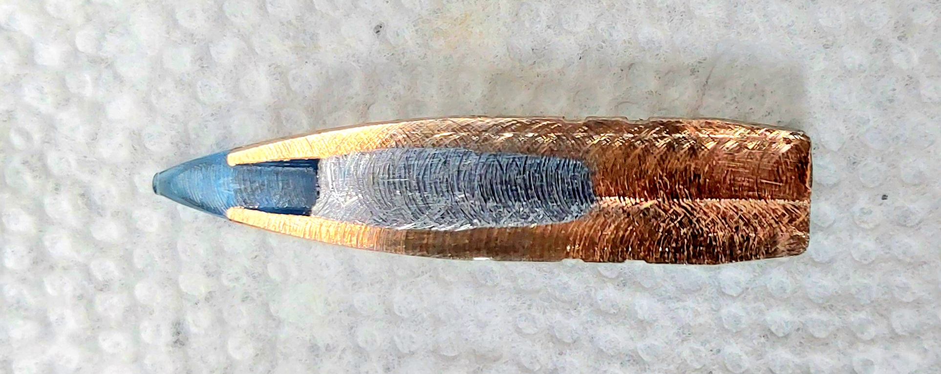

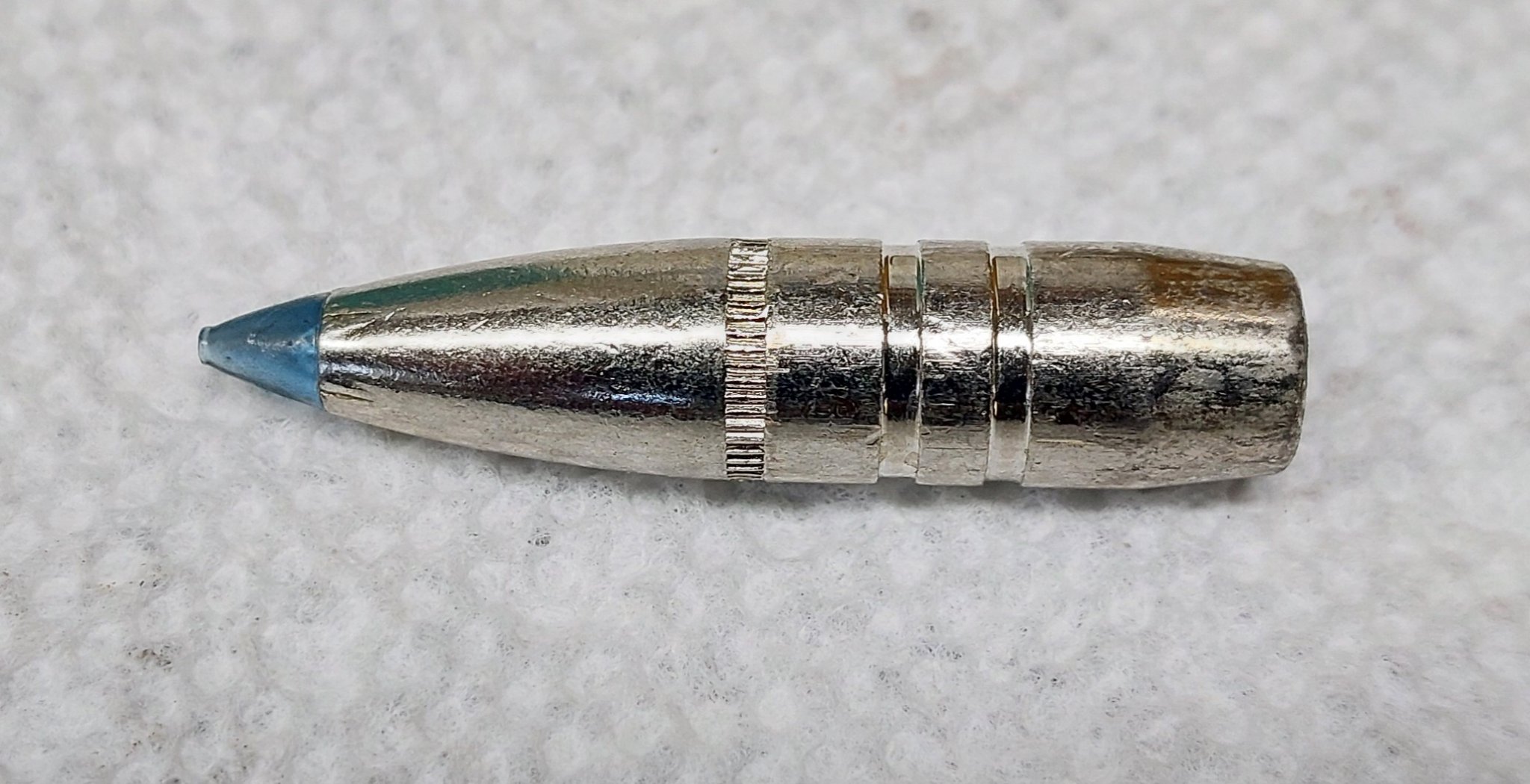

Hope this makes sense and is worth the time.
I could not readily find a pic of the bullet used in the T2 (I'm sure they are out there) so I just grabbed a T2 round and pulled the bullet.
See below:
I sectioned the bullet and it was just like I remembered seeing on a PowerPoint a few years ago.
It isn't pretty and polished but you can get the picture.
Minimum lead core with high antimony % and bonded to the jacket.
Jacket is very heavy and tapered from the base to the tip as with many popular big game bullets made for penetration.
Now contrast this 168gr above to the SOST 130gr (below) with conventional non-bonded core and very conventional jacket walls. The only significant thing the SOST shows is a heavy copper heel that I guess they were hoping would enhance penetration.
Also, note that the top groove in the jacket is positioned at the point in the jacket wall level with the bottom of the core.
I know you know this but I'm going to throw it in for a few others....
Not being bonded, this jacket will tend to peel and separate when transiting a barrier and as it peels, the jacket will break at the weak spot toward the bottom of the core. This fragmentation divides the mass which causes more surface area in motion which causes deceleration which costs energy which costs penetration.
Even if it somehow managed to get most of the pieces through a barrier, the post barrier tracking would be a shit show with zero consistency.
The bullet integrity failing while trying to negotiate a barrier would also generate a shit ton more unnecessary spalling than other proven rounds.
Take a look at this homemade stand.
I made it a few years ago for less than $45.
It comes apart and folds down flat for storage or transport. It can adjust the glass angle easily. It can trap flat panels against the bracing at 90 degrees.
We use it a lot.
**NOTE: The yellow board in this pic is not part of the stand. That was just a scrap piece of wood to help stabilize this windshield that had a major fracture all the way down the middle.
If interested, shoot me a PM. I can share a couple of better pics and some details without derailing this thread any further.

First off, I’m not a ballistician or an engineer or anything special at all, but I did stay at a Holiday Inn Express last night…
And I apologize, the title of your thread has to do with barrier rounds with similar ballistics of GMM and I saw some posts on BC and MV, I’m assuming you are at a PD in the US so I’m writing from a standpoint of short range open or barrier applications from a LE viewpoint so I base my ammo selections on POA/POI, accuracy (short distance), TB, and performance in LE specific applications and not in tech specs or long distances/factors. Again, I have very little knowledge of that kind of info. Any knowledge I have (which is very little) is confined to the LE application of precision shots of 308+ calibers.
Secondly, everyone here is very knowledgeable, smart, and has a ton of experience so absorb all that they have offered. That being said, and you probably already do this but if you haven’t already I would encourage you to go out and build a windshield holder out of a couple sawhorses and a res window holder out of some stands and clamps. Any windshield replacement shop will give you all the windshields you want and res glass window businesses will donate windows to LE for testing in my experience and with some goodwill. Get a bunch and then shoot your duty and a bunch of other different types of rounds through glass for yourself and your supervisors/agency. Stack cardboard targets on stands behind the glass every couple feet or so as a cheap way to see what each one does as far as separation, spawl, glass frags, and bullet behavior. We also check deflection and as a result no longer take that into account for our POA. Our ghetto method for that was to have a shooter staged and rifle safe, keeping the rifle parallel to the end aiming target. Shooter aims through the glass and we place a 1” dot on that rear target as his aiming point. Then via radio we place a 1” dot on the windshield at his direction so that it is lined up in the exact same spot/plane (as best we can) as the rearmost aiming end dot. We are trying to eliminate any shooter induced miss that we may interpret as bullet deflection by glass angle or rake. Once those two dots are set we then fill in the space between them with cardboard targets starting right behind the glass all the way back to the rear target. Then when shot is fired we can see where the round hit on the windshield in reference to the dot there and compare to the impact at the rear dot. As you know we rarely see every round fired punch the very center diamond of the target dot every time, and when aiming through the windshield at a dot behind it and firing, how would we know if the round on the dot behind the glass was high or low or left or right due to possible deflection or shooter induced? This way we can compare the two (impact in relation to dot on windshield compared to impact in relation to dot on target behind windshield) and make a deduction. Plus the targets in between show all the behaviors and pieces and travel/path of the bullet and bullet/glass pieces. I’m sure tons of guys have been doing this already but we only started doing it a few years ago after a training course where someone said the military tested glass deflection in a lab setting and found there really wasn’t any, at least in our application/distance with specific barrier rounds.
So we wanted to see for ourselves and this is what we came up with and we’ve found (again, our opinion/observations only) that there was little to no deflection given a good barrier round at a target behind windows at pretty big distances (20+ feet behind windshields and 30+ feet behind res windows) with a ton of induced angle/rake, so we removed that thought or worry or factor from our minds on our very specific/limited application. Obviously there are tons of factors of caliber, bullet composition, speed, etc but with the ruag tactical and T1 etc it’s not a factor or thought for us now.
Disclaimer: This discussion only applies to our 308/338 barrier rounds fired at glass in specific situations, NOT firing pistol or carbine rounds of all types from inside out of cars or vehicles and bullet behaviors in those instances, if that makes sense. And this pertains to average/standard res windows and windshields only, other glass types (commercial, fire rated, commercial laminated and plexiglass etc) are a whole other ballgame. For that go to your bigger commercial glass outfit and ask for samples of glass they put up in schools, gov buildings, commercial places (banks, 7-11’s, etc.) and shoot those as well and then get a 338…
Now for more info/opinions:
My ammo supplier said that the Federal LE 308T1 has been discontinued. T2 is their (federal’s) only LE barrier round now for 308 that I know of. I think Speer is part of federals parent company? But honestly I’ve never tried their GDSP 308’s that come in 150 or 168.
And I’ve been told that Ruag’s tactical has changed or is changing to a 164 from a 163? I don’t have any of the 164’s yet though, just 163’s.
And another disclaimer, (my opinion only!!!) I’m not a Hornady TAP fan at all. Any kind of TAP. We’ve tested/tried it and did not work for us in particular. I’m not talking TB or barrier performance but POA/POI, FTF and accuracy in our guns. But they do have the 165 GMX that some folks have and/or use for barriers. I know it works for lots of others though so you can prob disregard all that info. And apparently Terry can shoot good groups with it!!! But for us we have 14 guys/guns and we have to pick the ammo that shoots best overall for the group and Terry made them so they shoot federal very well but we haven’t had much luck with Hornady from FTF’s to accuracy etc. we shoot with lots of outside agencies at our trainings and when they all switched from TAP to federal T308T they said it made a big difference and they haven’t looked back. But all guns are different and some shoot stuff better than others. Our guns can prob shoot tap just fine we prob just F’ed it up, cause Terry showed above that his guns shoot tap very well!
It’s all anecdotal and individualized but in our testing we saw (again, our opinion only) too much going on with the T2 through window barriers (residential glass of different types as well as windshields etc.) and we weren’t comfortable with it in its application of shooting it at a suspect with an innocent right next to them and in close or not so close proximity to the barrier. But I know a ton of agencies use and like the T2’s. The T1’s did much better (again, our opinion only) but weren’t as accurate overall. But we used T1’s up until recently due to how it performed through glass specifically. But due to the T1’s accuracy, POA/POI in conjunction with our open air rounds of GMM and T308T we wanted to explore a change and ran some more tests.
The Ruag Tactical (glass barrier) rounds performed the best by far and hold a very good POA/POI in conjunction with GMM or T308T (at least in our guns, all KMW’s) and shoot small groups as demonstrated by Terry’s pic above. We made the switch from T1’s to the Ruag barrier for our 308’s. We also shoot the ruag (and always have) out of our 338’s at Terry’s recommendation. I’d shoot all ruag in our 308’s if we could, if money were no object. But unfortunately it always is.
Be prepared for extreme sticker shock on ruag Ammo pricing. We are fortunate and have a lot of support and a good Ammo budget but I just bought 1500 rounds of Ruag 308 Tactical barrier (apparently in 164 now but I haven’t gotten it yet) and paid $6,345 for it. That’s $4.23 a round for 308. And that was the best price I could find. But for the kind of shot you might be taking in that situation with a barrier round in my opinion price is no longer an object. Plus for training and purchasing you probably won’t fire a ton of your barrier rounds all the time so my thought process was to get the best barrier round possible and price be darned, whereas your open air rounds which are fired for most quantity/volume during trainings, traps and other scenarios, is where price becomes an issue due to quantity fired and the federal rounds are really really good and priced right.
Irritatingly, the other issue I ran into is that the ATF now considers the 308 ruag all copper barrier round to be AP based on their definitions so I had to submit a FET, dept purchase order, and a ton of other docs on this order. Which is funny because the 338 tactical, same exact construction (as far as I know) as the 308 tactical, is not considered AP by the ATF unless that has changed recently. I was told it has to do with 308’s being a “pistol” capable caliber and that’s why they consider it AP in 308? I personally have no idea, just some info I was told.
Anyway, get a bunch of ammo and go shoot some windows and figure out what works best for you and your gun and your agency/application.
