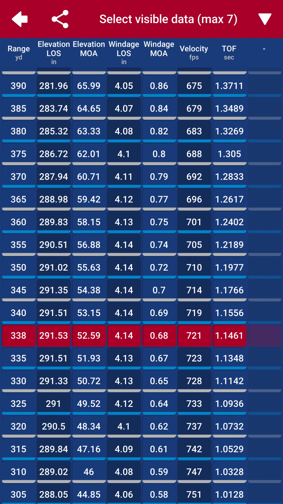

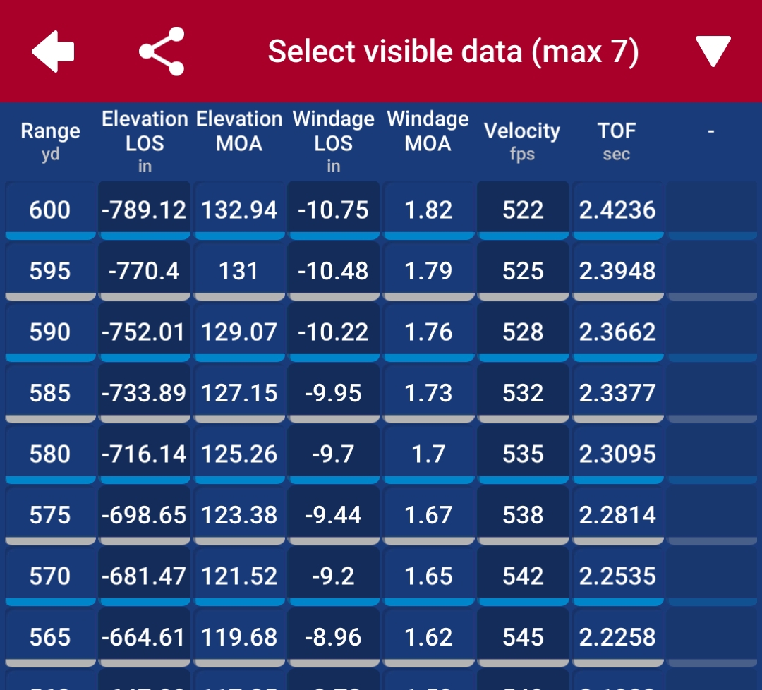

Let's talk physics here first off were not talking apples to oranges were talking apples to oak trees. Frank Green prefers about a 1/4 gain so he said, the last time I spoke with him. Knowing that 22lr round is more simular to a artillary round , where as modern center fires are liken to a rocket. We all understand that gravity is a constant no matter what. People who do not shoot past 300 yards for precision with a 22lr. Wouldnt see the adverse effects of constant forward motion. Theres a reason my every week target is 330 yds. When I shoot a 600 yard zero the peak of the arch is 338 yds. So what happens the projectile slowly climbs to this point , gravity is the same my GS is bleeding off then all then sudden I go from a controlled stable flight to a 35 % increase of additional surface deflection. Why ? The lateral axis of the projectile rotated ,the linear hasnt changed , but its stabilty is deteriorating now it has 35% and increasing forward surface pressure on it . See link for in depth study https://maritime.org/doc/firecontrol/partc.htm it's the closest to the flight path of a 22lr. My gyroscopic stability has bleed from 2.9 to a whopping .5 at 338 yards and I just started pushing my bullet forward at a 27-32 deg. angle nose down ? Hello yaw and my intended POI is but a hope now. Hence the equal in a CF would be a .308 at 2400 yds. How do I fight this linear rotation faster twist, and yes the gun should , better shoot good at 50 and 100 and 200. The last 100 yds of a 600 yd zero the bullet drops right at 12" every 5 yards. Your rifle has to be better then good. A 5 yard interval at 250 - 255 yds while ascending is slightly over 3" . That's 3.3339 times less deviation then your descent, what gives ? veloicty decrease and surface resistance increases gravity is the same. 2 of greatest accuracy robbing things alive the projectile starts yawing and deflecting off of your POI. A 16T barrel ain't the CATS ASS! for 600 yd repeatable accuracy, all the barrels I have will shoot , better then I do but some arent good for nothing but jack handles at 600 yds. Pic one shows peak pic 2 shows total drop in inches this is my dead on dope for my RIMX.
Reactions: DavidBoren
