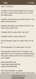

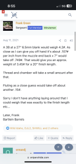

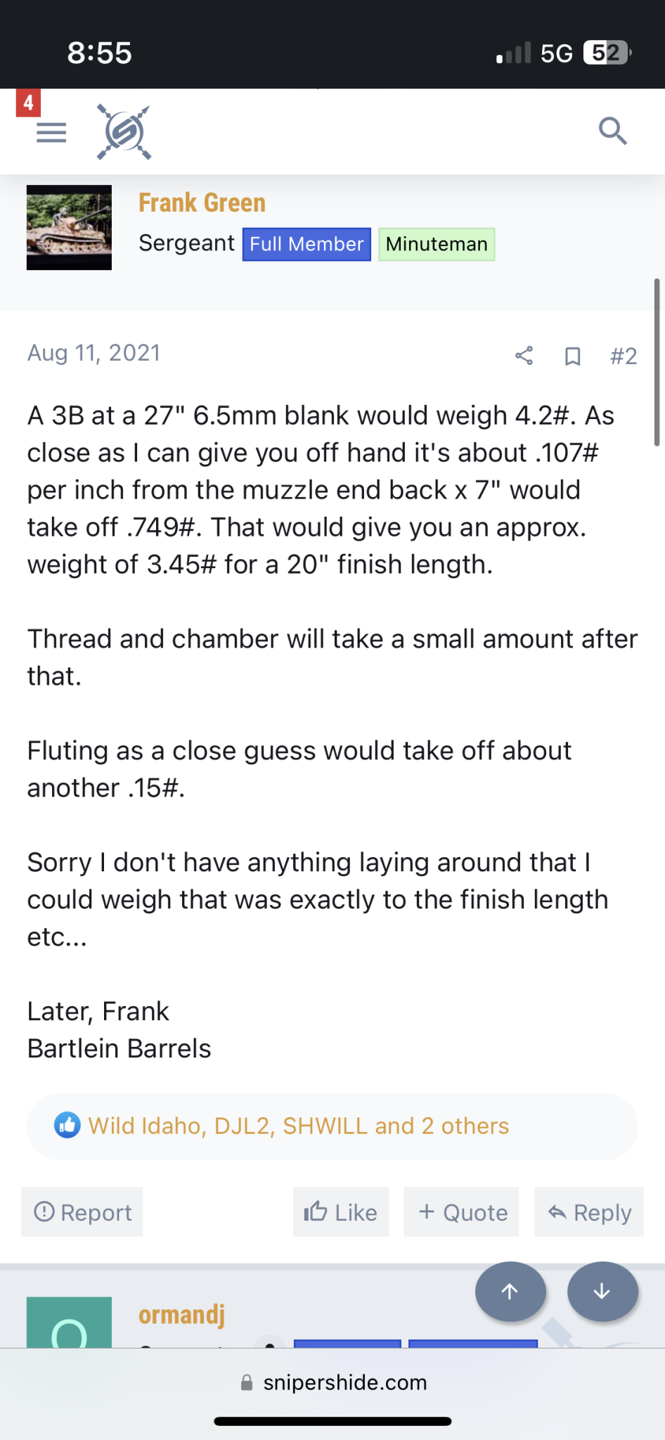

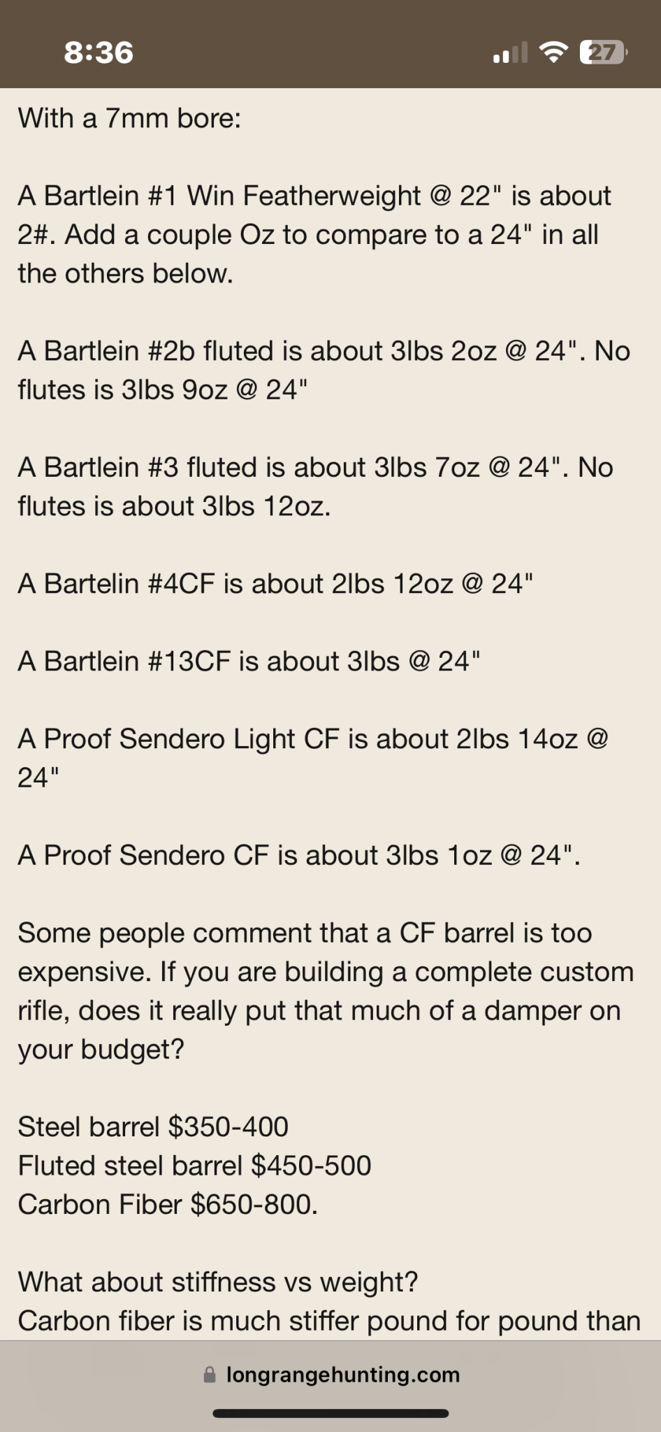

Looking to make sub-16lbs on a .308W build. I’m left with about 2lbs on the barrel (AI AX) and from other recommendations here, I inquired about a Bartlein 3B, which Southern Precision says is going to be too heavy. They recommended a 2B or 3, but dont have weights for a 16.5” prefit. Does anyone have these barrels or weights on hand?
In case my ramblings are tough to digest, I’m asking for:
-16.5” .308W #2B Bartlein barrel weight
-16.5” .308W #3 Bartlein barrel weight
-16.5” .308W #3B Bartlein barrel weight
I had a similar question and managed to screenshot these. Not exactly what you’re looking for but might get you close.
