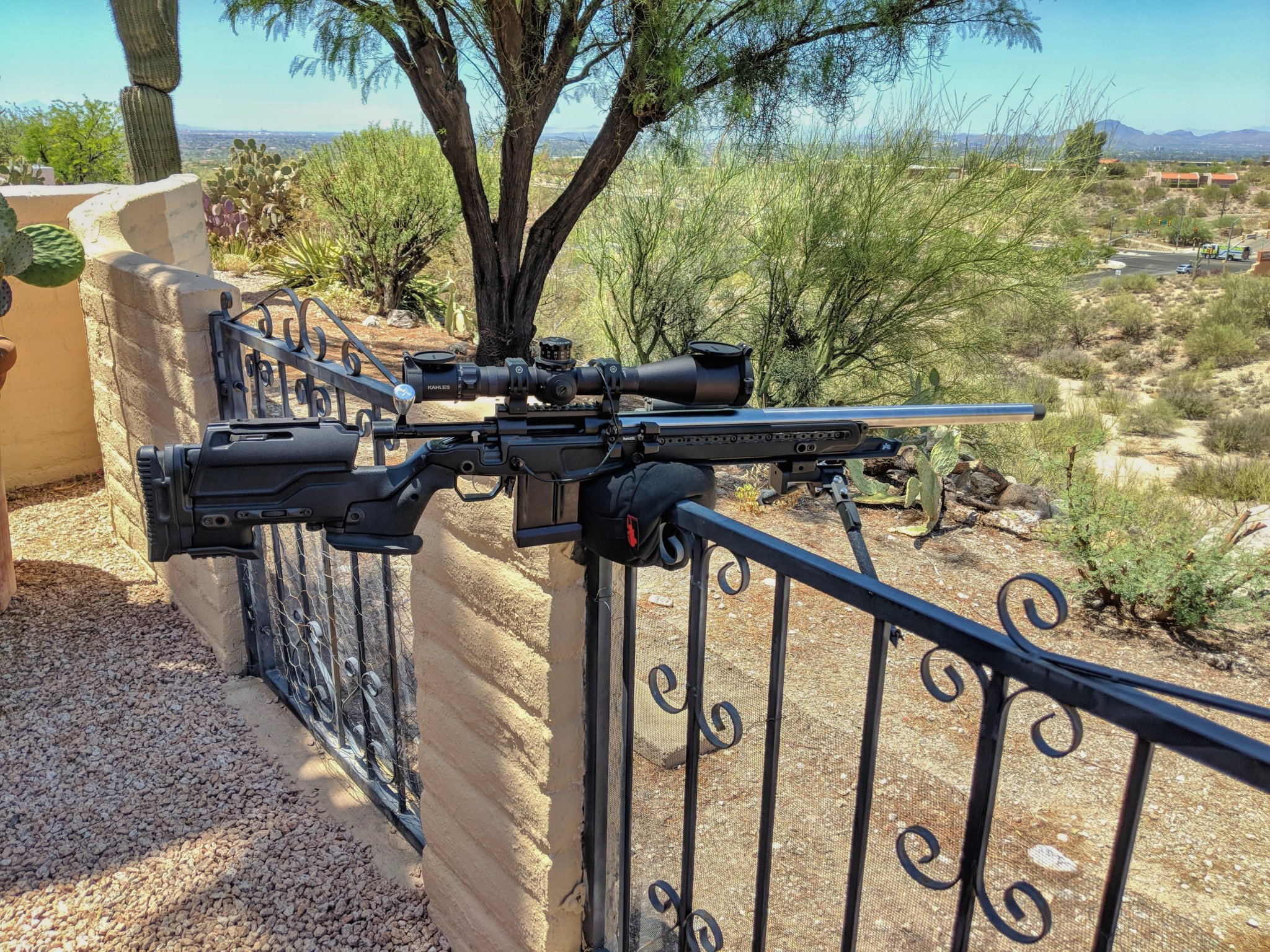

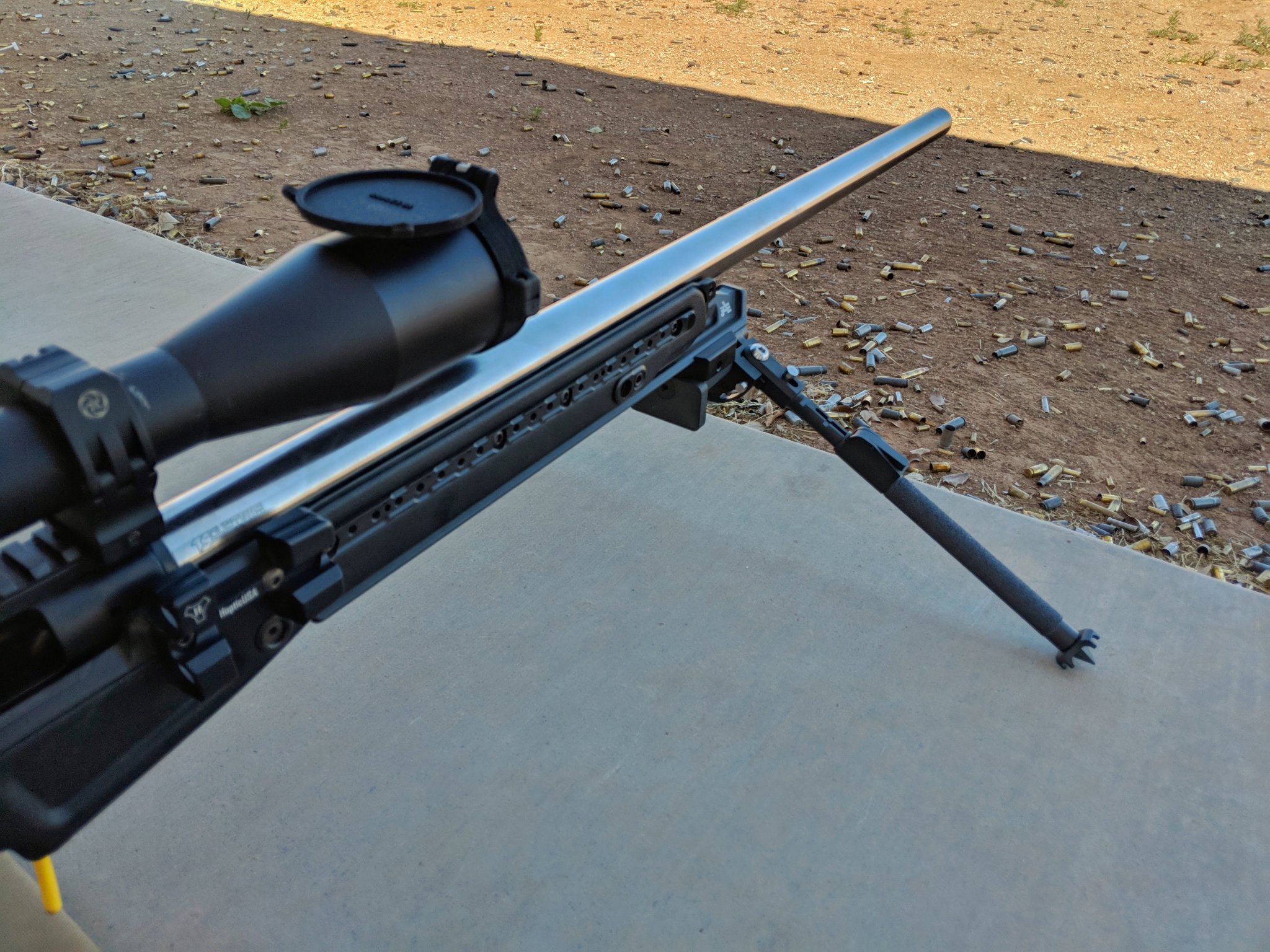

I have a M24 on my trainer 223 it works great stays cool and is a about lb lighter. I have a hv on my 6xc it is heavy and I don’t really like the taper about 1lb 1.5 heavier than the M24. I have the MTU on my 6.5 creedmoor I like it the best it’s about the same weight as the HV but I like the taper better could be because it’s on a tikka Action so starts out smaller. MTU pics

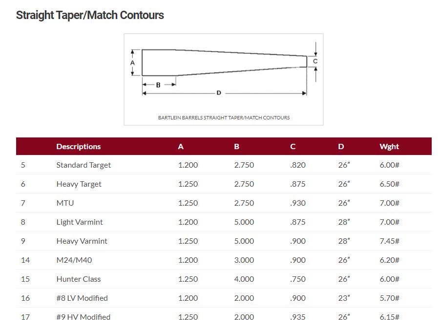

The biggest difference between the HV and M24 is the breech dia and blank length
If there was an M24 and HV of the same length side by side on the table you wouldn't be able to tell the difference without calipers
Listen to this ^^^. plus an HV will add over a lb of weight, if you plan on using a front rest(BR), the added weight will reduce muzzle hop.
Reactions: Cookieman8
All nearly the same.
Shank diameter on the mtu and HV will be 1.25 vs 1.20 for the m24.
Shank diameter on the HV is much longer than the other two (maintains the 1.25" diameter before it starts to taper for a longer time).
If you take a HV and cut the shank length down to MTU dimensions, they are pretty much the same barrel. I would pick whichever you can get your hands on quickest and cheapest.
Weight will go heaviest to lightest:
HV
MTU
M24
HV
MTU
M24
