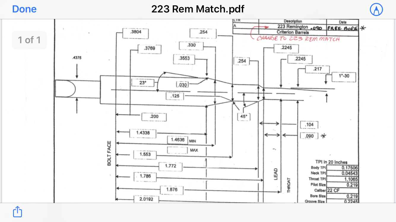

Thousands of range brass measured and 1.4635 to 1.4640 is the average.
I have never seen any fired brass close to that short.
Is it possible your tooling slipped in some way?
I have seen factory unfired rounds in the 1.455 range but none that were 18 thousands short.

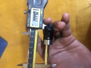

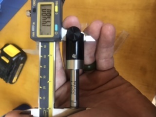

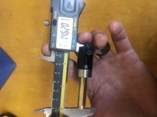

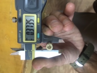

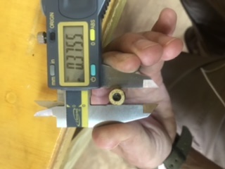

Alright got some pics for y’all fired brass is the stuff from above been deprimed and resized with shoulder bumped back 2thou. Virgin brass pics is same lot been chamfered/deburred ran a mandrel through it and threw it in the tumbler.
Base to shoulder fired
Virgin
No go guage
Case head virgin
Case head fired
Based on your case head expansion of .002, I would say it’s definitely over pressure. “Why” it’s over pressure still needs investigation. The headspace between virgin to fired seems pretty normal, so I don’t think that’s the issue.
EDIT to add: Check your fired necks to see if they're good to go by just slipping a bullet in and see if the case mouth is too tight. It's a simple test to at least eliminate a potential area. Until about 10 days ago, I would have never believed that neck thickness even from virgin brass could cause those kinds of swipe and pressure signs.
One thing just occurred to me..... is your chamber a .223, a Wylde or a 5.56 chamber? If it's a .223 only chamber and you're shooting factory 5.56 spec rounds or loading to 5.56 pressures - this could also be the root cause of your problems.
I just checked 5 new winchester cases all five were 1.457" and ten new Nosler cases that ranged from 1.4615- 1.462" and five new Lake City SS109 that ranged from 1.4595- 1.4605".
Your brass seems a bit short to as in out of spec short.
It looks like you are using a quality set of calipers, mine are Mititoyo 12" and a fair bit more rigid than the smaller ones.
You’re using a sinclair #23 insert right?
I wouldn’t worry about the base expansion. I’d worry if your die can’t take it down below chamber diameter and you get clickers. Until then don’t bother with it.
Isnt the headspace dimesnions the same on all three ( 223rem, 223wylde, 5.56x45) the variables being freebore and lead are different.

@spife7980 yes it is a #23 insert I’ll go ahead and load my once fired again before I screw up another box of virgin brass starting at 23 and see if I can run it back up to 25.5 without issues.
if that works I guess just got me room to fit a few more gr of Varget cheers 🍻
Interesting. My measurements from my #23 Sinclair insert are : 1.428" on a 1.464" 223 Rem. GO Gauge. Virgin factory loaded cartridges measure from 1.426"-1.427" on 5 different commercial and Military loaded rounds.
Fired cases from a Sig 516 5.56 NATO measure 1.434"- 1.437".
My #23 insert is from a very early mfg. Sinclair insert. Although my numbers are different, they are consistent for a comparator.
My Varget loads with a 77 Sierra top out from 24.0 grs. to 24.3 grs., depending on brass. If I go any higher, I stretch primer pockets. These are gas gun loads in a Wilde chamber.
Something just isnt adding up, your fired brass is measuring .014" over your no go gauge.
Are you measuring them with the spent primer removed ?
Yes sir no primer and I agree I do not fully understand what’s going on here but the second firings should give some more intel primer pockets gone, case head separation or something but should have some loaded up and shot by the weekend

That was my point as well, my measurements are consistent although longer but there will be variance based on the precise drill used to bore out and the chamfer on the insert.
But he is showing .014" longer than the measurement on his No-Go guage with the same insert,
That is not how you measure case head expansion for the purpose of determining pressure.
What he did is measured case expansion and .002” is normal as the chambers are typically bigger than virgin brass.
It has to be measured precisely at the web and very depth dependent for an accurate measurement with a blade mic.

Just got my reamer print and looks like brass grew exactly where it should’ve not sure why the Lapua was so far undersized or if it’s an issue with my comparator not touching at the correct spot. I’ll do some more testing with this thanks for the input.
