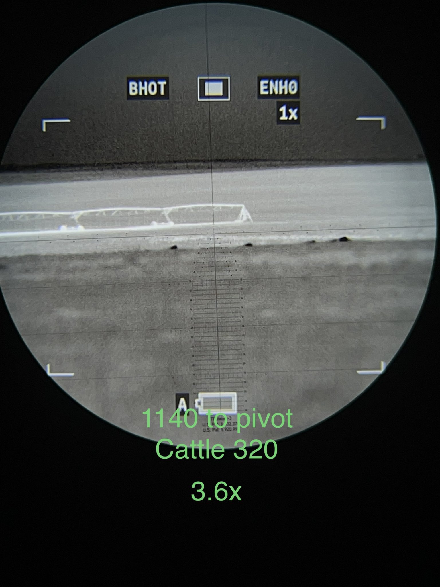

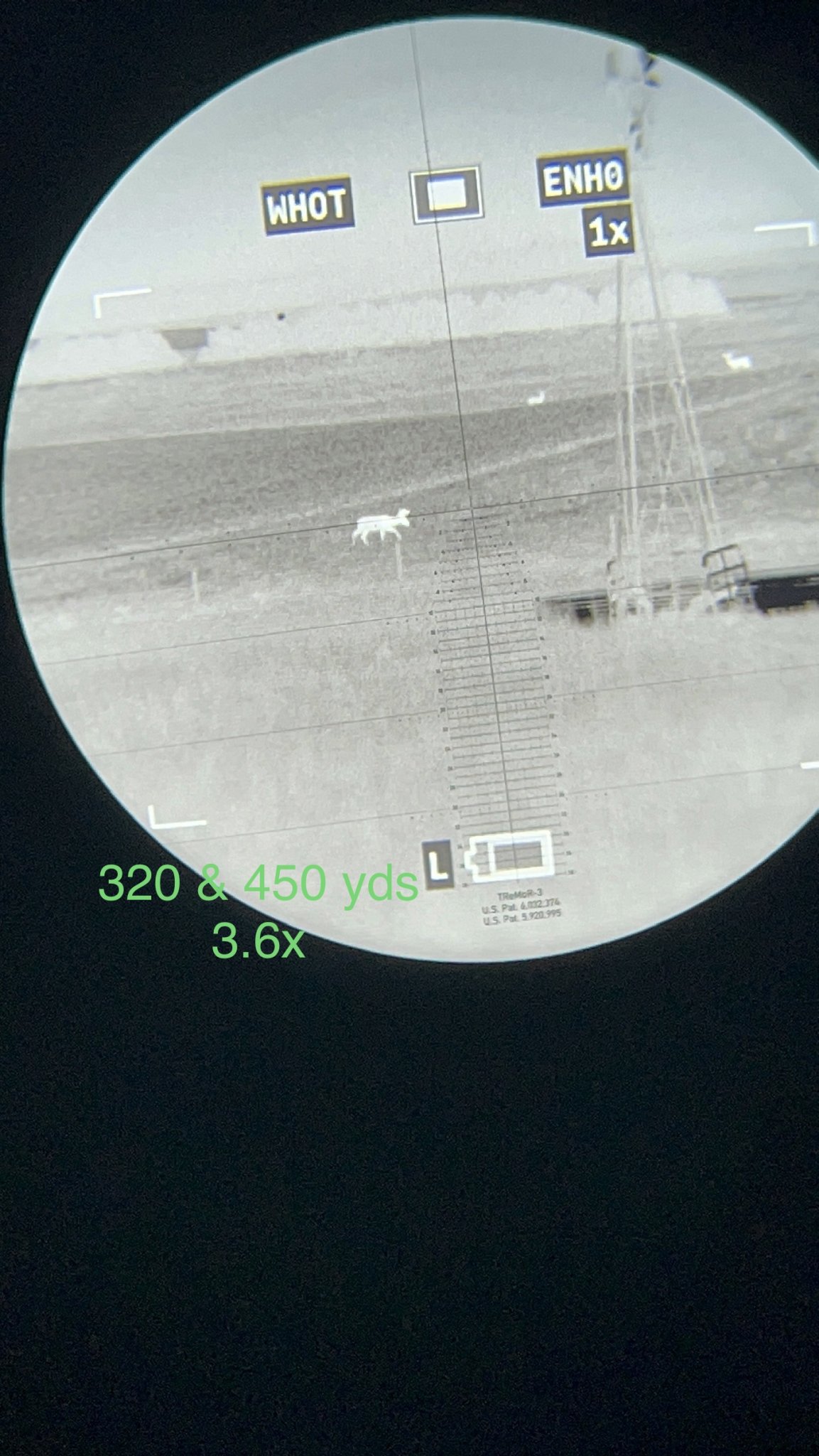

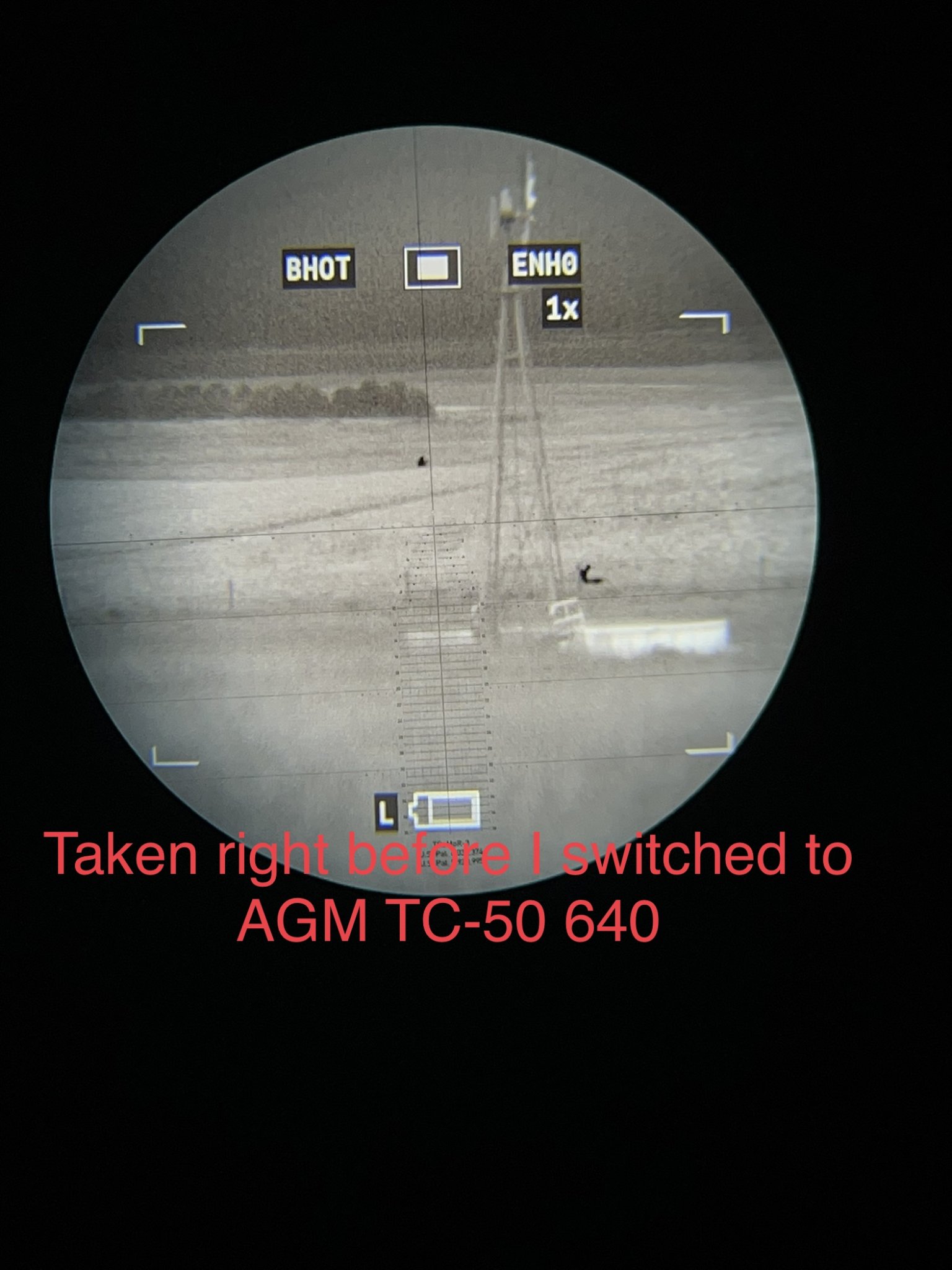

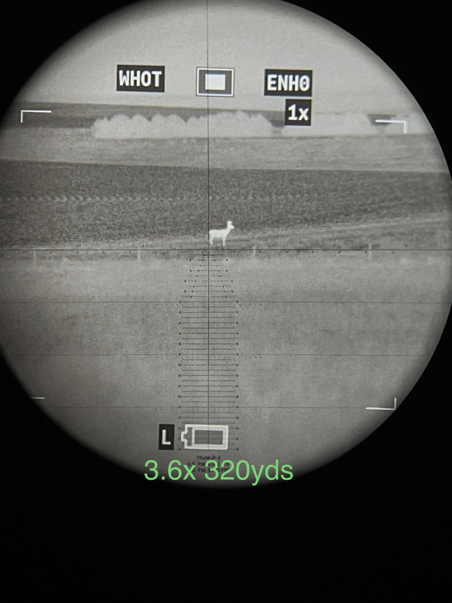

Here’s some pictures I took a couple years ago. Mk5 with t3. I’ve busted plenty of coyotes on 3.6 and if it was a longer shot I zoom to 5x. Eotech clipir LR
