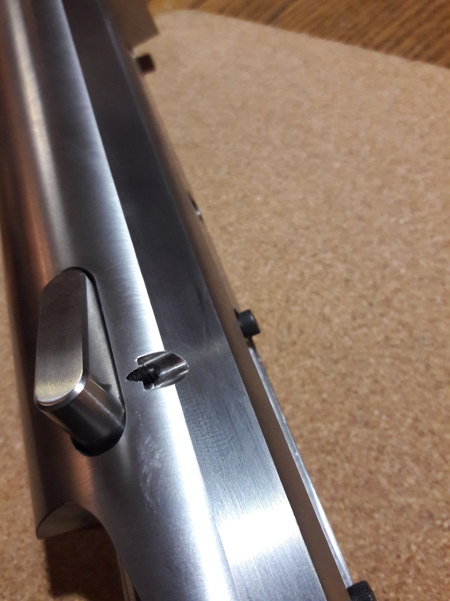

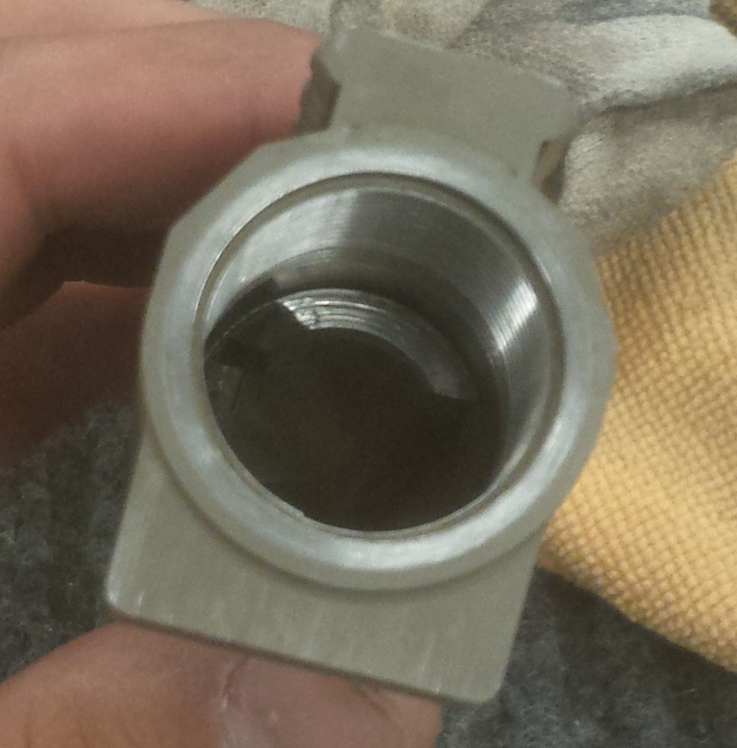

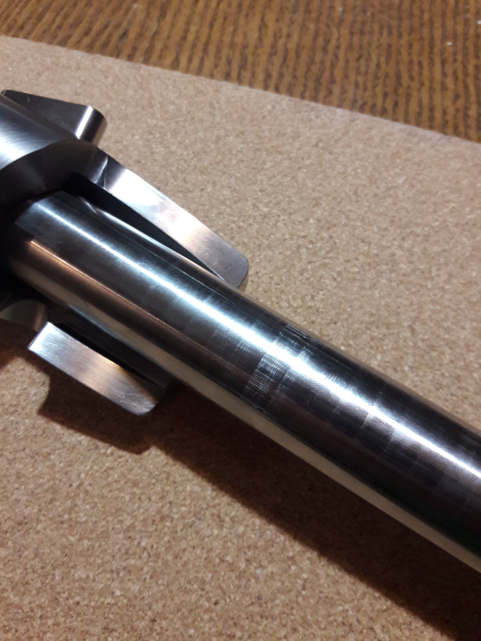

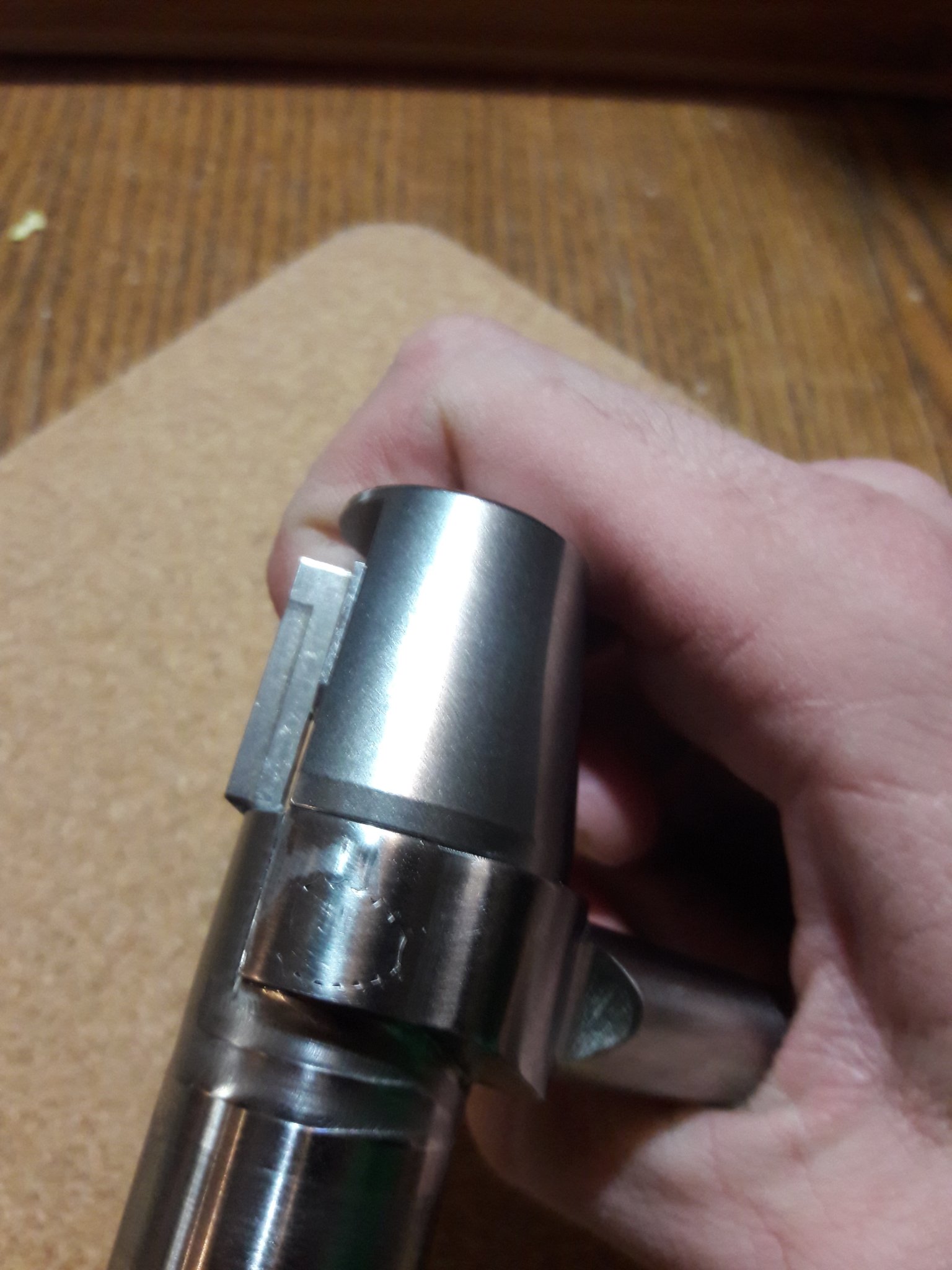

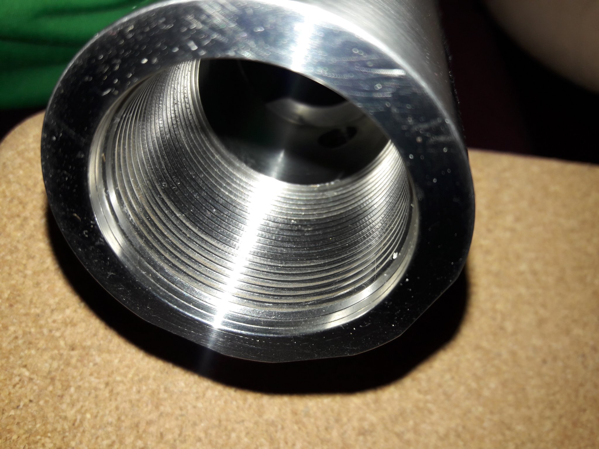

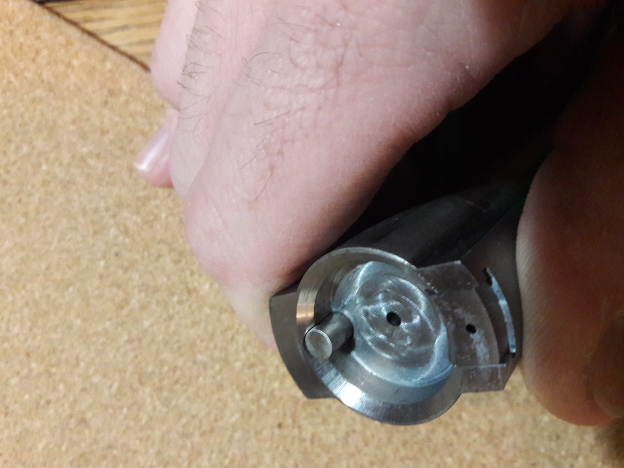

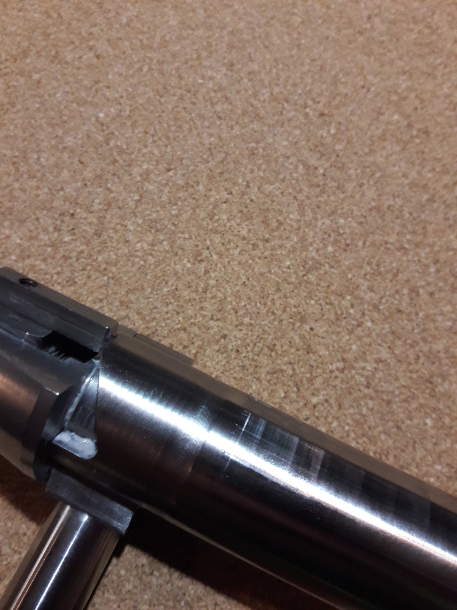

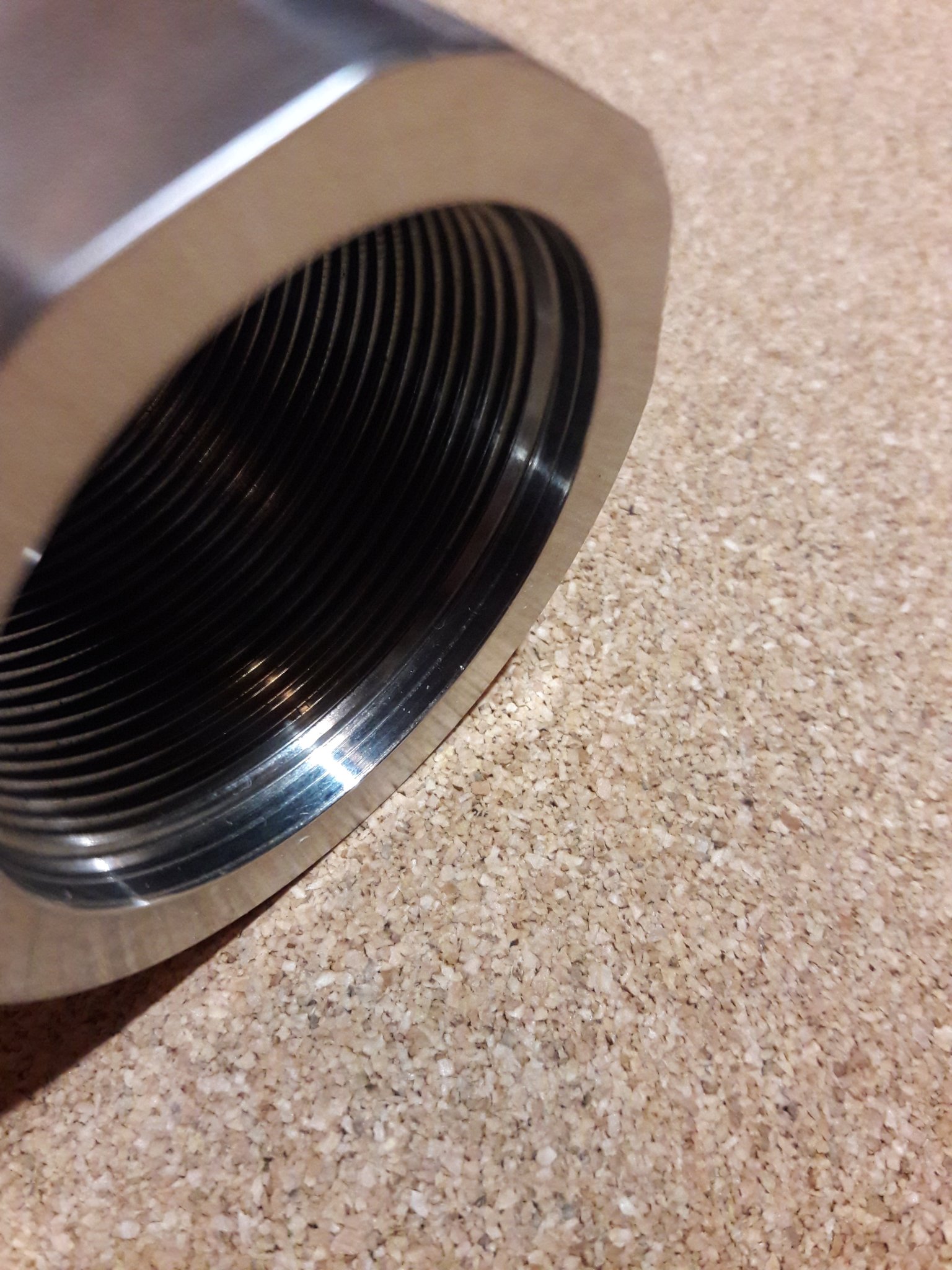

This Defiance had 1400-1500 rounds on it, came in for its first rebarrel.
I have serial number M5a400029 Mausingfield. To my best knowledge it's the first of the "for-consumer" production run Mausingfields (#28 was given to C. Dixon for evaluation, and I believe actions prior to that were given to other smiths for similar evaluation and/or testing). It's on its third barrel (6 comp match, .260, now 6.5 SAUM-- 4500+ rounds and counting, I'm sure others have more on theirs) and I have royally abused it. I have never specifically greased/lubed the lugs and have no signs whatsoever of galling.
The Serial #28 action that C. Dixon has, myself and Chad fired 600 6mm comp match fire-forming cases through bone dry into a sand trap and filled his shop with airborne dust in about 2 hours using a water-cooled barrel. No galling. Both myself and Chad ran several matches both super-lubed and bone dry purposefully not giving any care to the action throughout local PRS-style matches in wind/dust/etc... No galling.
You can say whatever you want about the M5 being a "new, unproven design" but you're full of shit. It's the latest evolution and the engineering pinnacle of the battle-proven M1898 Mauser design that has won praise and been copied all over this rock for the last 120 years.

This is a brand new $2600 EX action.
This is a SS action and is not QPQ'd. The quality of the fit and finish shown here has also been seen on the Tactical actions that have come thru.
If this action were to be FNC treated it would not change anything about the fit and finish except for the color. The action geometry, chattered thread flanks, and zippered feeling while running the bolt would still be there.
Well, here are the photos. Let's start with the chattered threads. Chattered tenon threads, improper thread relief, no thread truncation, rolled over lead thread. It shows even in the thumbnail but in a full size picture it's rather telling.
It's sticky feeling just sitting on the table with light grease on the surfaces. It also makes a zipper sound while being actuated. The bore does not appear to have been honed and the bolt body OD really does not appear to have been polished or burnished. If you listen at 16-18sec into the video you can hear the bolt doing a "stick slip" type motion.
I apologize for the video quality, most of my household is asleep... basically just myself and the dog are up still. I was trying not to clunk around too much and wake my 4 year old.
The bolt handle root end has a breakout and pits due to the cutoff threads. This picture also shows the undercut region where the bolt body has some poor quality machining areas around the PE cam.
The bolt release screw is tiny and still has breakout and poor engagement in the receiver body.
The bolt nose surface where the cartridge rides is rough and the endmill used to finish it clearly needed to be changed. The surface finish in the root here will catch a nail with you drag a finger across it.

The headspaces on the BAT Tacticals that have come through my shop have varied over the gauge band entirely, a dozen receivers was 4 thousandths. They all had the same tenon geometry with no cutouts, the thread flanks were chattered and some of them exhibited slight taper in the thread PD. Not as bad as some others on the market but it was quantifiable and I altered the programming variables for each barrel in order to most closely fit the threads in that particular action. v
I have not seen a QPQ'd action gall. My issue comes from the fit and finish on the Tacticals. It does not impress me at all and chattered tenon threads are unacceptable.
I never said that the Bat Tactical Actions are the finest thing on the market, just to be clear. I do think they are great actions and there is a difference on how smooth they run and and how they can shoot exceptionally well when the build is finished right.
I am shocked at the photo's. To be clear, that is not one of our Tactical Actions. You did not speak with Bruce at Bullet Central. Bruce is the owner of Bat Machine in Idaho and a really nice guy. If you spoke to the owner of bullet central, that is not Bruce A Thom of B.A.T. Machine.
The marks on the bolt body is new polished steel being rubbed back and forth. I'm not concerned with.
As for the Bolt handle weld and the bolt face. I have never seen a Bat Tactical Action come through that way. Never! It even lends me to question if someone worked on that actions handle and bolt face or galled the bolt face with a steel go gauge / no go gauge that was dirty (chips and oil). Or a tight and forced closed gauge. Maybe a stuck bolt that caused a broken handle and re-welded! I don't know, but that is not like any I have ever seen in my 12 years of working with and knowing Bat and Bat Actions.
