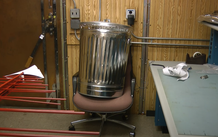

FWIW, removing batteries won't protect integrated circuits/computer boards. Again, FWIW, you can make a serviceable Faraday cage out of a small tin garbage can with lid and some metal tape. When I have cash for "spares" I will rotate kit in and out of such a store. Ya never know............

On the EMP discussion- the Faraday bags are nice, put that inside an ammo can and you'll have a lot smaller footprint than a garbage can. Save the garbage can for the larger stuff- your backup Inverter, bigger drones, etc.
