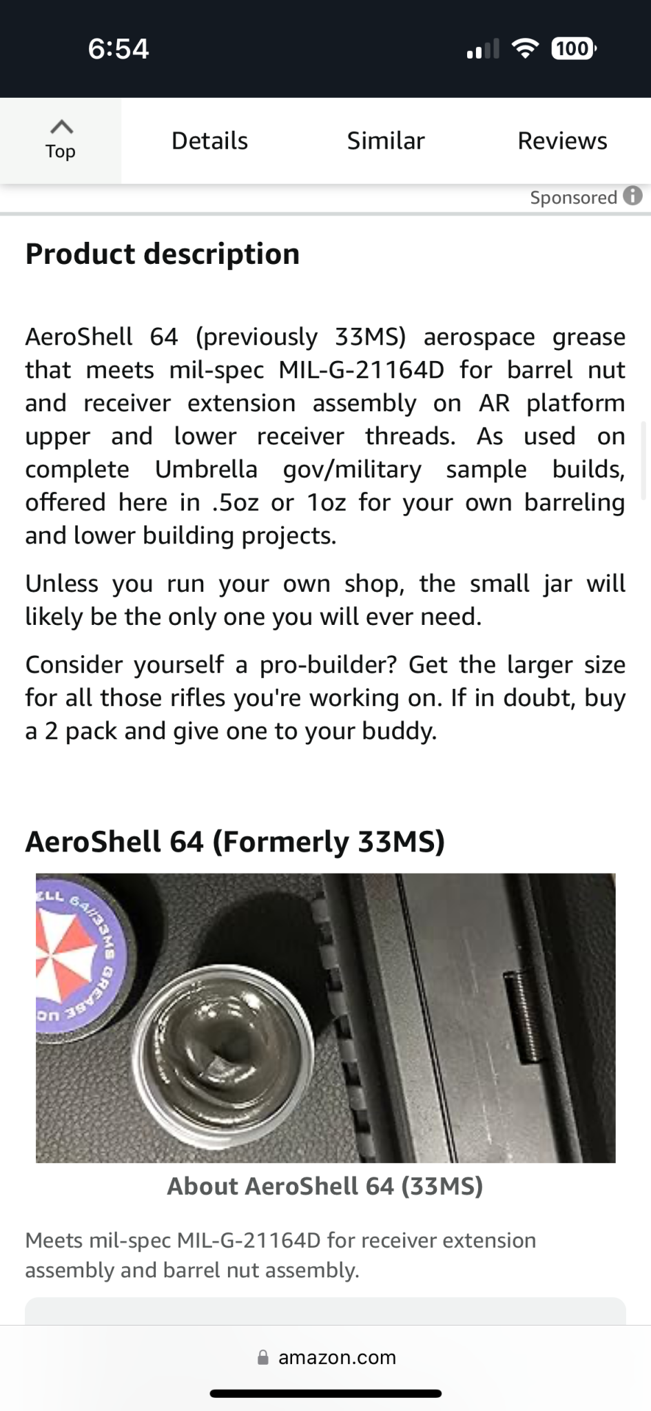

This, Arroshell 33, this is enough to last a lifetime:

I have used 3 of the top contenders... Aeroshell 33, TW25B, and Loc-Tite C5-A Copper Anti-Sieze. All worked great.
The C5-A can be a damn mess if you're not careful, just a heads-up, but it's also the highest temp rated. Works awesome for AR-15 barrel extensions and barrel nuts, especially if you have full-auto lower, or plan on doing mag-dumps and getting that barrel REALLY hot.
For bolt-actions, I primarily use TW25B, since it has a very silky texture, and wipes up and cleans up easily if you put too much on the barrel threads, or after removing the barrel to clean it up for storage. Very easy cleanup.
I primarily use Aeroshell 33 for a regular routine-maintenance grease for lubricating moving parts in guns. Works awesome for both bolt-actions, and AR's, especially on bolts and BCG's. Put it on liberally, cycle the bolts a few times, wipe off the excess off the bolt body, and you're good to go.
